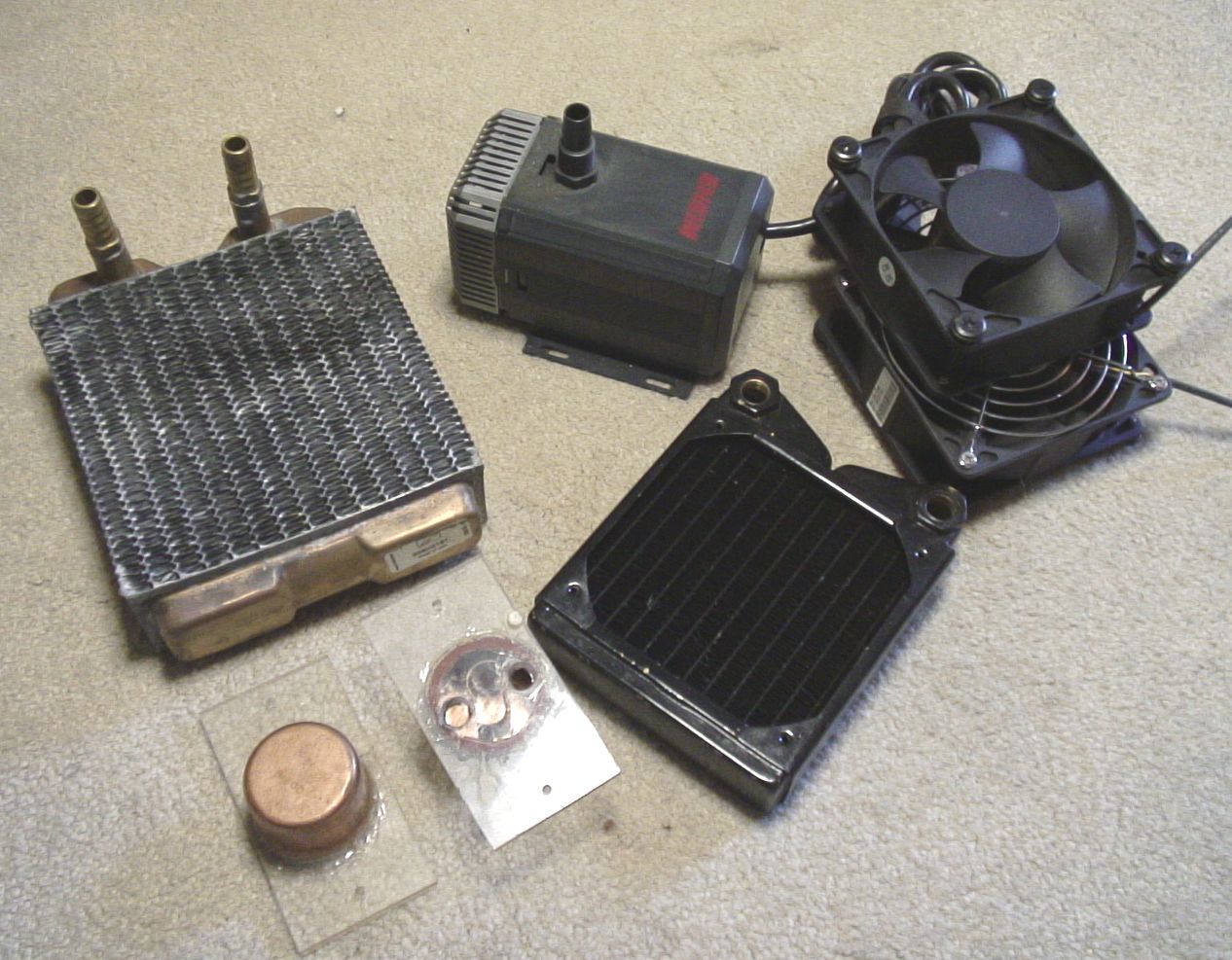

Well as you know, I'm all about what I hear. Since I have enough leftovers from a couple PC liquid cooling projects to build another rig, I am going to apply that same technique to a MyRef pair (probably the stock V1.2s). The pump has a wide range speed/flow adjustment that will allow everything from cool to almost no heat transfer at all.
I don't have too much of a concern about the amps stability as related to heat, but I dying to find out if I can hear a difference or notice a performance change at various settings. I will contact you directly when I get the system built.😱

Metal, I cheated a bit and you caught me. What is shown in the pic is well oversized and will only be used for the base experiment, That stuff is on a 120 cm fan base/standard. If there is a sensible advantage everything would be downsized possibly all the way to 60 cm. I have built some coolers that can't be heard 3 feet away. Wont know if it's even worth the effort till I play around a bit. These pumps are virtually silent.
And no, even though I know how to use it, I'm not going to try liquid nitrogen. 😉

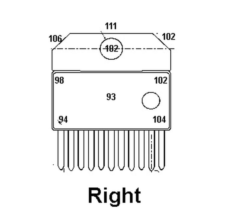

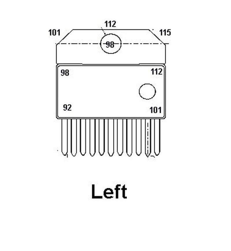

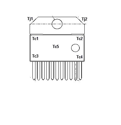

Ok Andrew - Talk to me 😀 This is 82 db at 12 feet
Ta Temperature Ambient
Tc Case Temperature
Tj Junction Temperature

Those temps on the tabs are good guides to the TC of the chip.
These are quite low @ 111°F to 115°F.
The markings on the left diagram are wrong.
The TC are plastic case surface temperatures. They have no close relationship to Tc.
The Tj are tab temperatures. Thes are close to Tc, certainly not Tj which is the junction temperature of the chip, buried way inside the device.
