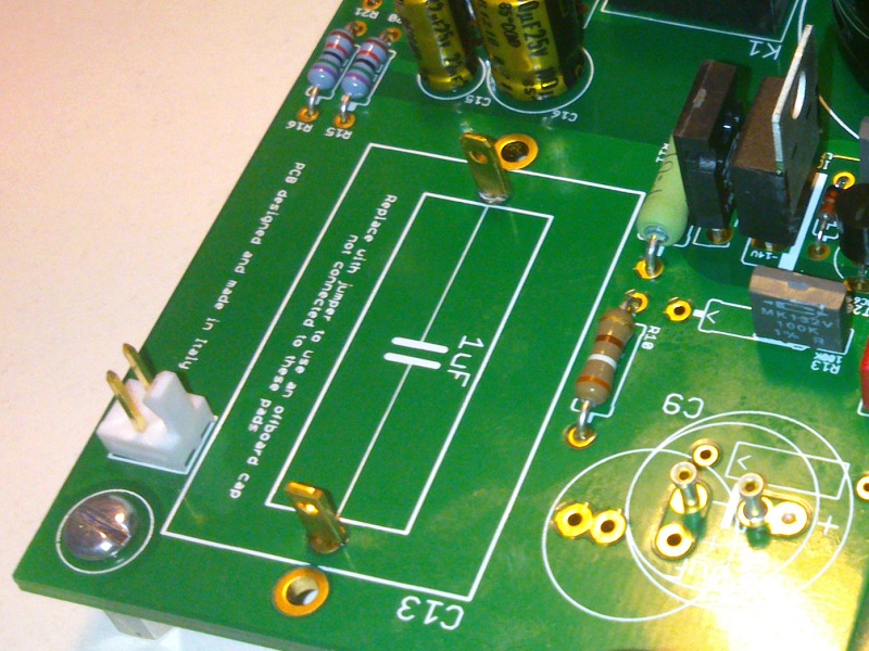

For you guys that have used these sockets before, what do you do when the leads are too thick? My thought was to file down a short section of lead to fit. Open for ideas. I am hoping to socket and compare C9 and C13
Hi Jac,
as Bob already pointed out using a file you can do it.
But for bigger leads (like C13 ones) PCB mount faston tabs (Mouser 571-63756-1) are a better choice than sockets:
attachment.php

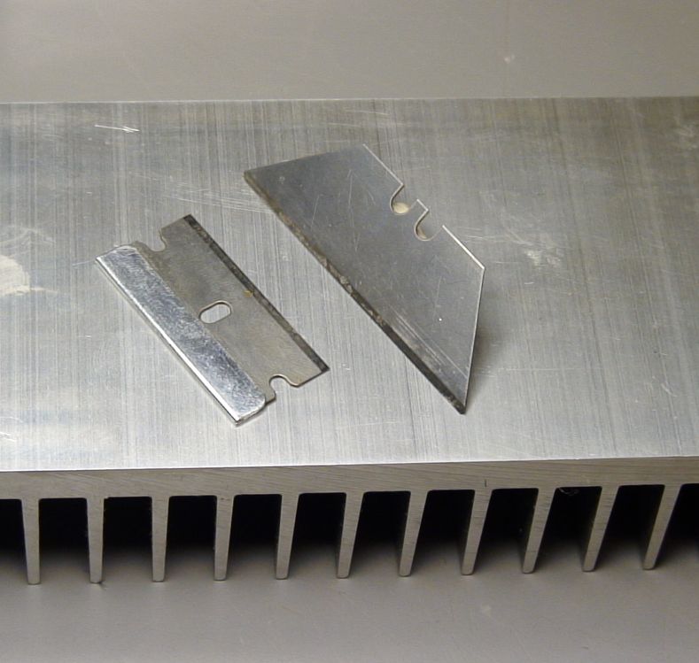

My Myref FE RC is singing from few hours already. First thing noticed is that the all 4 LM317's are running hot and i think a smal heatsink would be good.
Also my LM3886 are running a bit hot but this is because my heatsink from Banzai Music is not flat enough and the contact surface is not perfect flat. I was thinking to put some aluminium foil between IC and heatsink because the thermal paste is not enough.

Don't know if you want to go through the hassle, but there is a fairly simple way to flatten the heat sink. You need a flat surface that can be anything from a piece of granite, marble, ceramic tile or even thick glassiness. A few sheets of wet-dry sandpaper attached with thin double sided carpet or carpenters tape. The grits should range from ~ 120 - 1600.
Draw a bunch of squiggly lines on the heat sink and do a few passes on the dry sandpaper to identify the high spots. If the surface is really bad, lay a file on the bench/table and draw the part across it to get close. Then add water and work up through the grits. You should be able to get to a point where scraping the surface with the blade of a utility knife produces a full width impression. You now have a flat surface. If your heat sink is very large just using the blade as a scraper on the LM3886 contact area can be very effective.
It is not a one time system as the same setup can be used to create a great brushed satin finish chassis parts. In that case you draw the part across the sandpaper in only one direction.
