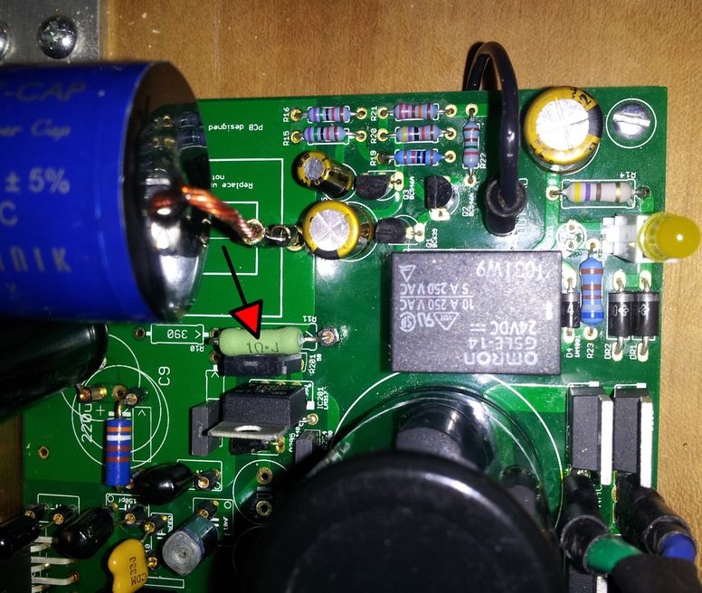

Sorry Guys but this part of the tutorial is WRONG.
The correct R11 orientation is this one:
It seems I must be sorry of being sorry...
After further experimenting I now think that the tutorial original orientation is the best one.
This is just a warning that things can change, I'm waiting Bob's confirmation on this.
Builders that have working amps could experiment and report, any opinion is welcome and appreciated.
R-11 Review.
Another big surprise. Reversing the resistor reduces the heft of the sound but the advantage gained in clarity and stage is well worth the trade-off, from what I'm hearing. The stage is the most impressive as it is improved both in width and specially depth. Much more of the in room 3D ambiance comes through. I hear a significant addition of space between the instruments and a better focus of voices - both solo and group. I would call the build guide position as stronger, but muddy in comparison to reversing the orientation. I haven't tried any heavy classical music yet but will do so this week. These results were based on the original test mix I did on the beta thread.
I would call the build guide position as stronger, but muddy in comparison to reversing the orientation..
These are signs that the wrong direction is used, IMHO.
In some aspects the 'wrong' direction could be be charming (3D soundstage, extreme focus, rock solid bass) but as time passes listenting fatigue, thin sound, hardness and harsness become unbearable.
All my directions selections followed such rule, the right direction is the less open/aggressive, fuller with less controlled bass.
It seems counterintuitive but it gave me best results.
There have been enough swaps and substitutions by me that I honestly can't zero in on an exact comparison between the beta and RC PCBs. In general I would claim the RC produces a cleaner or softer sound.
Yes, I think it's so and most of the improvement is due to SMD Susumus and their orientation, IMHO.
A little detail on the R-11 dialog may be in order here. Several weeks ago Dario asked me to test the reverse orientation. He did it like a blindfold test by not giving a hint of what to expect. He first saw the impressions from the audition in my post along with everyone else. What we heard individually was remarkably similar. Whether those changes in the sound are beneficial over time, ex. ear fatigue, require more listening on my part.
IMO, the big take-away here is the continued validation of the orientation of components being almost as important as the selection of value and brand.
