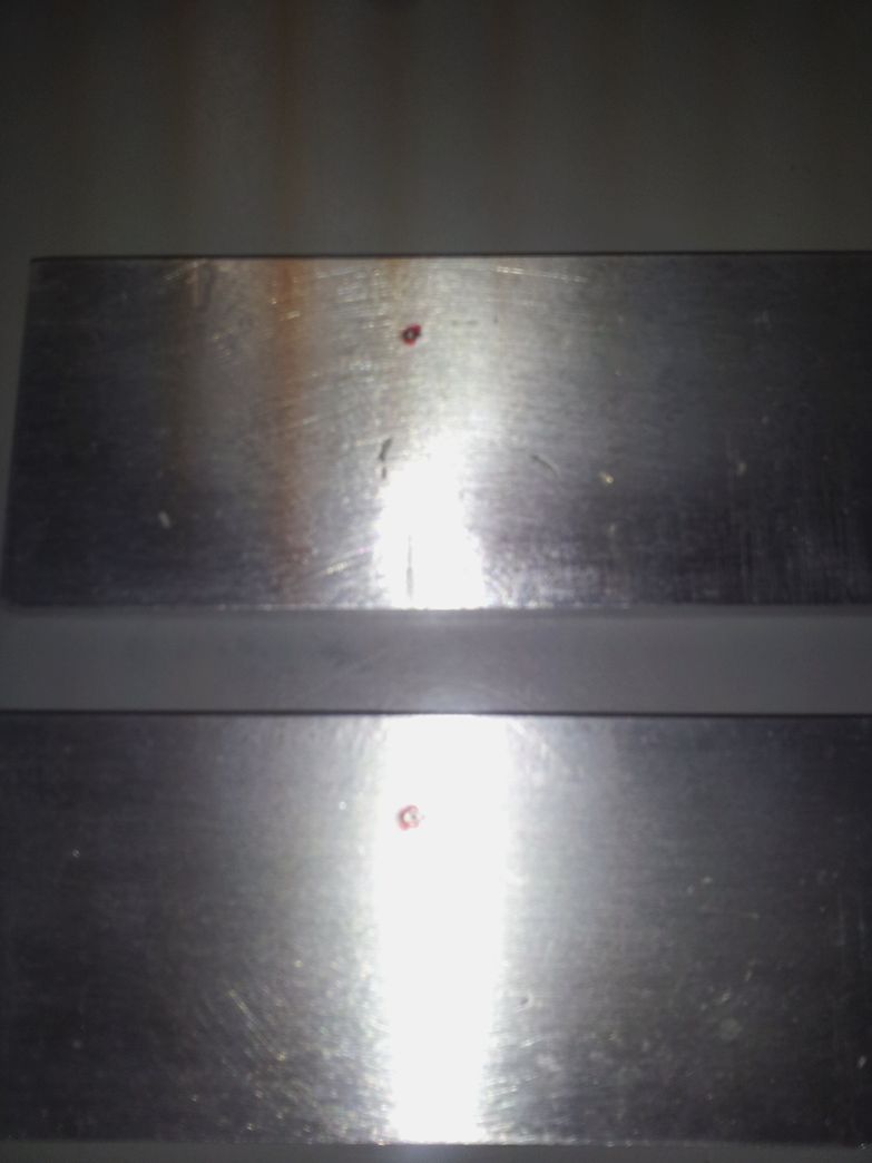

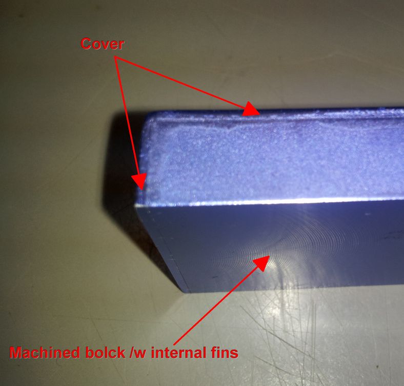

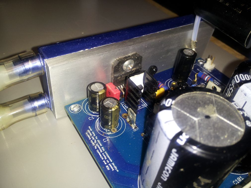

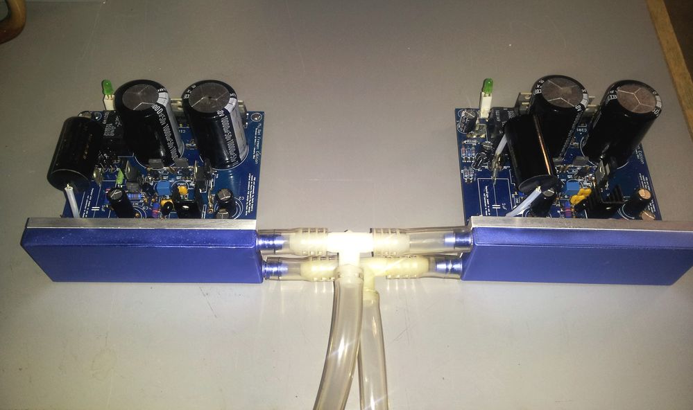

Just Fo The Fun of It - maybe something like this 🙄
1. Sealed cooler with internal fins.
2. Heat transfer tape. Leftover from piece bought years ago for computer projects.
3. Aluminum block for chip mounting.
4. Nylon tee.
5. Vinyl tubing.

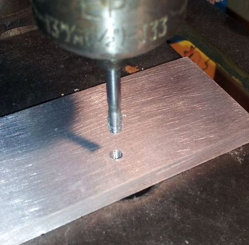

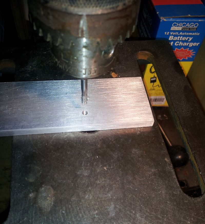

Used the footprint method to locate mounting screw location. Jut put a little paste (Machinists us bluing) on the chip (with standoffs attached) and pressed it against the HS. Should have thought of that sooner.
For deep threads I ground off the starting taper on a regular tap. Using a drill press assures a 90 degree hole

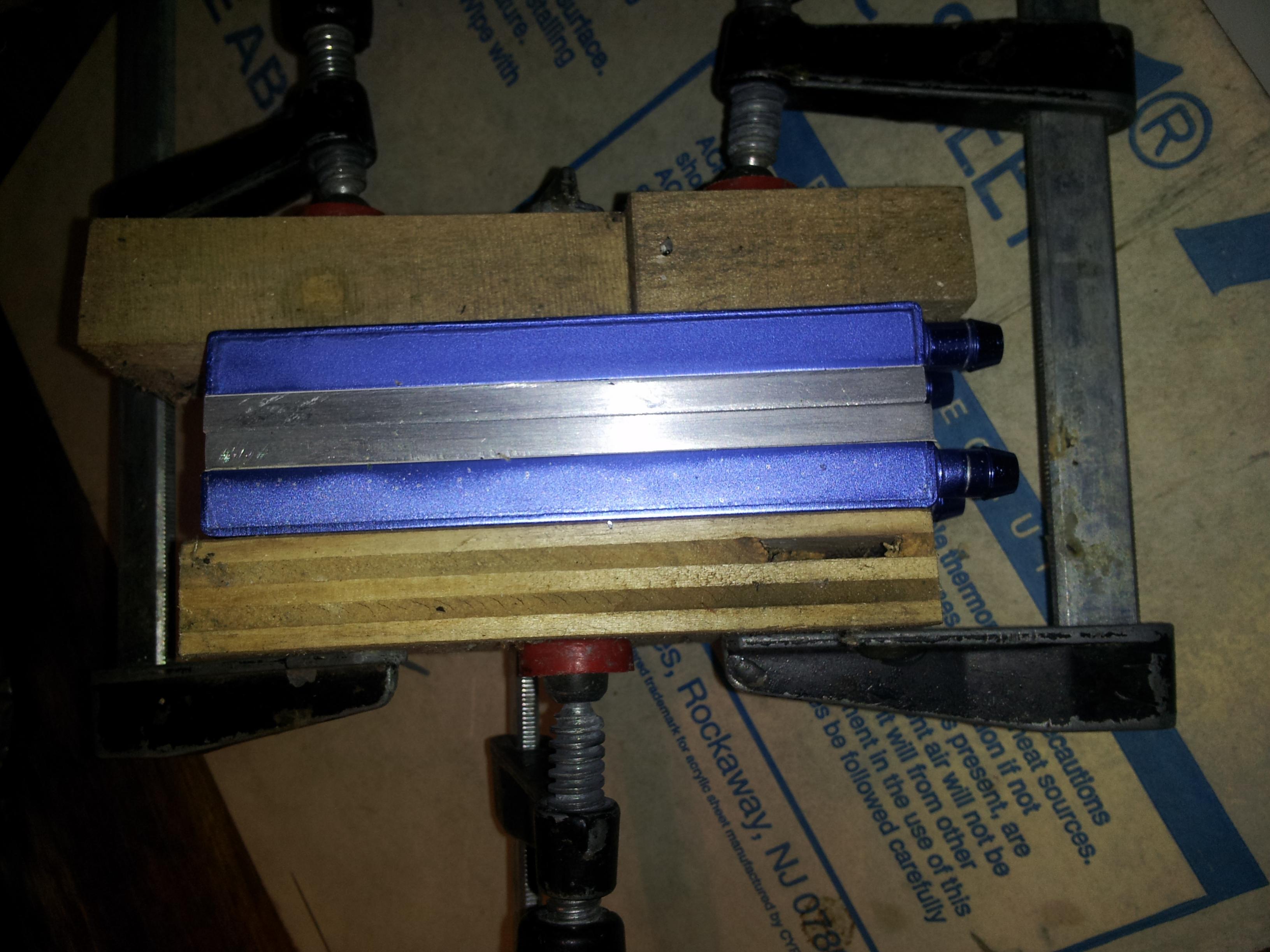

Messed up the tape lay (its stretchy without membrane covers) on one but the otter was perfect. Clamped overnight for best bond possible.
Hope to be hearing some "Cool Sounds" by the weekend. 😀🙄😀🙄

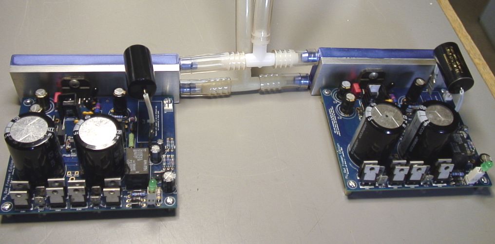

OK you guys. Go ahead and ignore me if that makes you feel good. But when the entire industry adopts the "Bomac Liquid Audio" format for audiophile listening, I won't be bitter that I got zero support from the FE thread members.
That's how you wanna be? So just go on with your own fine selves. I WILL wipe away the tears and carry on as best I can.:rain:
Bob, dry your tears....I know I was waiting for more info on your plans for your system. Like what are you using to pump fluid? Reservoir? And what about mono blocks? Are they going to share a pump and reservoir? If one circulates better than the other then one may polute the other with heat. What about this?
I already tested Nichicon Muse BP (non polarized) and it lacks details.
And dark sounding too...not my cup of tea...
For sure it's a cool project... don't give up! 😉
Liquid cross-talk?

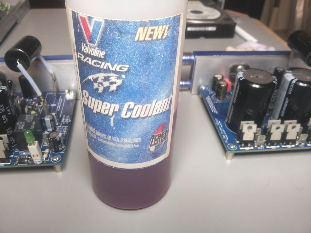

Maybe I missed it. Have you said what liquid you will use? Often in electric transformers, they use oil. I have also seen an electric car motor that was cooled by oil. The advantage is that oil is less electrically conductive in the case of a leak.
In the theme of the BLAT, maybe a nice light olive oil. Tastes good.
On another subject, I know you are in pursuit of excellence in audio and that you have had a little hum. I was reading Peter Daniels in another thread. He was talking about using a TVC as a pre-amp. It took a little finding, but a TVC is a transformer volume control. Said to be excellent for sound and hum. Naturally, the price is higher than the JC-3. Anyway, follow the address below to read a bit more about it.
SOWTER ATTENUATOR TRANSFORMERS TVC VOLUME CONTROL
Jac
I did a little study back when I started and settled on 95% distilled water (no or low conductivity) and a pro coolant at 5%. Has worked well in one computer for close to seven years - with a flush and replacement every two. I'll look into oil and the other references you have given.
