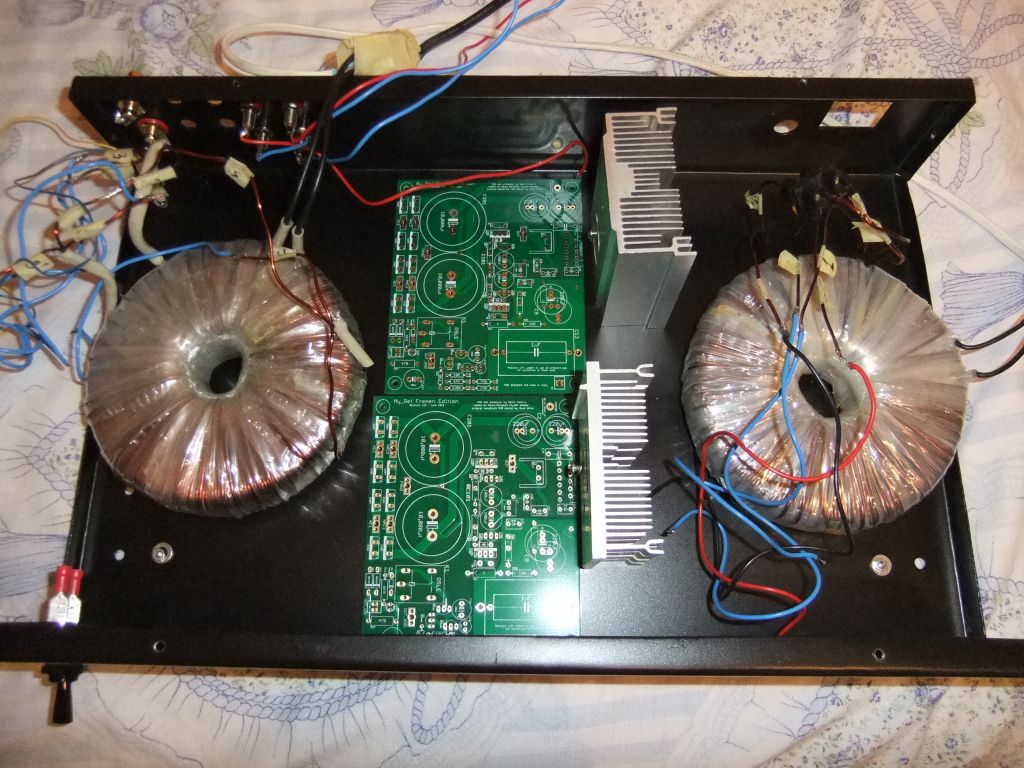

My heatsinks arrived from heatsink usa yesterday, so now I have almost everything I need to build a working amp! But......I am a little behind on my pre amp build and want to finish it before I get under way on the FE. I also just bought a house so we will be moving at some point in the near future, but fear not I will get started soon.

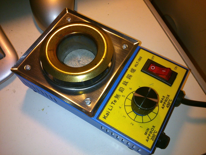

Solder pot is needed
Hi Bob,
for Audyn True Copper caps a solder pot is needed to trim and tin leads ends
I've buyed one for this reason at very reasonable price on eBay.

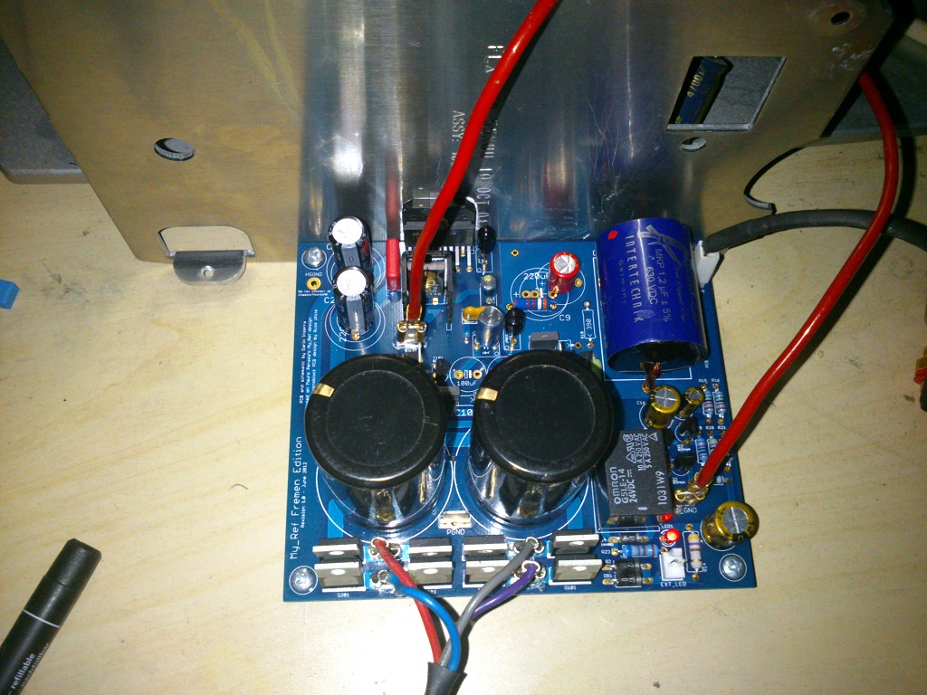

Now I've a semi-definitive build:
Hi Bob,
Well finally - we used one with the Bomac Tower project more than 20 years ago and it's been in storage ever since. I knew this day would come.
Can you give a deeper description of why it is needed. I did trim mine about half way (they still stand off the board) but I just soldered them to the fastons.
It's needed because True Copper's leads are litz cables (each conductor is individually insulated) so, after trimming to the right lenght, they should be tinned with the solder pot.
It's the only 'clean' way to remove insulation.
Is it recommended to use a solvent or is simply scraping enough? We only used bare wire. Is there enough heat to melt off the coating?
IMHO, you can't simply solder them without the solder pot...
To burn the insulation you'll need circa 400°C and you should do it for each individual wire... a PITA... and with no guarantee of success.
Since you're going to organize a small GB for TCs I would add to the costs to be shared a cheap solder pot like the one I've linked.

The leads, trimmed to the right lenght, are circa 2cm.
It's possible to solder litz wire with a simple soldering iron as we can see on this video but, IMHO it would overheat the capacitor.
Even using the pot, set at circa 400°C with an immersion time of circa 4-5 seconds the cap heated a lot.
