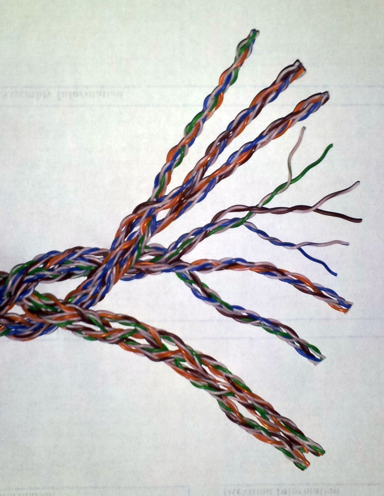

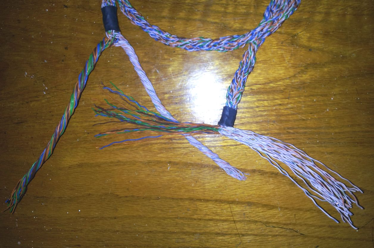

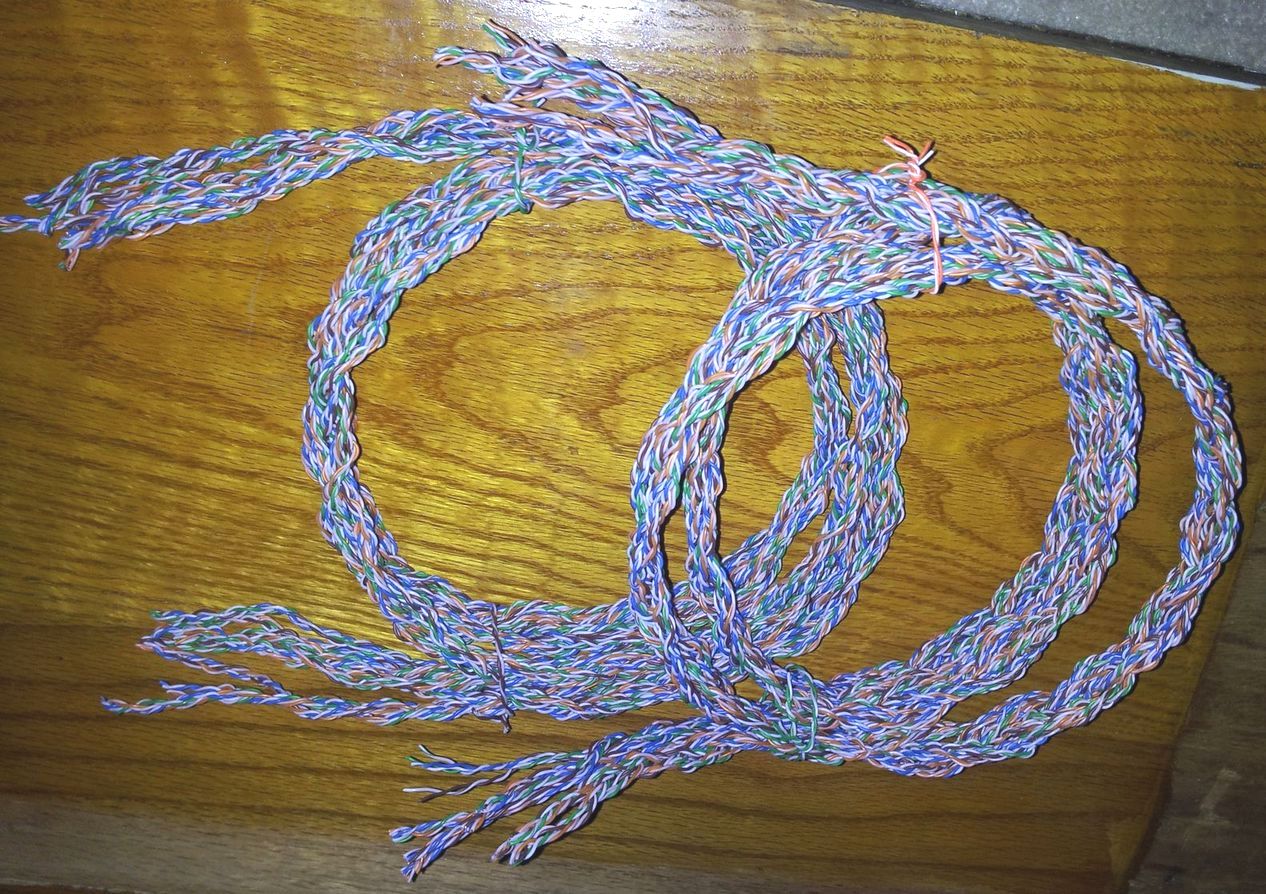

The cost is low and the time necessary is mostly free, so I spent the better part of three days this week twisting wires and fingers. IMO, it was well worth the effort. The biggest impressions are an enhanced 3D effect and very clear , defined and controlled bass. Lots of slam when it is called for.
I won't hijack the thread but will add a link to the post on the speaker thread when I get it there.

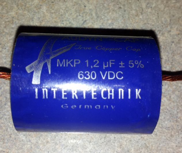

Regarding litz leads of True Copper's: I used fine sandpaper to remove the insulation from the end of each individual litz wire after untwisting the ends. Took about 30 minutes per cap. Soldered just fine after that. Even with short leads, there was very little or no heat to the cap. I'd be very careful with these.
What proved to be a bigger concern for me was fitting the huge wires into PCB holes. I added a very short pigtail of fine gauge OCC solid copper to the lead. I hate adding another connection, but I had no choice, other than cutting a couple of the litz wires to make the lead smaller. I'm not sure what effect that would have.
I guess these caps are built for crossover duty, not coupling. We may be pioneers!

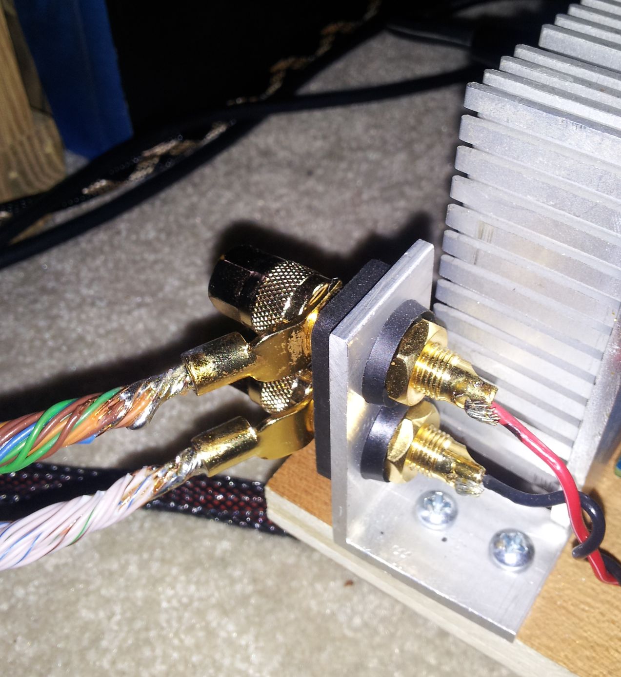

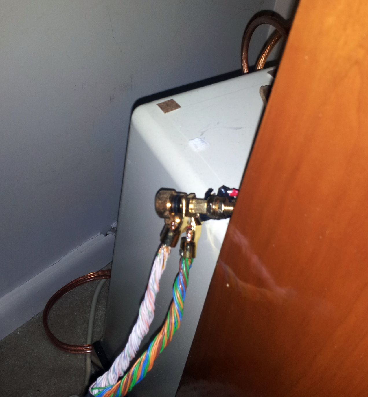

Those speaker cables are insane. Do us all a favor and insulate the spade lugs before two accidentally touch and ruin your amp.

The cable photos show a temporary setup - done with caution. I have two versions of the Sunflower crossover. I'm using the original because the revised new one doesn't yet produce the correct timbre in the high spectrum where jazz trumpets are heard. I am in a dialog with Ken at Sonicraft in pursuit of a solution. His suggestion (guaranteed he says) is substituting some Jupiter Vintage Flat Stack caps - the total for my needs approaching $400. To my surprise, moving from a toroid to an R-core in my Mini 2496 DAC build produced the best trumpet sound I have heard. (BTW: the XO eventually will be mounted inside the woofer cabinet using a bi-amp capable plate. Humm - Maybe 4 EFs ??? )

P.S. The ends of the speaker cable are temporary. You can see the barrel at the amp end is too small to fit over the bundle of wires and have to be replaced. Had to solder the bundle and file down to what would fit - kind of like your problem fitting the TC leads. I also ran out of high quality solder. When I get what I need the ends will be redone with insulation and the entire cable covered with nylon mesh. Additionally, on the other extreme, last weekend I tried some "Euro Style" single strand Radio Shack 30 ga magnet wire for cables with surprisingly good results from mids up. Really impressive stage and definition.
