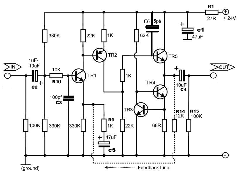

I tried to remove the sharpness of the high frequencies, putting on the input of the amplifier - a tube preamplifier, which was supposed to make the sound "warm" or just another ...
But the presentation of the sound has not changed - the bright accent of the sound of the NAP amplifier continued to be felt. Only after switching on the NAC preamplifier in the amplification circuit, the familiar NAIM sound returned without irritation.
I’m not afraid to say that only five additional transistors (the amplifying part of the preamplifier circuit) connected to the input of the NAP power amplifier constitute the very magic of the NAIM sound.
In the circuit of the preamplifier itself, a large role in the final result will be provided by a capacitor in the 47 MkF feedback circuit. Which I advise you to choose for your hearing preferences.
In the complete set, the NAIM sound may well compete with the tube amplifier, which is famous for the absence of any unpleasant sensations for your ears.

A positive effect is obtained from the amplifier cascade. Cascade frequency filter - this effect does not produce.
At the local forum of fans of the company NAIM, I also met exactly the same opinion when the owner of the equipment tried to exclude from the path the amplifying part of the circuit - the "brightness" remained in the sound.
The amplifying part of the circuit works on this positive effect. Although the gain itself, especially in our time, when most signal sources have a level of at least 2V RMS - and it seems absurd.

A 12K negative feedback circuit can be reduced to 5.1K. A further decrease may lead to an increase in distortion. This information is from those who tried to reduce the gain. In my version used the standard denomination.
The convenience of adjusting the volume is obtained by connecting a resistor in series with a volume control (in the upper arm of the divider).
Perhaps this is not the most optimal solution, since the input circuit is obtained with increased resistance (75K + 50K DACT). Possible increase in noise at the entrance.
An interesting feature of the early NAC preamps is the 24VDC supply used for all of them, based on a standard 7824 regulator circuit. That simple supply was later outmoded by the introduction of SNAPS external power supplies at unbelievable extra cost and complexity, considering how much improvement was really worthwhile and and that it could easily have been incorporated in most existing models. That's where the "backwards compatibility" concept went haywire, I think. Now we have people designing and selling "super regs" and boards with multistage circuits that allegedly turn the Naim and Avondale clone preamps into amazing sounding devices. I can only wonder how bad the noise and regulation in the DC supply must be to need such extreme levels of regulation and filtering or maybe its really about impressing people with specifications and letting the numbers do the convincing.
We can improve the linearity of discrete circuits with higher supply voltages like 30V, 48V or +/-15V but a single 24V regulated supply isn't too bad for small signal levels and is easier to implement. Another advantage is that you can use up those low voltage, low noise transistors you've had lying around for years - I have lots of them that I've collected over many years but they're obsolete and otherwise have few uses.
There are lots of suitable low voltage, low noise types but I'm thinking of all those inexpensive BC549C/559C transistors that are still widely available and many of us will have stored away somewhere.
