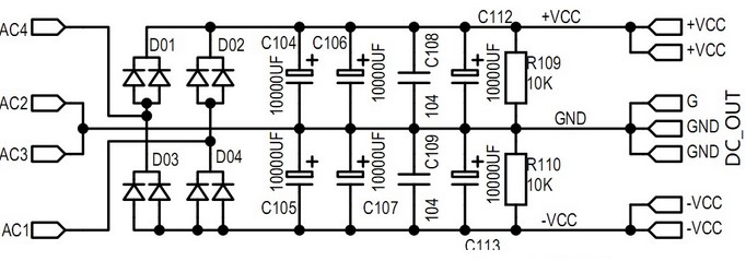

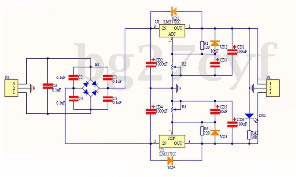

I agree fully and with absolute conviction on the fundamental importance of the stage of power supply, at least equal to that of the amplification stage, here are those that after several attempts and experiments I have implemented on my clone NAIM:
A) Dual low impedance linear power supply with four double fast rectification diodes for the Driver stage and BJT's Power stage:
B) Adjustable dual stabilized power supply for Differential input stage and VAS stage:
The power transformer is a 600 VA with 30-0-30 Vac outputs and 10 Amperes of current on each power rail, selected and sized according to the SOA - Safety Operating Area of the BJT's of power 2SC5200.
The important main advantage of a separate power supply for the Differential and VAS stages, regardless of its type, is the separation from the large variations in current and voltage that occur in the power stages, making it "cleaner".
So linear, stabilized or even inductive and C-L-C as I intend to experiment in the future, can be fine and it becomes interesting to evaluate the results on the basis of personal musical tastes.
But it's very important, always distinct and separate.

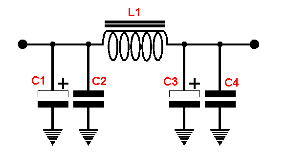

it's one of the things I wanted to try on this circuit someday.

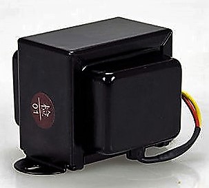

I got two coils of very good quality, one of 1.8ohm 40mH and the other of 2.9ohm 47mH for this project.
there is no time, i reconditioned two plinius ma102 and when i saw how was mounted the power supply, i had a revelation.
1 power transformer by polarity
2 stages of voltage by power transformer
and a coil on each polarity on the supply reserved to the stage ampli in tension, inverter, drivers.

I have been using for many years the CLC filtering solution in the construction of my tube preamps with enormous satisfaction in terms of musicality that compared to the stabilized solution, zeroes any form of feeeback in dynamic mode of operation, in the power supply of the delicate stage of preamplification.
And as already said in my previous posts, it is no coincidence that I am going to try this solution in the future for the differential input stage and the VAS stage of the NAIM clone.
However, I would like to suggest, also taking into account the relative dimensions and considering the absorbed current values, an inductor of at least 3/5 Henry as inductance value.

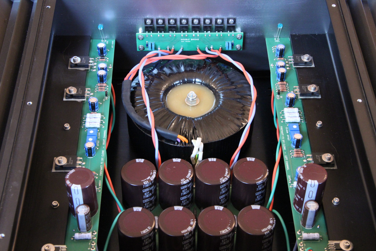

I use the fast ultra-soft FREDs (with C-RC snubbers) in my class A amps.
attachment.php

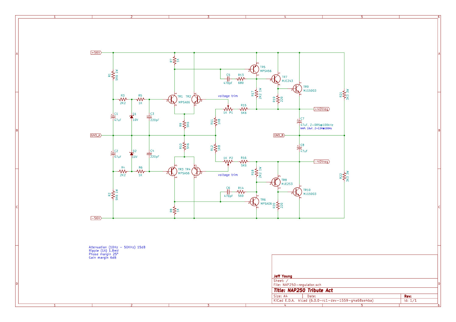

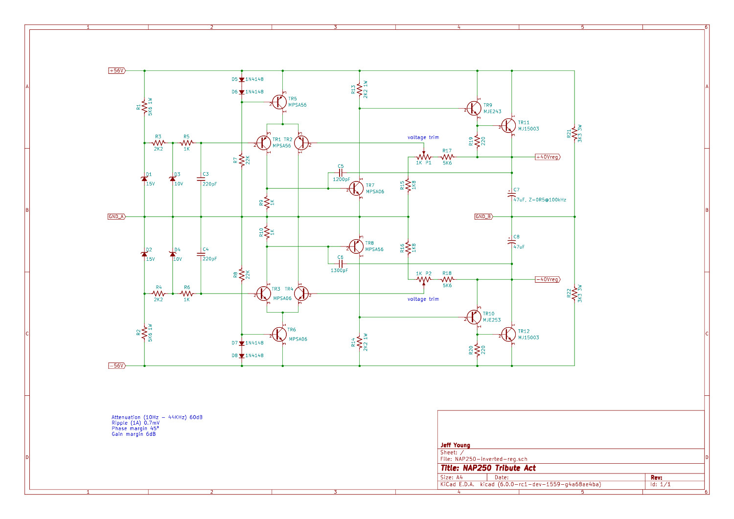

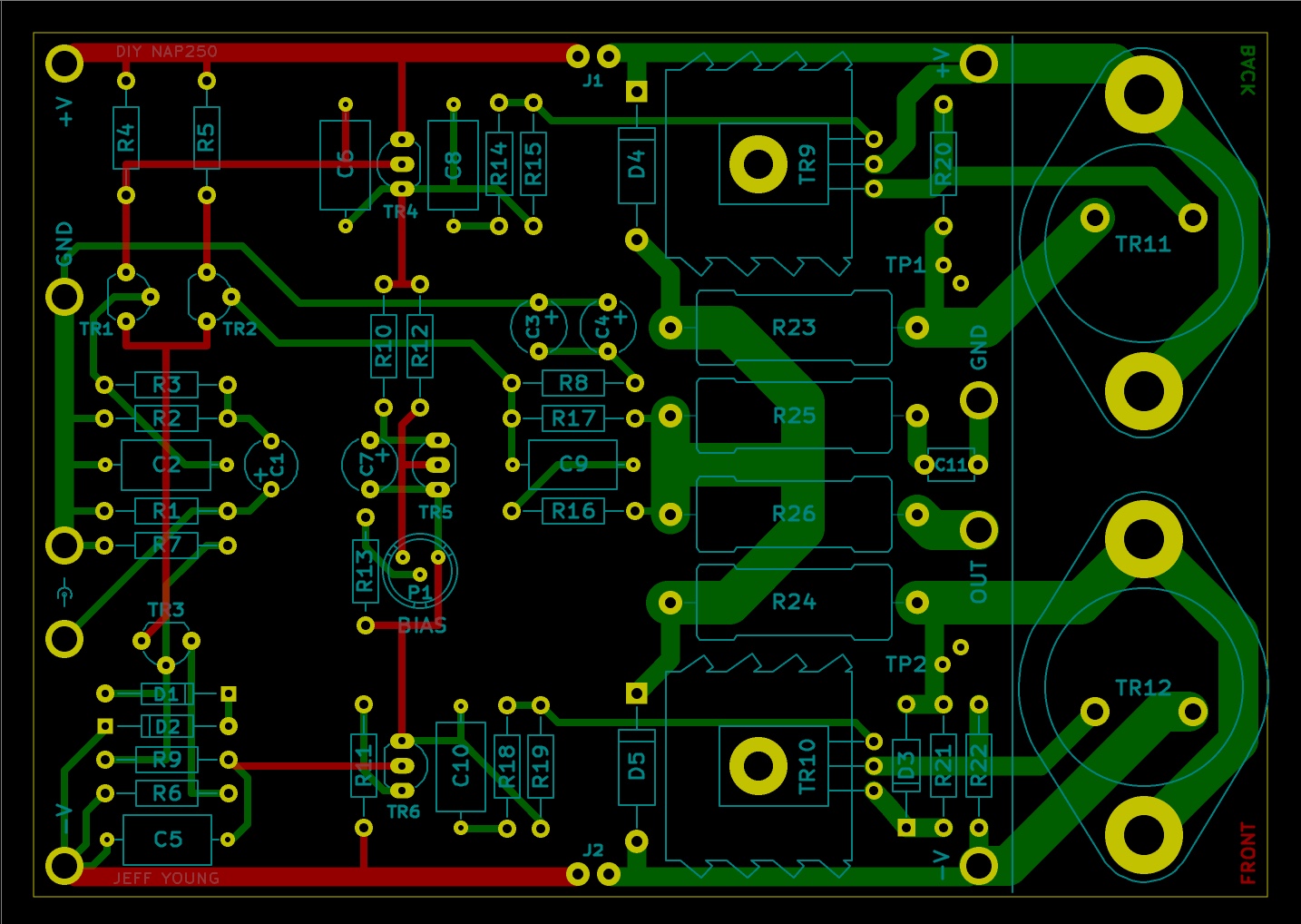

I might try the same with the NAP250, but my first builds will be with two versions of the NAP250 regulator (one a la JV and the other "upside down" to reference the VAS off of ground instead of the dirty rail).
attachment.php
attachment.php
if this amp works as well as it is beautiful to watch, it must be wonderful to hear!
I build my bikes as you build your amps and I spend weeks to reduce the electric beam to the simplest and with the best way so that they are almost invisible.
I have the greatest respect for your work, bravo!
