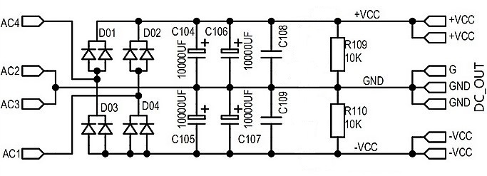

When it comes to electrolytic capacitors, together with a careful and correct sizing of the total capacitance (to avoid a "swollen" and "not very fast" sound) it is always better to avoid parallelism of more than 2/3 units maximum.
It is no coincidence that the exact scheme I used for the linear power supply stage of each single channel of the stage driver and power BJT of the Naim clone is the following (C108 and C109 are two capacitors, possibly in Polypropylene, 0.33/0.47 uF):

The one with six capacitors (three for each rail) posted before, is the one I used for another project, the DartZeel NHB-108 clone with two pairs of BJTs of power, which needs a higher power reserve in dynamic mode.

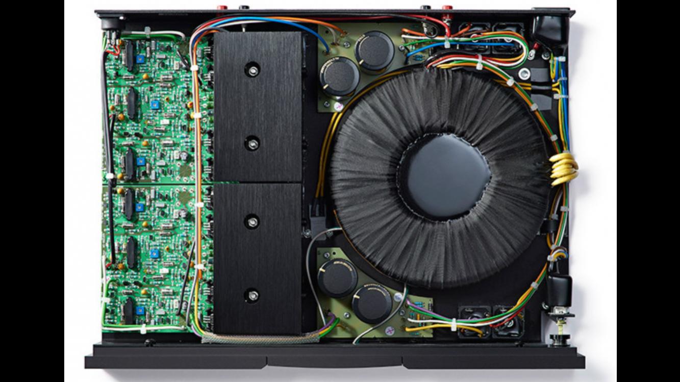

I think it was said already but just to clarify that this two diode rectifier is actually full wave NOT half wave. Secondly, it's implemented in this link with a choke input filter with a small cap to bring the voltage up - choke input would normally be 0.9 x Vac but a small cap before the choke can be used to tune it upwards, at the expense of higher charging spikes than a pure choke input filter. This approach is wasteful on power transformer copper - you need twice the winding when not using a bridge rectifier so you get twice the copper losses. For low current tube amps it's less of an issue. I used a two diode cap filtered psu approach on a Sansui Tuner when I upgraded the power supply but it's relatively low current - Grasshopper (you'll see a Naim circuit in that thread too).
The 250 DR spec says 80W per channel into 8 ohms. I take that to mean average sine wave power, implying the rails are around +-40V or so.
Some use a rule of thumb that the transformer VA should be twice the speaker output power. In this case 320VA. The Naim transformer is quite a bit higher than this by the look of it.
Note that the 250 models are linear regulated which requires higher voltage AC windings and more current than a simple rectifier and smoothing caps used on most other NAP models. To be scientific, you'd need to do a lot of static load testing if you expected any parity with the real products. Or you could search out the spec for the transformer - perhaps it's even written or labelled on later models.
The general description, including the transformer of the early versions of the NAP 250 was, according to Ced Taylor, as follows: "Nap 250: 70 watts into 8. 450VA transformer running at 56Vdc, 2 windings, 2x22,000uf caps feeding 2 regulator boards and pushing out 40V rails. A stereo amp- both channels use the same supply! Dodgy star ground at the speaker 0V terminals."
I would guess that the DC stated as 56V feeding the regulators would be an unloaded figure and you probably will need to calculate by the transformer's regulation, what that falls to at full rated load with the actual transformer, caps, rectifier and circuit resistances you wind up with.
To follow on, NAP250/2 was a dual mono arrangement and I'd be surprised if the 250DR version wasn't also. The transformer is still a single core but both sets of secondary windings are wound separately on it so loading effects are shared to some extent and the capacitance is now 2x10,000 uF for each channel's raw DC supply. This is the same arrangement as most later (black fascia series onward) models.
