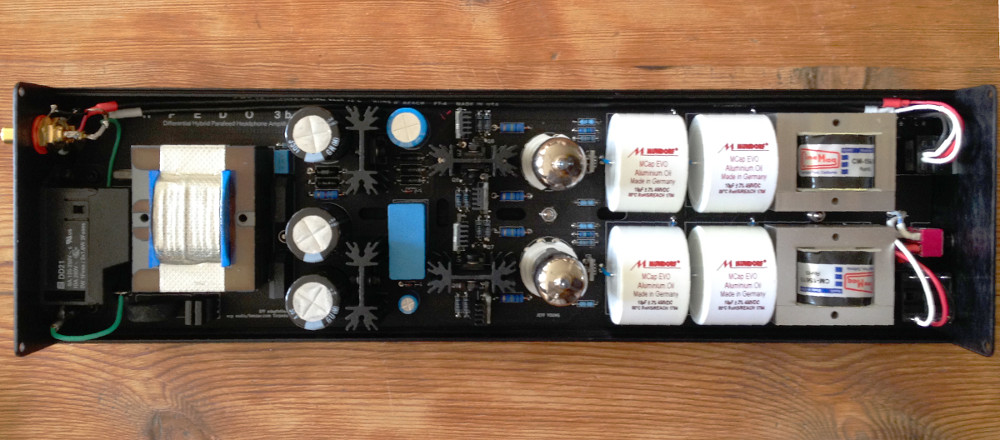

In tube amps, which had a power transformer (iron core) and a speaker output transformer (iron core), the magnetic field from the power transformer was often strong enough to induce hum in the speaker transformer and you could hear it. To minimize this coupling, the transfomers would be positioned at right angles to one another.
This is also where the Torpedo head-phone amps got their shape (and name): they're long and skinny to keep the output transformers far enough away from the power transformer.
attachment.php
