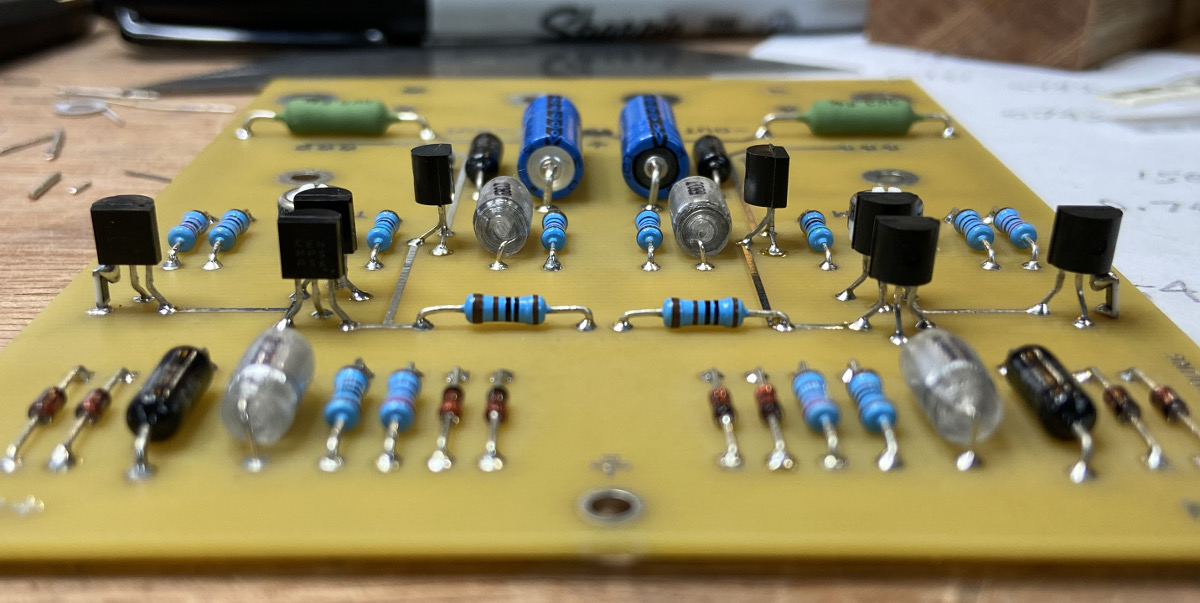

INVERTED REGULATOR CORRECTION INFO
In post #136 I discovered that the LTP CCS emitter degeneration resistors were missing on the inverted regulators.
In post #139 I put up corrected schematics.
In post #149 you can see how drmaftoon's neatly added through-hole resistors between the transistor leg and its hole.
I thought I'd try using SMD resistors:
attachment.php
While it looks quite neat, I can't really recommend it. I have pretty good soldering skills and this still turned out to be beyond fussy.
If you do want to try it, it might be easier with a very fine tip on your soldering iron. But I'd recommend drmaftoon's method instead.
