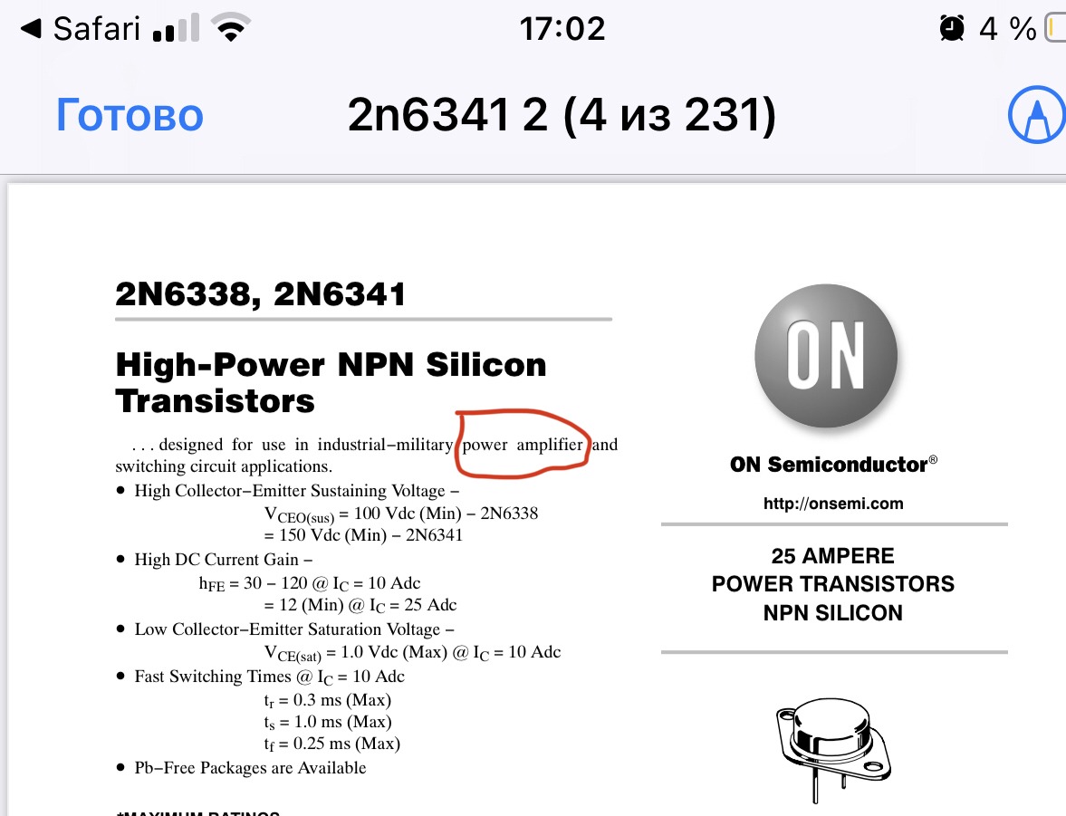

2N6341 - on semi say “for power amp” )Ok ! Why not, i have some 15024 at 4Mhz too, not very fast. But how can we know if a transistor is linear ? In some case it's indicated in the datasheet as a linear transistor for audio application but when it's not indicated ?

On-semi probably means linear motor drivers.2N6341 - on semi say “for power amp” )

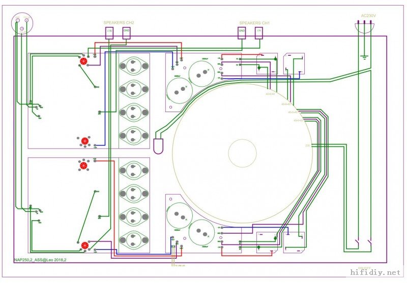

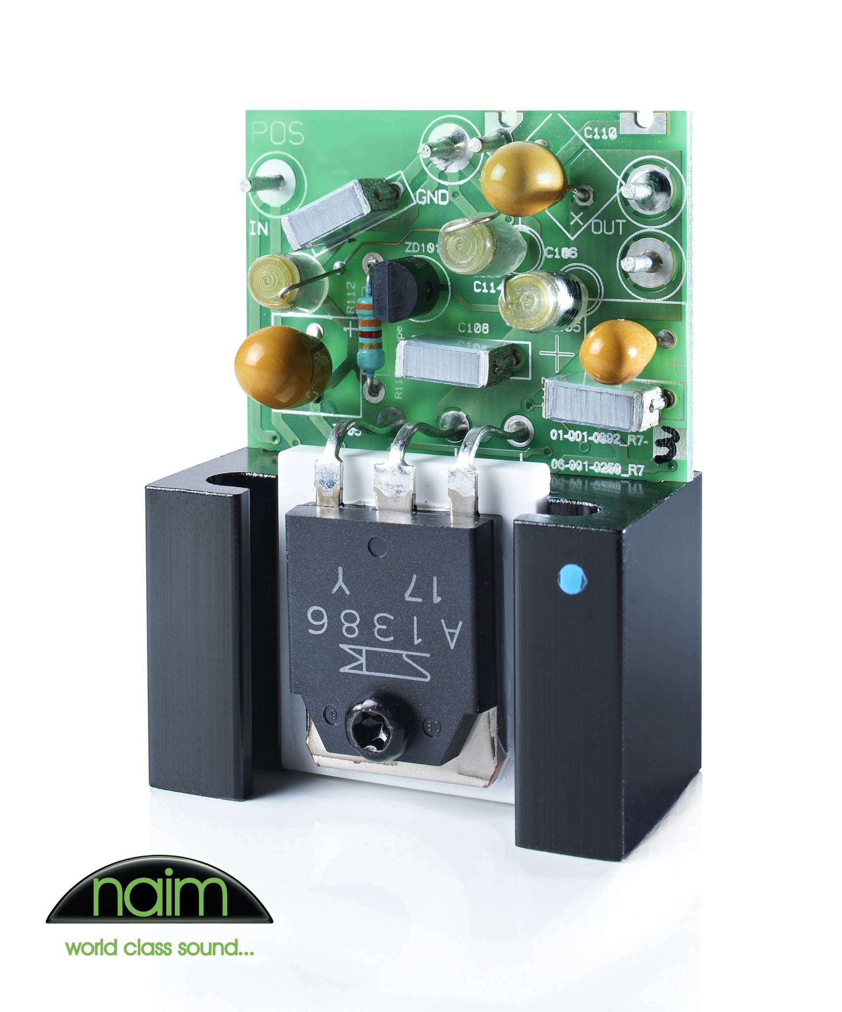

Here is what I found about DR:

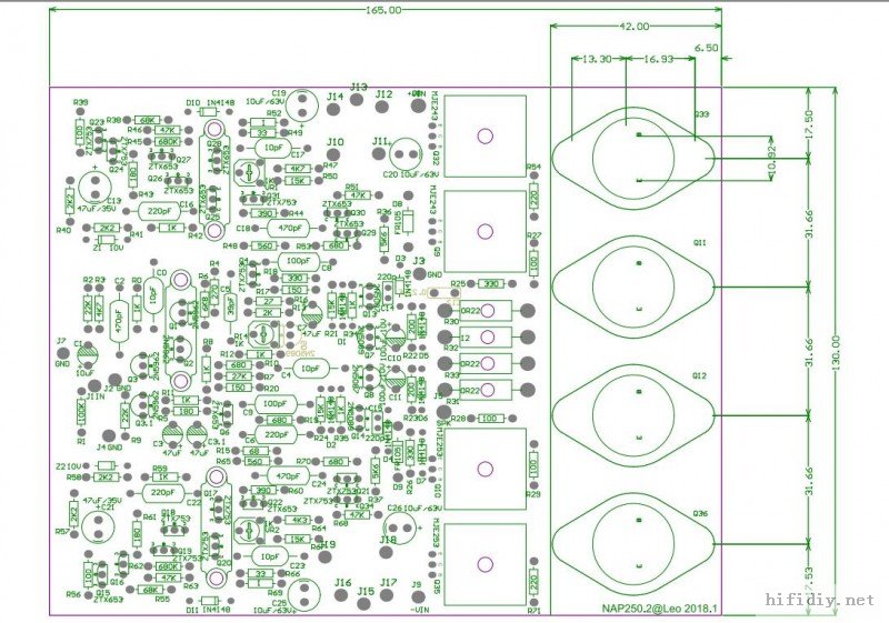

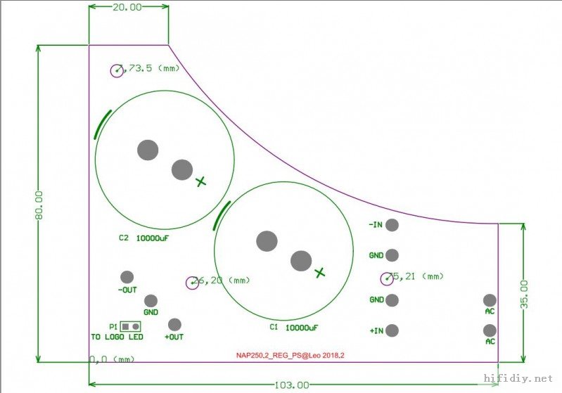

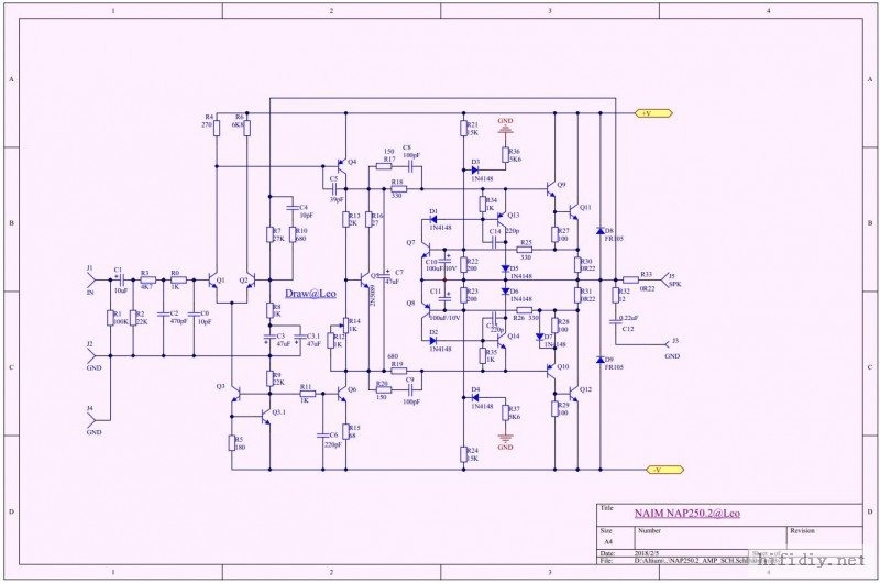

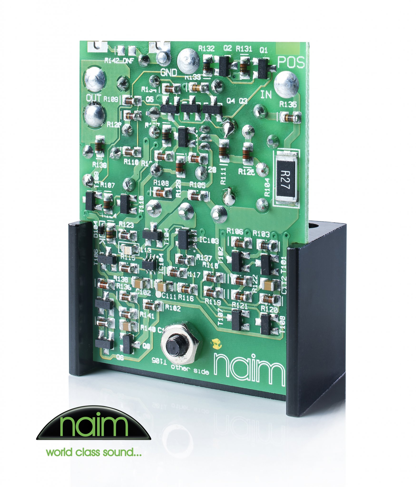

Maybe if I have of back side photos of 250DR PCBs I make pcb copy

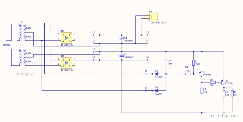

If you can make a working DR schematic please post here, or at least PM me

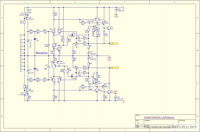

Attached new NAP250 schematics, reverse engineered by a member of a chinese forum:

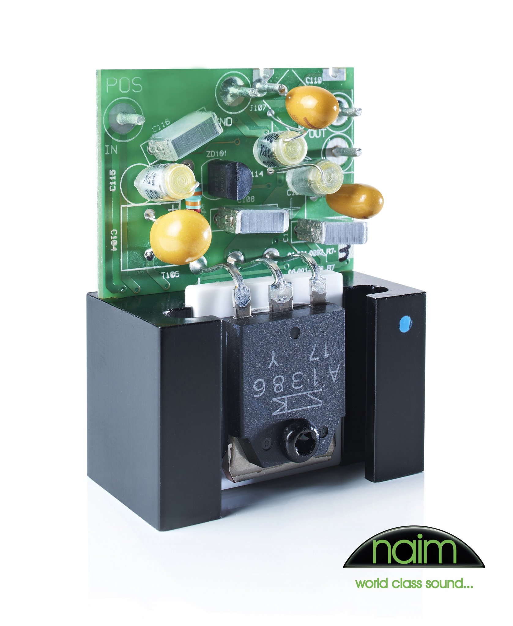

Nice research, guys. Here's the DR's power transistor:

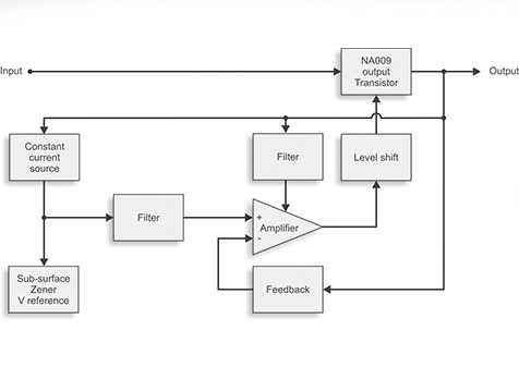

Odd. It seems to me the DR's pass transistor is operated in collector-follower mode. So the unregulated input voltage is fed to the emitter and the output is taken from the collector. This means the output impedance is mainly derived from NFB. This also implies the output of the amplifier stage is moving up and down with the input voltage.
In a typical regulator the pass transistor is in emitter-follower mode so that its base voltage closely tracks the output voltage, isolated from the input voltage by the CB junction of the pass transistor.
The 2SA1386 is PNP so...
Yes it looks pretty similar in the datasheet. The NPN is faster and has less capacitance, which is not untypical.Maybe that's the NPN complement?
