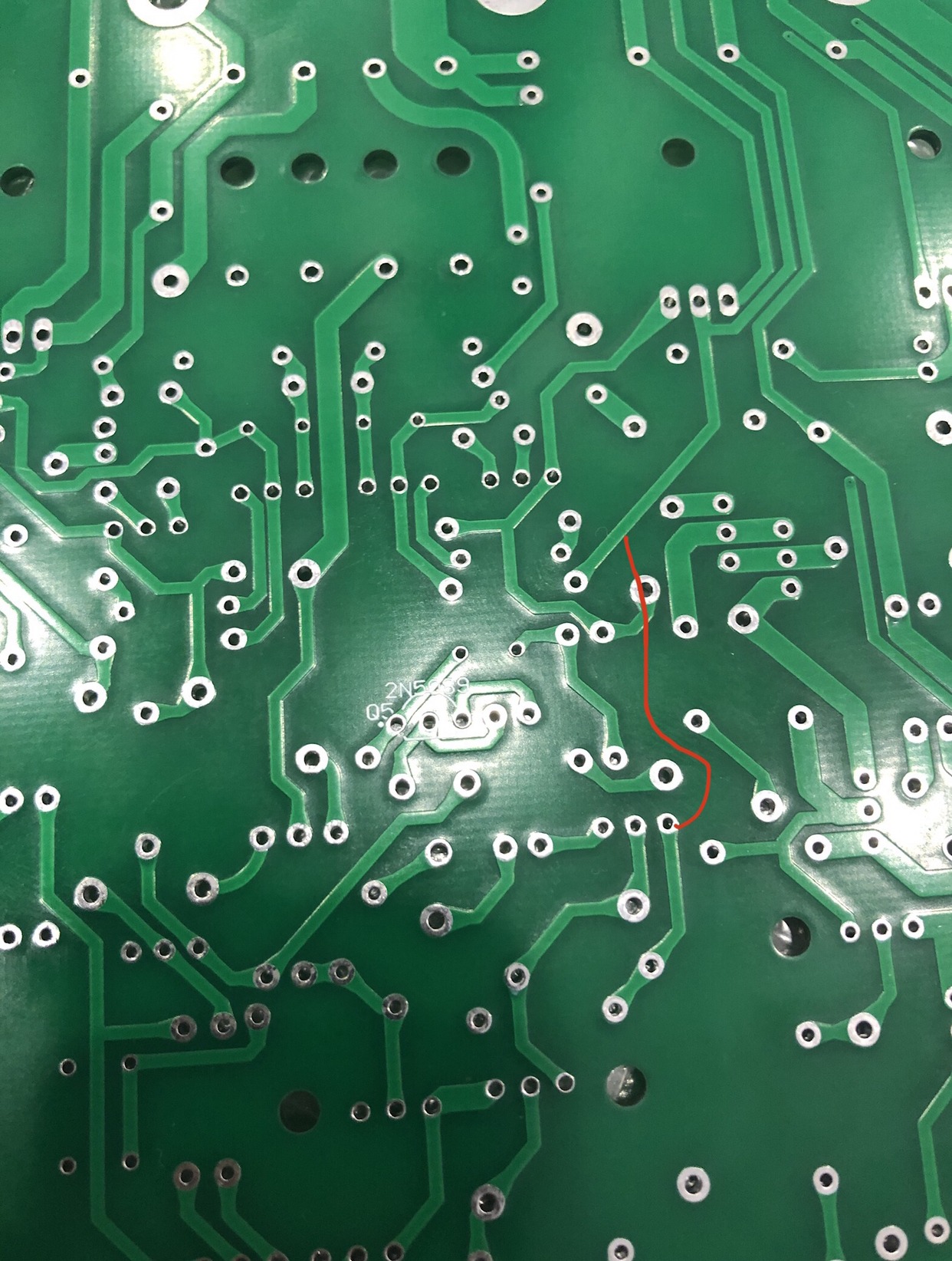

Someone try this KIT of 250.2 ?
http://bbs.hifidiy.net/thread-1346141-1-1.html
He copy the PCB directly but seems to have a mistake on negative power rail
And he draw schematics of the 250.2 but i don't find someone who can confirm it works proprely

I buy this board in Ali store about 5 month ago but that PCBs have of few mistakes (not enough roads) I mail to trader and he say “you need solder with wire of all not enough roads…” hhhhhh This PCBs stay with me and I not make it to full amp )
Good day CrisOk oleg Thanks you very much ! i will not left my time with that i prefer to do PCB myself lol
Yes correct
In attachment Ali NAP250.2 PCBs with one of mistakes)
p.s.
Dear Chinese boys if your watching this post please correct yours mushkelya boards !!! )) h h h h h
