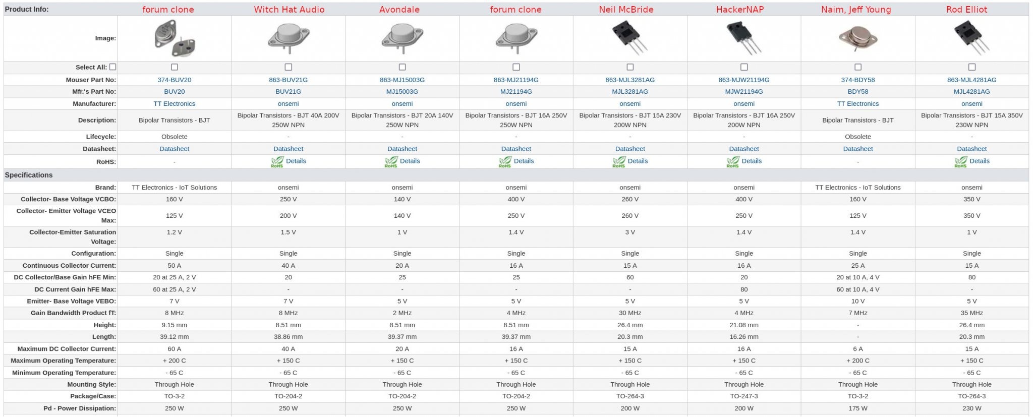

That would depend on your goal. Vereker believed heavily in the speed of the transistors. If you're trying to be true to his vision then I'd stick to the 8MHz comment.

"If you want to amplify 20kHz signals you need at least 20kHz transistors." - Confucius
But if you want to apply effective, stable GNFB you are going to need a lot more speed. The difference between 2MHz and 8MHz is, in and of itself, more a matter of how much global, negative feedback you can apply.

As said earlier, Naim used standard, high current switching transistors in both NAP and NAIT models before they "switched" to the premium audio grade Sanken LAPTs (70MHz Ft), with the so-called Chrome Bumper series NAP models. NAIT models continued with standard, then house-branded NA00X TO220 and TO3 switching transistors (probably Semelab sourced, like the more recent Naim branded power transistors)

MJ15024 in some chinese kits. it's 4mhz.Just noticed that Witch Hat Audio uses the BUV21G as output devices in their Naim clone:
https://witchhatservicing.co.uk/2018/09/24/our-new-phoenix-upgrade-for-naim-power-amps/

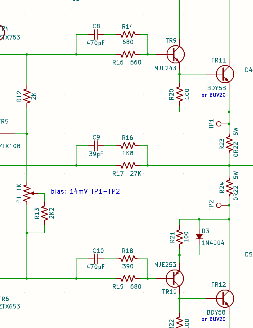

Good dayIt's not possible to find spice model of BDY58?
Please replace bdy58 of mjl21194 this a very same devices also you need build amp and power reg after that you listen power transistors and change it if sound is not like
Good day Dear Drorkmeister I still build headphones amps with little alcohol wayDude, thank you for the help. It turned out to be a 100K resistor where 1K belonged. Considering alcohol was the project's catalyst, it all makes sense now.
This RC circuits are needs for phase correction of output satage if you change output transistors you need change this RC networksI was looking the high-res orj. nap250 pictures on the web. I can say that R18&R19 are all the same with schematic(390&680ohm). But, for R14&R15 I couldn't find any picture showing them 680&560 ohm . Three of them R14&R18 was 470&150(180?) ohm. I'm not sure about the values but, there not the values as in the schematic. Are you sure about R14&R15? Did you see that values on the orjinal Naim circuits? Or this values are changing in the Naim Amp.?
can you tell us more about this?This RC circuits are needs for phase correction of output satage if you change output transistors you need change this RC networks

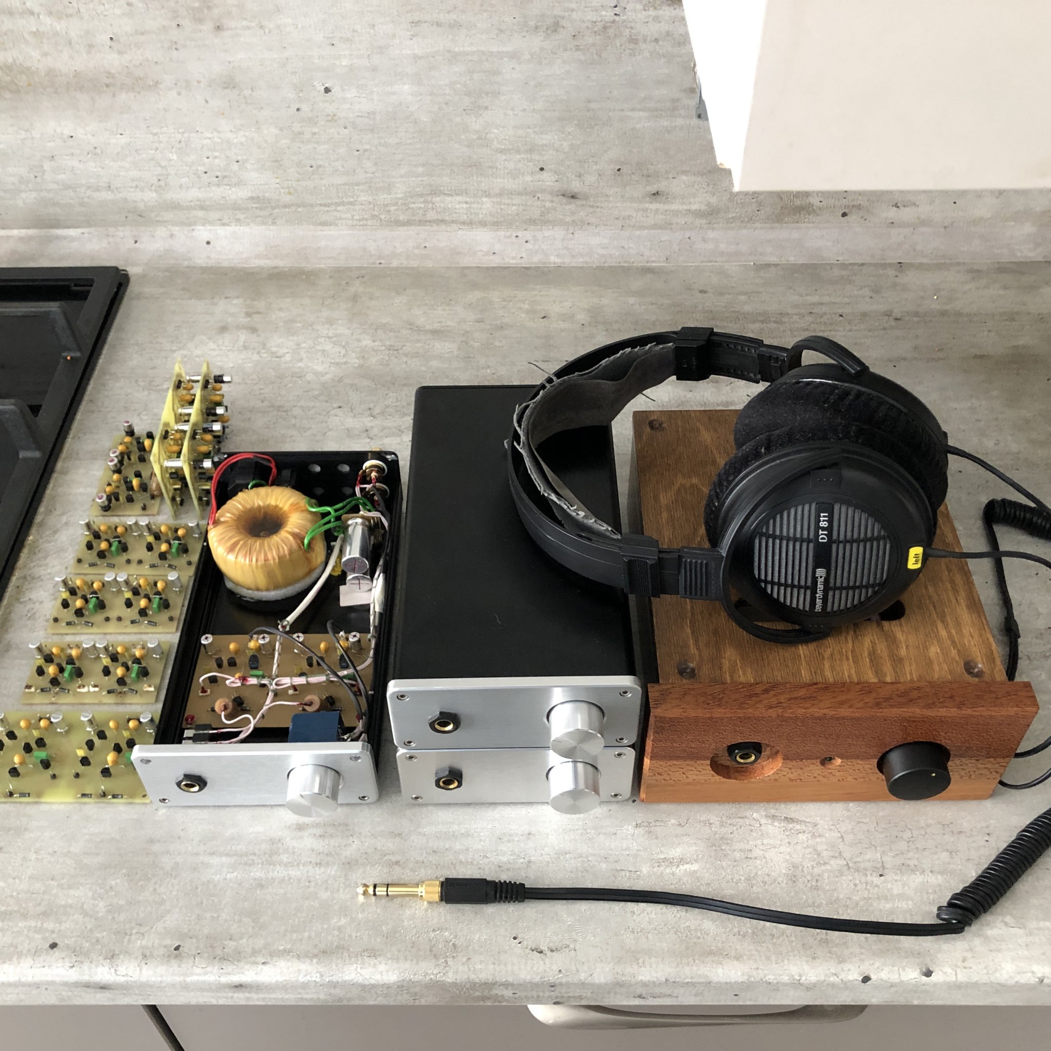

Hi everybody ! I enjoyed the thread and would like to share a few thoughts with you.
I am not an electronics engineer but a pure hobbyist. Therefore when I wanted to build my amplifier I tried to copy as closely as possible what NAIM had done at the time on these old NAP250s. Unfortunately there is not enough information available to build recent versions of the NAP250.
I based myself on the diagrams of neil macbridge. I quickly realized that the schematic of the amplification stage had many errors (or differences with other NAPs). Not having an original to make the direct comparison I had to find photos on the net to read all the values of the resistors. By cross-checking different photos, I confirm theses values of 470 and 150 ohms as mentioned. But other values also differ I could give you the link on the corrections made. I confirm the error on the regulation of the bias also it takes a 1000 ohms. There is also a polarity error on a capacitor I believe.
On the other hand, on the diagram of the regulation card provided by neil macbridge, I had no problem.
I have built two of these amplifiers, they have been working very well for three years, one at my house and the other at my brother's (and my father has an NAP250 original chrome at his house, which allows me to have a point of comparison).
Being an amateur I still made some mistakes. I used MJ15003 which is probably not the best choice. I also wired these transistors which gives too long tracks despite everything I was lucky that the amplifier remained stable. I even did a stress test on a 2ohm load with a capacitance of 1uF in parallel and it held up ^^
If I have time one day I would like to resume my work and make an improved version by correcting these errors and pairing the drivers in particular.
The best would be to have an original in hands to check all the values and find the errors that slip into all the kits and diagrams available on the net. In fact I did not find any diagram which is correct on the net on the amplification part of the NAP 250 whether it is the KITs avondale the DIY or others ... none respect the original diagram.

Of course, that is why your project doesn't sound like a NAP250. The MJ15003 has a low fT at 2MHz the frequency point where gain is unity =1. The break point where gain starts to decline to -3db where level at 2MHz falls at 20 dB/Octave, you can draw a line from that point at an angle of 45 degrees on a chart.Being an amateur I still made some mistakes. I used MJ15003 which is probably not the best choice.
Consider then the angle of phase starts to move a decade in frequency below the - 3dB point and will reach -180 degrees before gain has reduced to unity =1 unless some means of reducing the gain is used to prevent this. Compensation then hasto take effect at a relatively low frequency and above this there would be a declining level of nfb.
The muddled sound mentioned by your wife in the Youtube video is due to inter-modulation distortion.
As pointed out by Ian Finch and by me earlier in this thread, to get close to the original circuit switching output transistors are necessary.
If one looks at a plot of collector current on the vertical scale and base -emitter current on the horizontal this followsa pronounced curve from about 0.53V to 0.7V. Collector current increases rapidly in this range and with that the angle of the slope.
A switching transistor will occupy less length along a curve relative to the horizontal scale than such asMJ15003. If you take a plane flight at 30,000 feet the curvature of the earth is noticeable . Down on terra firma it looks flat as it did to ancient seafarers worried about sailing over the edge.

Yes the 15003 is not the best, but it still works very well. If i choose other output transistor i wonder that if i have to change drivers too ? or change other components values to optimize the design ?
From what I understood there could be to modify the phase compensation system.
