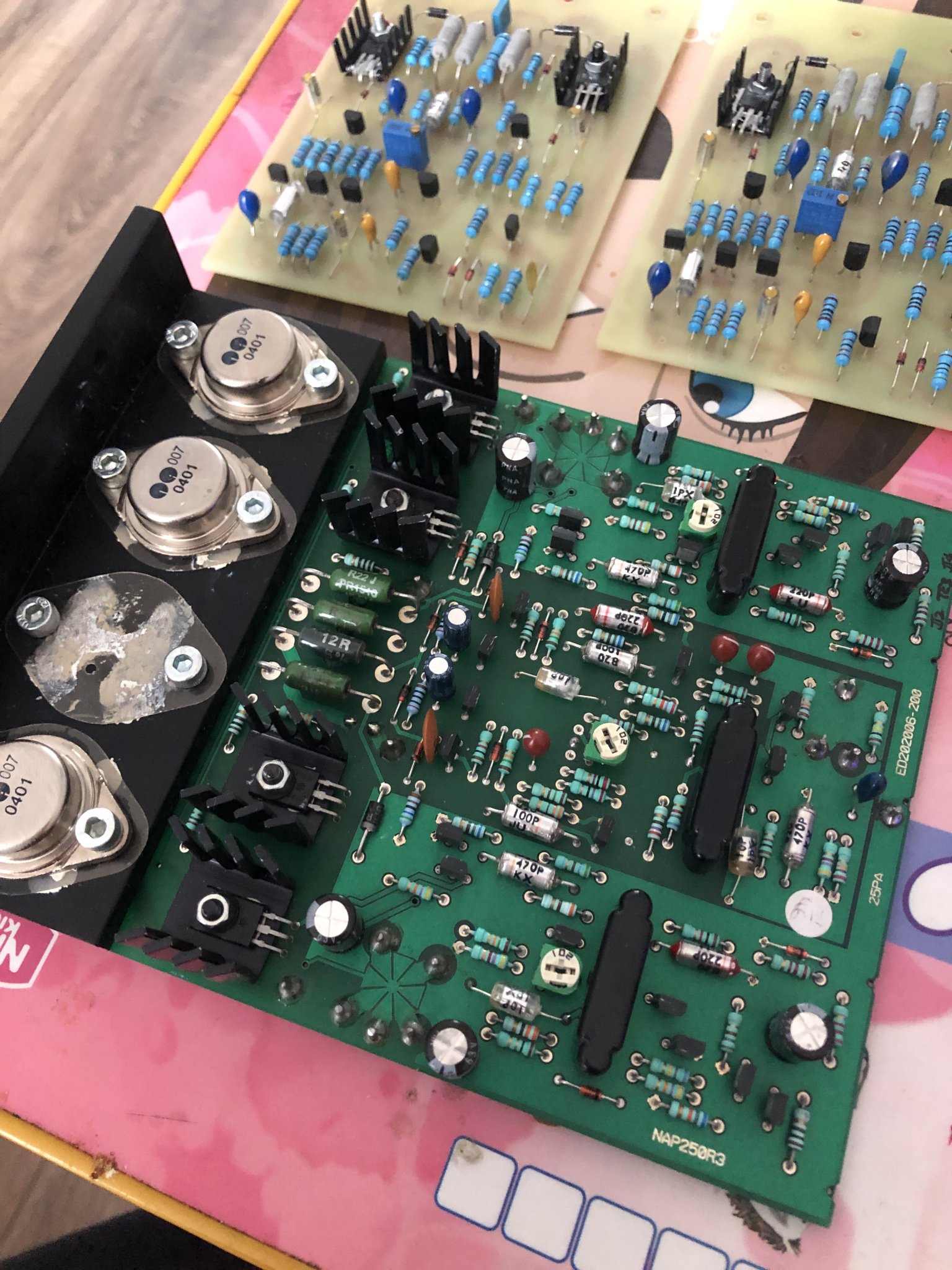

I mean, DC offset voltage must be positive or negative?.I'm not sure about; does idle voltage (output offset voltage) must be negative or positive? Or not important for TR2?
Good dayI'm not sure about; does idle voltage (output offset voltage) must be negative or positive? Or not important for TR2?

yes! output voltage. (or I mean, does DC offset voltage must be positive or negative?.)
(there is feedback from output. For nap tr2 may be open or close with sign of voltage)
"TR2 doesn't know anything about 0.". What is zero, dc offset? Over 27k resistor there is feedback to tr2's base. Yes, like you said, gate (tr2 I think) and emitter's voltage difference are open the tr2. voltage difference related with the tr2's base &emittor voltage. base voltage related with dc offset when the amp. is idle.
Or I understand all wrong
negative and positive dc offset changes the emittor-base voltage difference. it's written that offset must be less than 30mv (or less than 100mv). Is this offset for nap140 is positive or negative? copy of nap140's offset is positive and MCC series are negative.
0 is GND. DC offset is the delta between GND and the output at idle.
(Sorry, in my previous post I meant "base", not "gate". The term "gate" is for FETs, not BJTs.) TR2's base voltage is the output (DC offset when idle) minus the drop over R17. The drop over R17 depends on the current flowing through TR2.
Let's say the emitters of TR1 and 2 are at 20V. TR2 will be on whether TR2's base is negative or positive from 0 up to about 18.9V. Or, if the emitters of TR1 and 2 are at -10V, then TR2 will be off whether its base is -3 or +3. This is what I meant by TR2 doesn't know anything about 0 (or the sign of the DC offset). It's only the difference in the base voltage and emitter voltage that it knows about.
To cut a long story short, the sign of the offset doesn't matter. When someone says "the offset must be less than 30mV", they mean the output must be between -30mV and +30mV.

If you use the original transistors output voltage about 0-2mv.
Also if h21E of used transistors same with L and R channels you have same output voltage.

Good day700uV offset reading is tiny. Did you forget to solder your output transistors?😁
I try added output transistors to nap160 and nait and if you check output voltage whith output transistors and without you have his digits small different about +-1mV on output voltage because output voltage creates in input stage transistors and his currents make output voltage

Good dayI search many times on the net, i never find the DR schematic. I just find the PCB of the 250. with schematics but as you saw there is mistakes on the PCB ... So it should be enterely verified on the original PCB by reverse engineering
I buy the original NAP250.2 board
in this stage without one transistor
But nobody Known about NA00* Output transistors Volts/Ampers/h21e/max freq…
