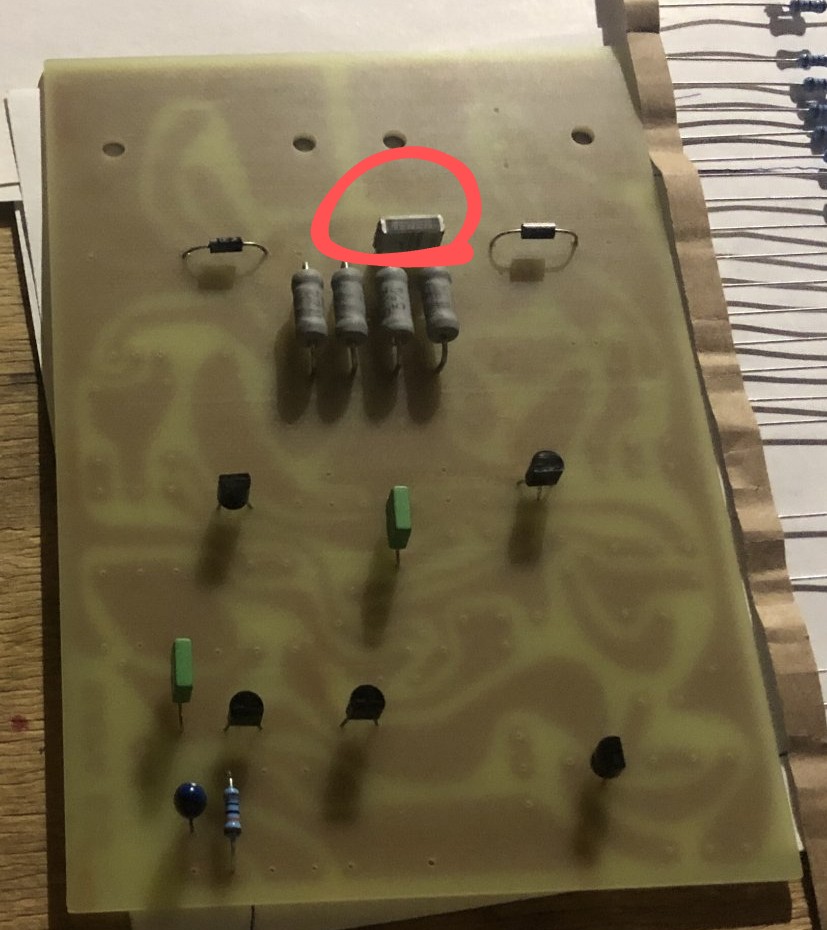

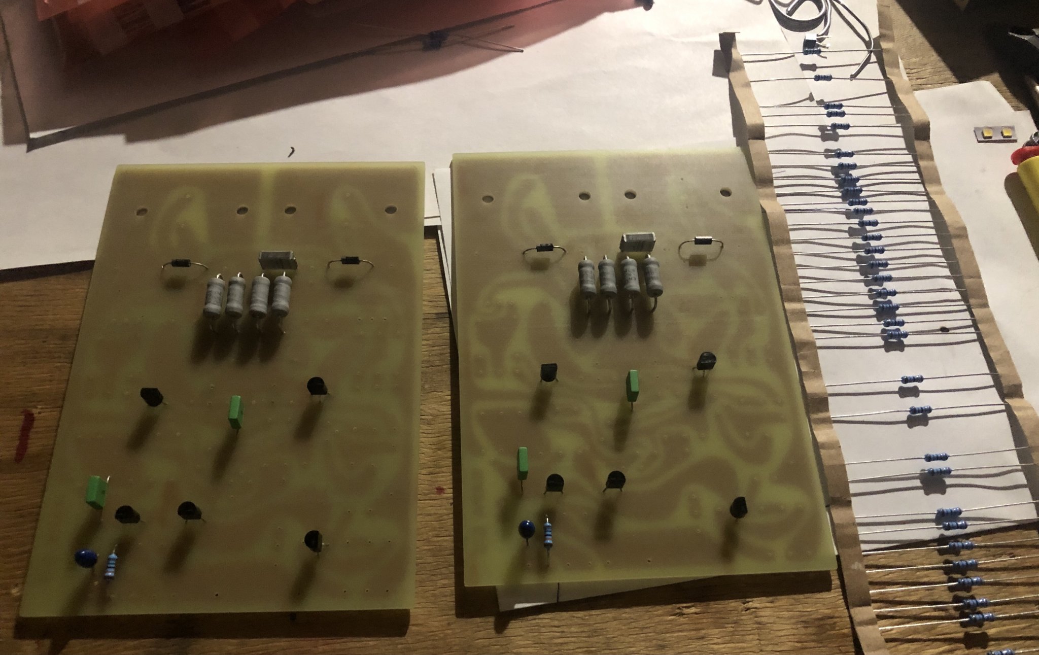

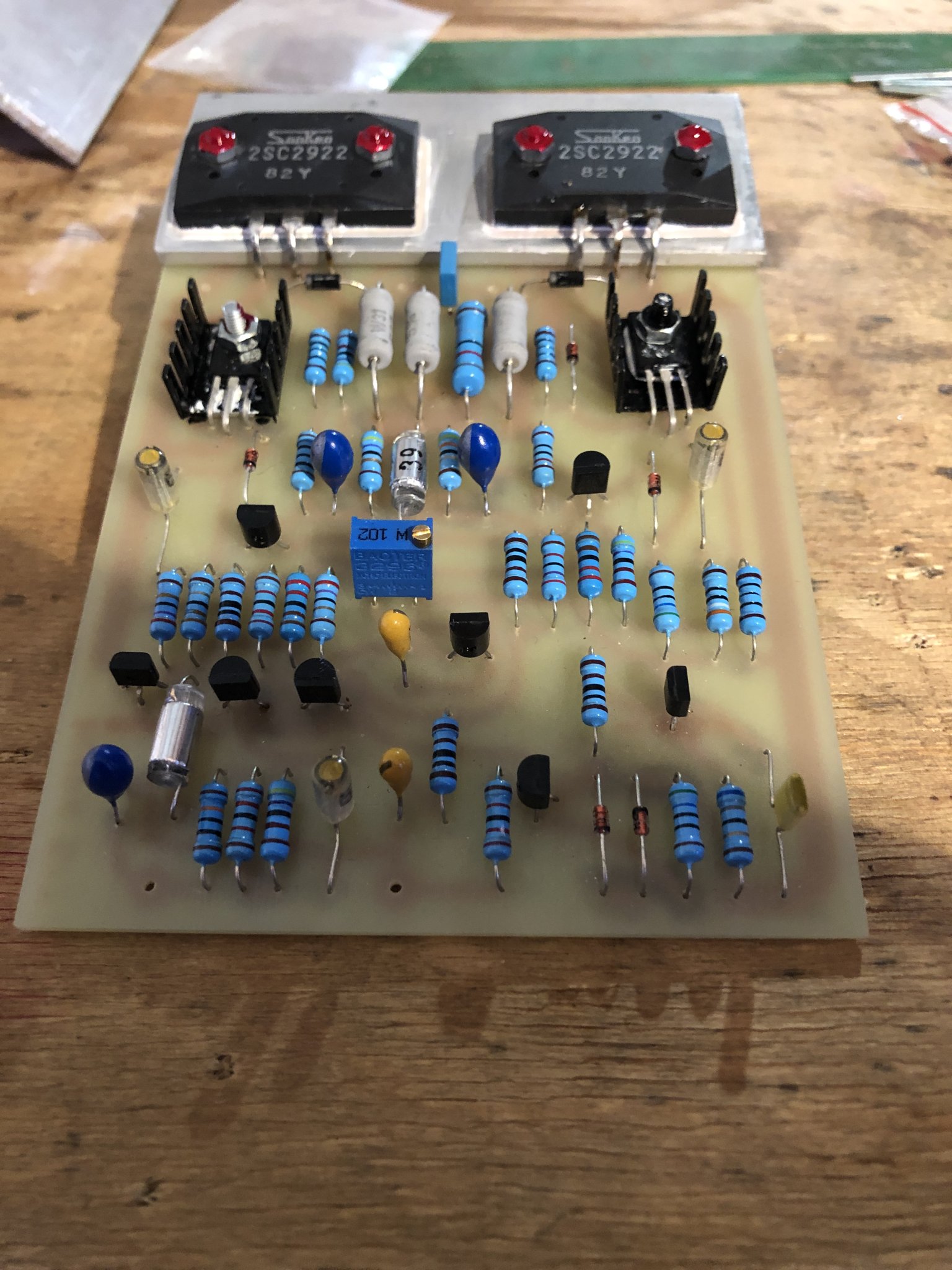

This is my old design. But, miller has still 47pf. I have no 39pf Styroflex cap.47pf for Miller is a lot
Try use about 39pf
Also ceramic caps is not good for sound
My friend make DIY film caps
Polypropylene with oil with paper with cuprum foil
I ask him about 39pf DIY

this is a stacked film PET capacitor from the 1980s
NAC42.5 DIYGreat work Oleg with the preamp too what are your PCBs ?
- NAP250 clone
