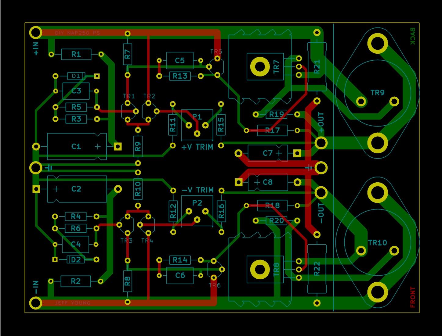

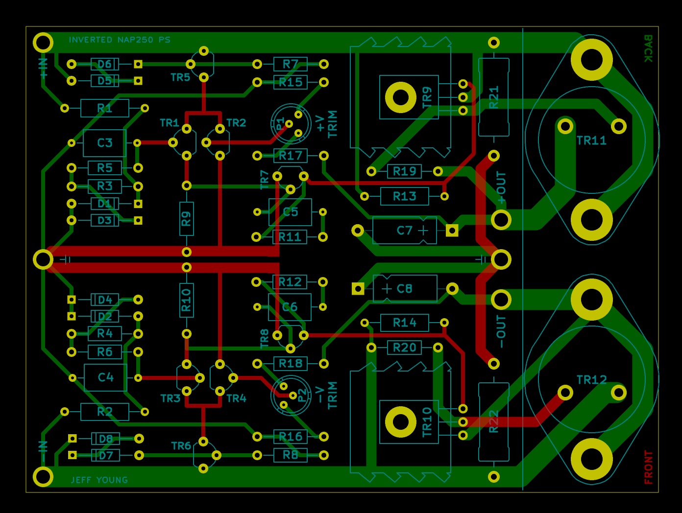

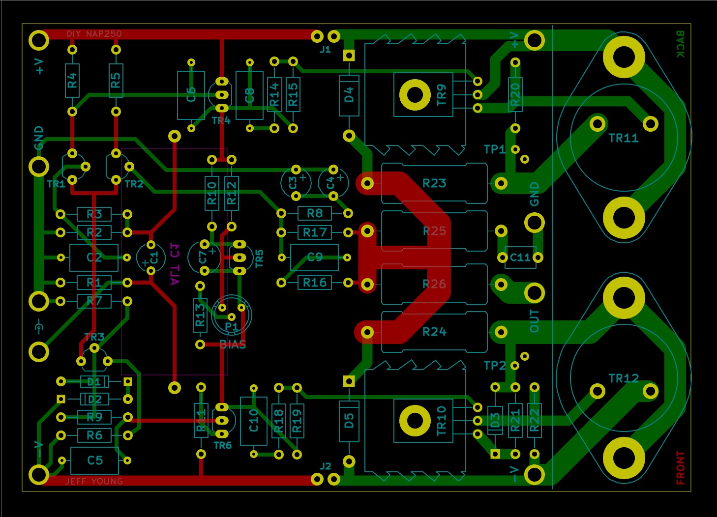

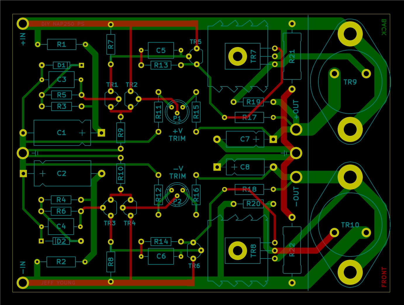

An update on the board designs. Main amp changes are to shorten paths in CFP and to join +/- outputs before feedback take-off point.
Regulators (both Naim and inverted-Naim) also get shorter paths in CFP, along with more compact compensation networks.
Compensation schemes are traditional Naim: Miller + triple lag compensation for amp and Miller/dominant pole hybrid for regulators.

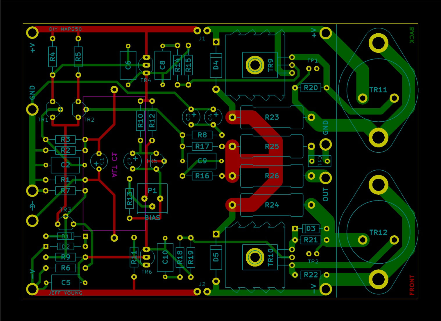

.... You may want to check the pin-outs of your drivers and power transistors.
Well, rats. I thought that worked out a little too well....

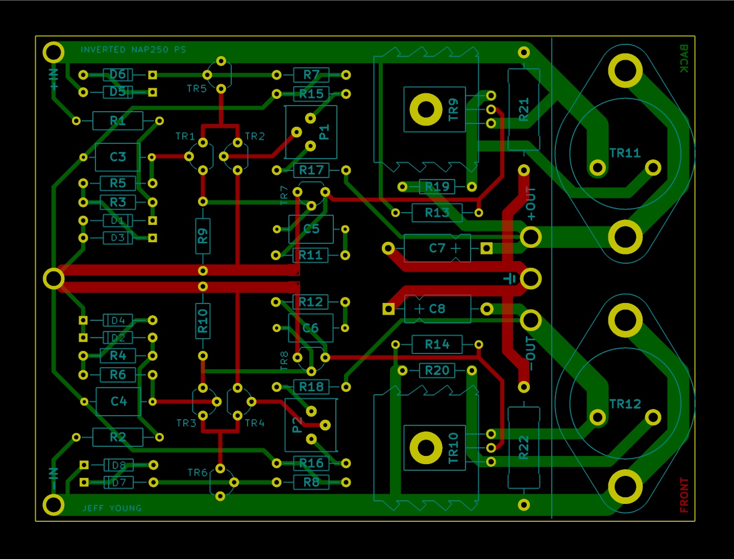

Next iteration:
- fixes the issues regarding TO-3 & TO-126 pinouts @traderbam noticed
- rotates the top TO-3 180º as I got some heatsinks from Les and my guess that the two output devices were in the same orientation turned out to be wrong
- larger I/O holes as I found some swank pin connectors (https://www.mouser.ie/datasheet/2/571/Brochure_MIL-1013710.pdf) to use
