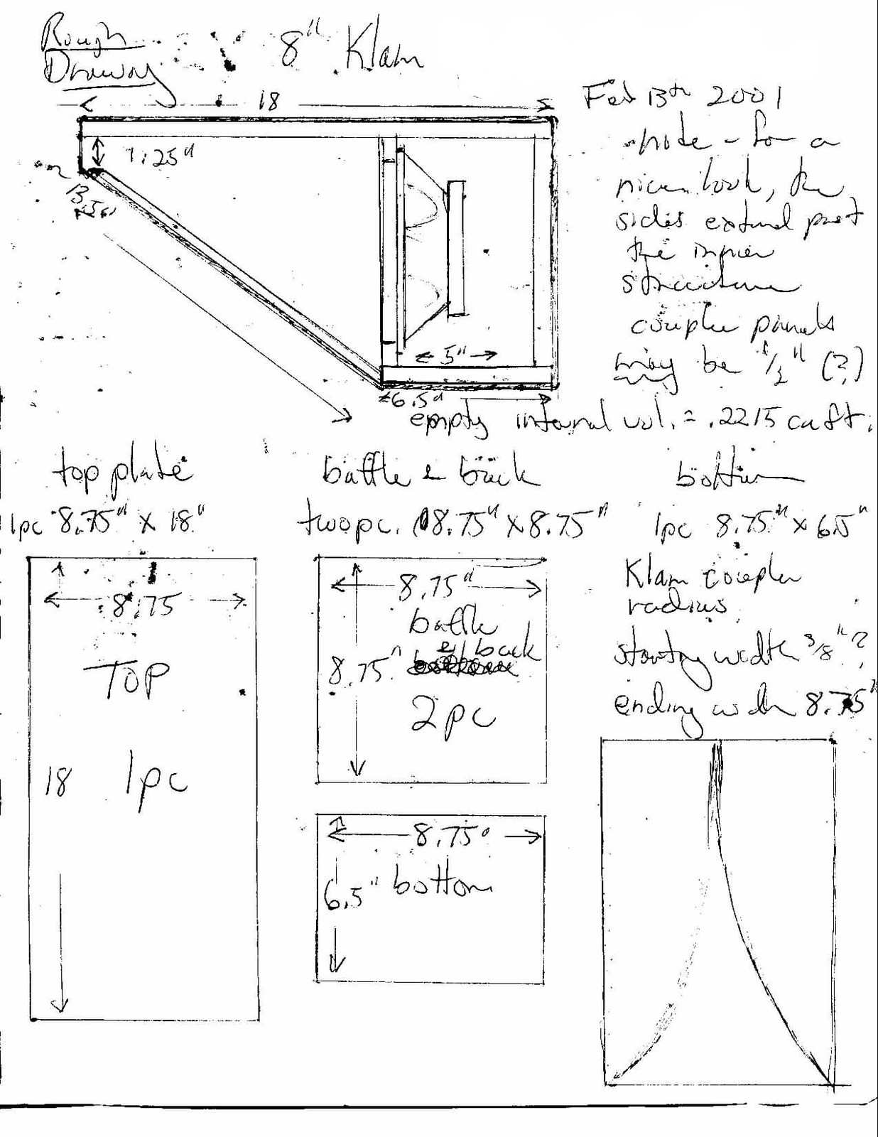

little PC speakers, if a K may help, probably would be a regular K - unless the speaker is inordinately "bright" as the klam format buries the speaker at the far end of the slotted wedge vs a regular K having the driver at the shallow end.
Little K have their cavity resonance up pretty high It might be possible to make a little klam which does not honk, using pvc pipe, sliced diagonally and end fitted with a flat piece with slot cut - or take a heat gun and flatten the front pipe to get an oval cross section. That could be fun. .The back chamber could be 4" or 5" pvc adapter so result would look like a sawed off potato cannon.
This little klam w. FR88 was pretty bad sounding - a speaker with significant on-axis rise such as a LaVoce 3" I've used with slot filter probably would have been better.
9mm Baltic birch would be better even for such a tiny thing as this than 6mm.
Melamine sponge front and back chamber pads probably would have helped too.
My klam15 sounds fine without any front chamber damping. Mild damping might give some improvement.
Klam8 and Klam 10 size could use some front chamber damping to reduce ricochet junk. That would not be noticed
at some distance but would be obnoxious up close.
I'm lusting after the first X15's tweeter klam and hope can find someone to print it after Pelanj posts the 3D model.
![uX3doMk.jpg](https://i.imgur.com/uX3doMk.jpg)

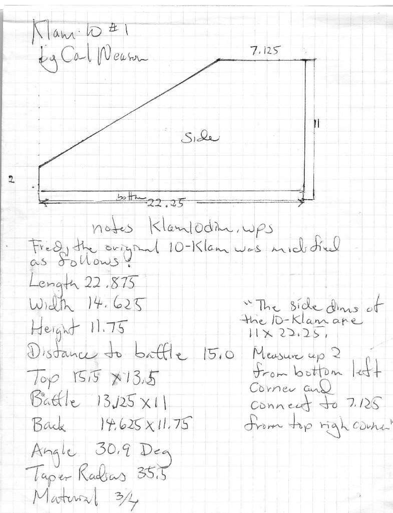

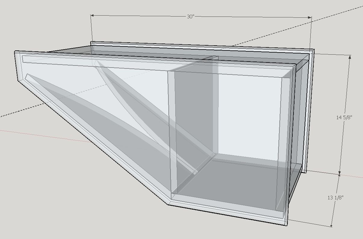

I've personally only built Klam3 and Klam18. I do think a Klam15 built by my long distance friend John Lapaire, turned out very well and the only mod I would do would be to shorten its back chamber to move Qtc and power handling up a bit, and reduce overall length. It should be very nice up on a tripod. (I lost upper body strength in just a couple of months decades aoo from sleep apnea - don't know what it really did.}
IIRC there's maybe 2 cubic foot rear chamber. With medium rear chamber bill that might be knocked down by a half a cubic foot, which would shorten overall length by maybe 4 inches.
