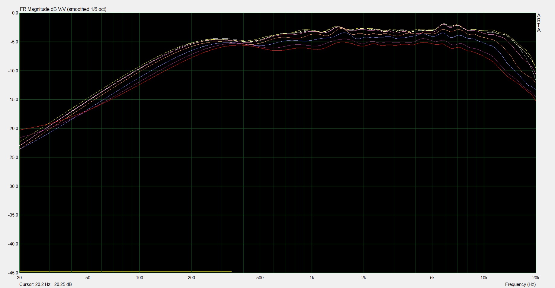

i guess 8" do fit.
raal 140-15dam with w22 seas excel 0°-50° horizontally.
measurement is windowed, so 500/600hz and up.
Very nicely done!
What was the crossover?
i build some speaker with raal 140 with for example hm170MN0 (6 1/2) in a 3-way. nice, but not perfect horizontally dispersion.
with 7" focal audiom midrange,
8" peerless, accuton and paper or magnesium Excels.
chose the 8" magnesium in a 16/17 litre sealed enclosure, with a 680uF cap in front. goes down to 44/45Hz -3db

sorry, can`t share the crossover.
but it`s a symmetric 24db LR acoustic filter, but electrical it`s a 18db highpass and a 12db lowpass with notch for the resonance.
Yes, but "near" what freq.? To be less specific - is the filter below 2 kHz?
Also, have you done any higher power distortion testing with that RAAL + filter? (..Say a db range 1meter of: 85db, 90db, 95db, 100db.)
yes, it`s below 2k.
of course i did distortion measurements.
but they are fine.
remember, you get a bit of a SPL drop above the xover frequency, so lower THD and the deflector pads reduce THD, too.
