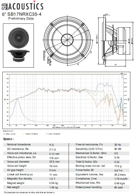

The SB17NRXC35-4 cost about $60 US. It has very low inductance and the 4 ohm load is similar to your RAAL. 92db @2.83V sensitivity. I have used several SB NRX series midranges and found them to be excellent. I also like the SB29RDNC dome tweeter, and I believe there are Xovers for these two speakers.

For me, newbie, fr of SB17N looks like satori 16P...o.k. satori is 90.5db
but if satori is ''beter'' driver I will go that way
AES Lambda TD6, would have to order from USA, and shipping would be costly...i think like 100$
