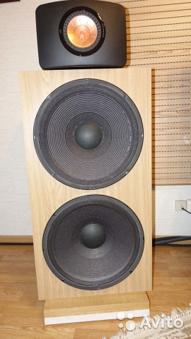

MDF has 2 problem in painting.
1. The edge is rough and absorbant, so are most other wood. Fill it with wood putty and sand before start painting.
2. Most paint does not adhere to MDF well. Water based paint is even worse. Use a coat of primer.
Share your painting experience and show some picture of the finished product. Mine looks like this. But it took multiple days and many coatings. (Not to say a few tries.)
