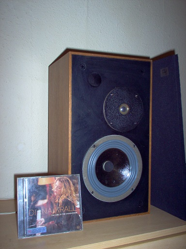

Those old Dynaco-A25s are getting a bit ancient these days IMO. I mean, how long do you expect the glues and rubber to hold up? 😀
I've found some especial bargains down my local second-hand shop.
These MA7's weren't bad for a tenner in UK pounds:
A 5" bass in a big box works well in a small room.
These MA 300-MD's weren't too bad in a medium room:
Good cabinets and good drivers. Plenty of fun.
