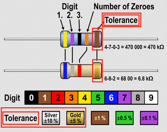

3) For your information, and this is first hand knowledge because I WAS BUILDING AND SELLING AMPLIFIERS 50 YEARS AGO (actually since February 1969, do the Math), way back then you could buy over the counter, at any Electronics Components Shop:
* 20% tolerance resistors, no extra colour band indicating that, which were the cheapest.
* 10% tolerance ones, which is what the average builder or hobbyist used, trying to be slightly above average. More expensive, of course. Silver band.
* 5% tolerance, PREMIUM quality, significantly more expensive. Gold band.
So that Yamaha is PERFECT, as far as 70´s consumer grade Electronics go.
Stop OBSESSING over non-problems.
10%, 20% and worse was so much a thing that it was indicated in the official Electronics Industry codes (EIA and all that).
