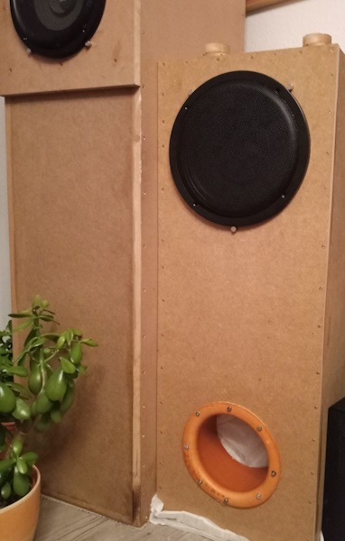

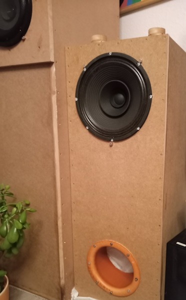

I have finished building the speakers now. volume is 160L and I went with a nicely large port of 19cm diameter. I made it out of a larger waste-waste-pipe that I opened to a nice port with a heatgun, a metal bowl, pliers and a lot of swear words.
The speakers are about 110cm tall, 40cm wide and 50cm deep with 2 holey braces evenly spaced, so the speaker has 3 "compartments" inside. I filled each compartment with IKEA polyfill (IKEA sells "inner"-pillows without a nice cover, just the insides at 3€ per pillow (50cm x 50cm), for anyone wondering.
Same material as hifi-stuff at just a fraction of its cost. Also, I glued damping felt on the inside walls.
Sounds very good so far. and no sub needed for my taste.

Hmm. I have been listening yesterday and today to the Fane-speakers.
My frame of reference are BIBs with the W8 2145s and double mouth-horns with Fostex 206NVs.
I quite like the direct punch of the Fane speakers. The sound is a bit boomy, but that's what I asked for, hehe. However:
I am used to the BIBs rich and full "sound of wall". Even listening to rock and metal music, the BIBs develop a rich sound that envelops you. The sound has a large "body" to it. At the same time, the sound is never lingering, excessive or exuberant or "too much".
With the Fane speakers, I miss the precision and predictability of the BIBs.
The Fanes are somewhat as dynamic as the double mouth/Kirishima horns. But they're less precise with their sound.
Overall: Very interesting sound, and god, do I love the big bass reflex vents with 19cm diameter. The Fane's are somewhat similar to the BIBs in their punchy presence, but less precise.
I like that they are smaller than the BIBs (ha, go figure) and are less intrusive to the room.
However when it comes to the speakers, I still prefer the BIBs so far.

The BIBs with the TangBands are already 2,1m tall, 40cm wide and 55cm deep, that's big enough. Pictures will come next weekend. Although I'm all about practicality, so it's really just 2 big MDF-boxes with an orange sewer pipe opened up at the bottom as a bass reflex port. But hey, it works.

Well, here are the speakers with and without the grille. I like to use small magnets to keep it in place.
