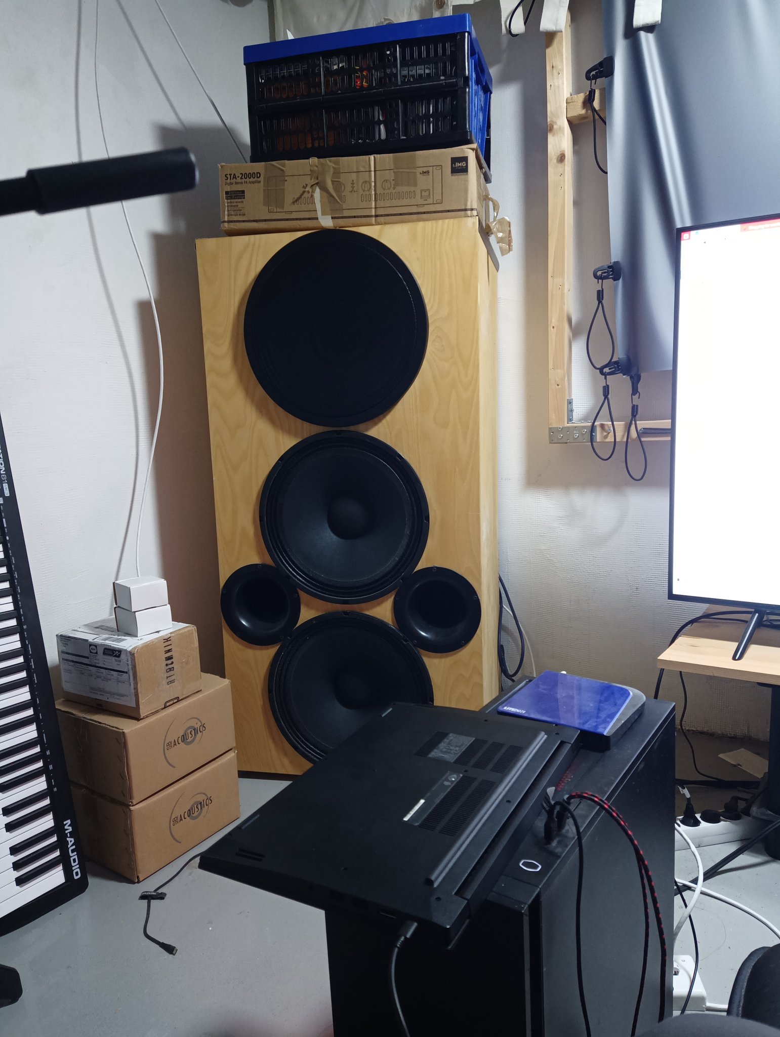

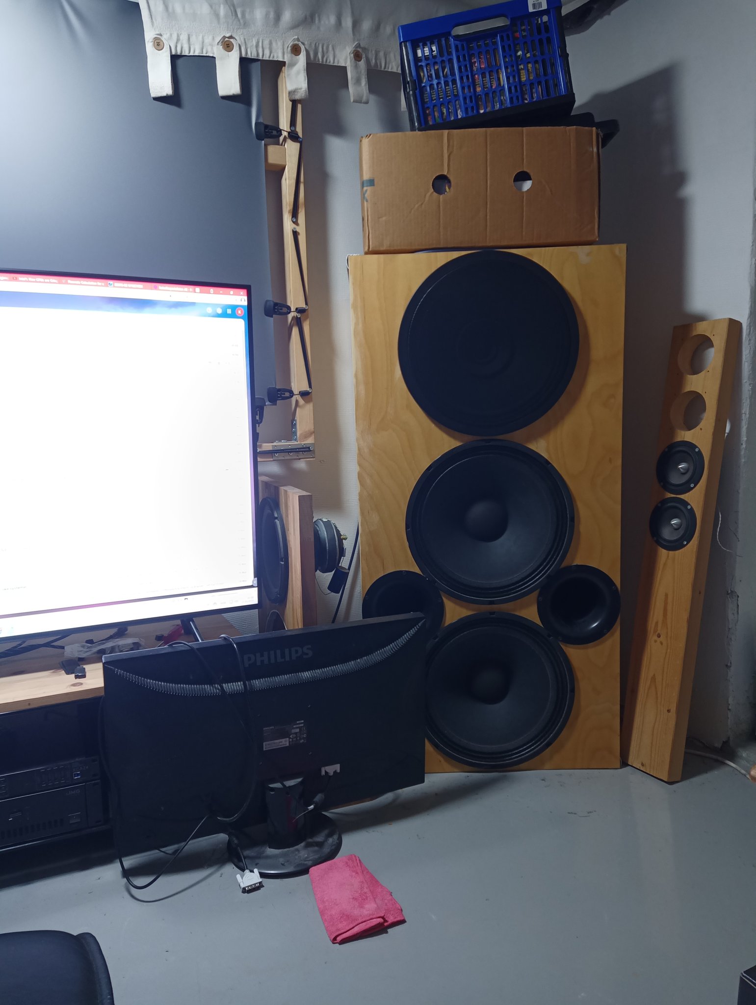

As my own waveguide projects have been on hold for a while, I've been helping a friend with his 12-250TC project. He built approx 140L enclosure for it, which is a transmission line. I can't yet comment on how well it turned out, as we haven't had the chance to listen to it in his living room, only in a less-than-ideal workshop space. The most interesting observation so far has been how much damping the pressed steel frame of this speaker affects its performance.

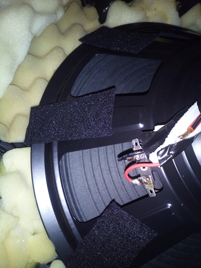

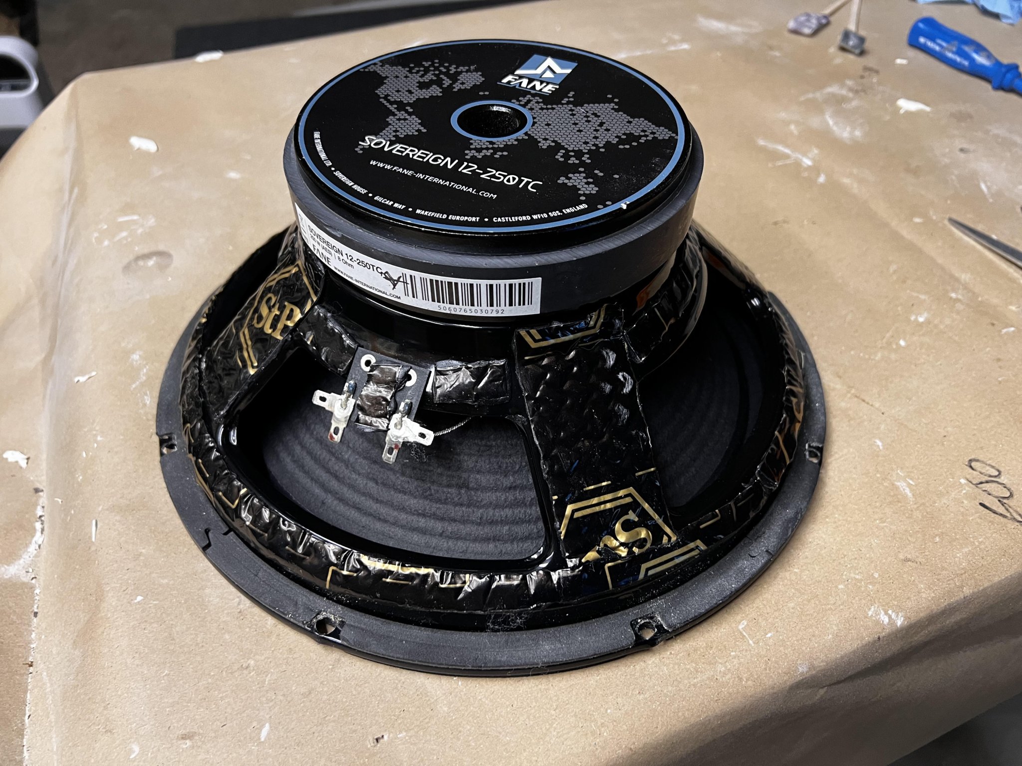

We used sound-deadening matt for car-audio called STP (similar to Dynamat etc butyl rubber matts)

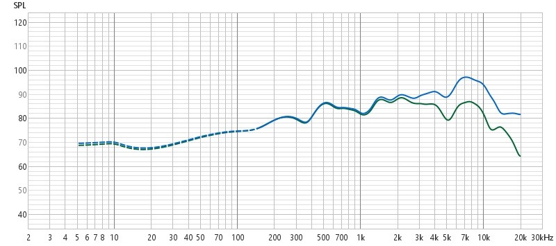

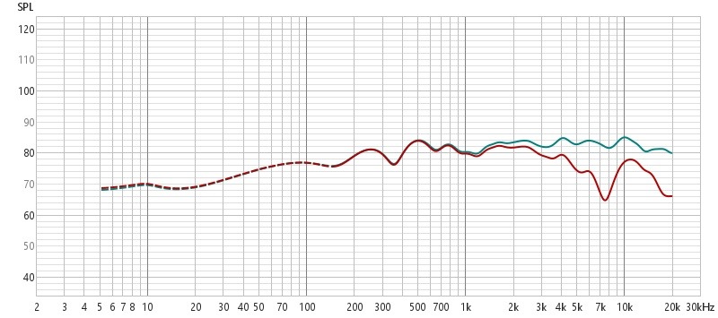

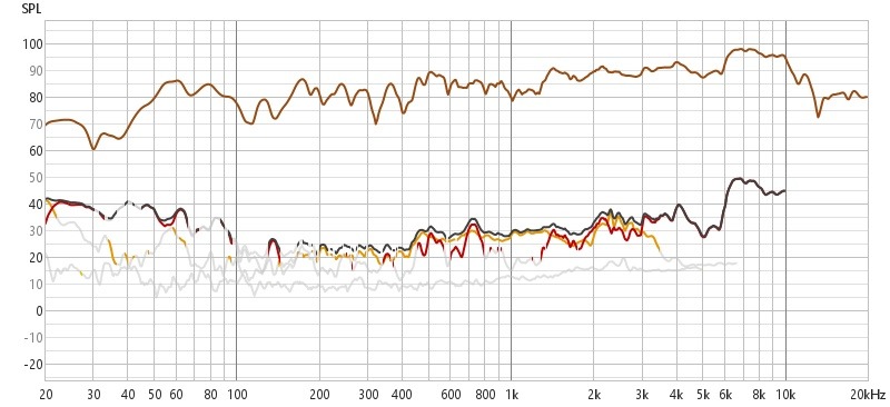

First pic is on-axis and Hor 15 angles of undamped basket:

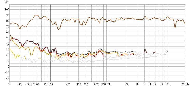

Pic 2: Damped basket Hor 0 and 15

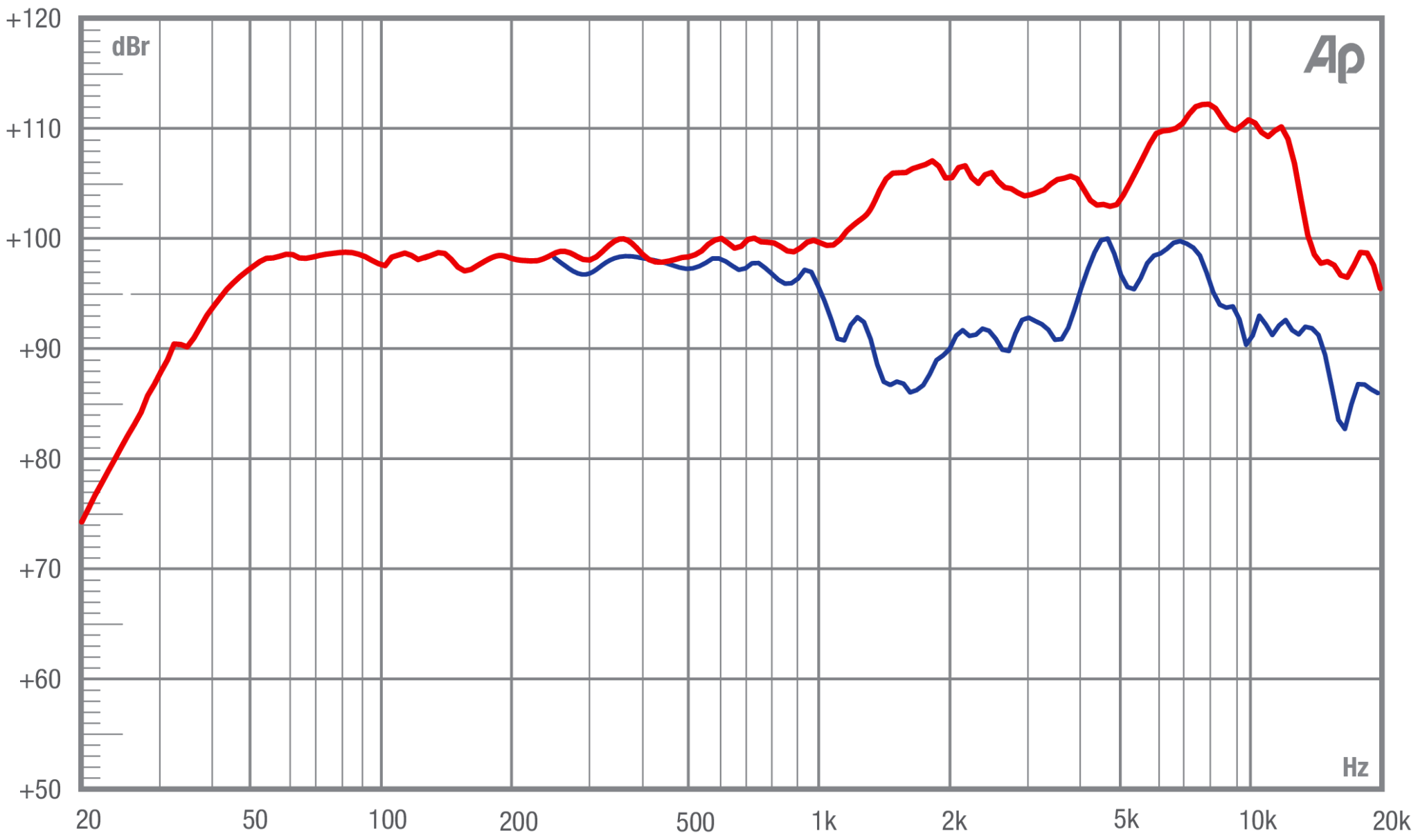

Pic 3: Undamped and damped comparison, On-axis / Hor 0

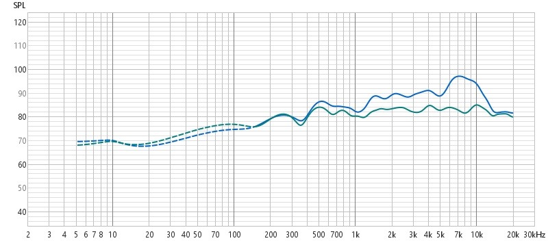

Pic 4: Distortion undamped, Hor 0

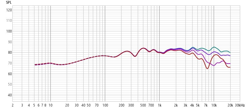

Pic 5: Distortion damped, Hor 0
Pic 6: Damped in different angles
