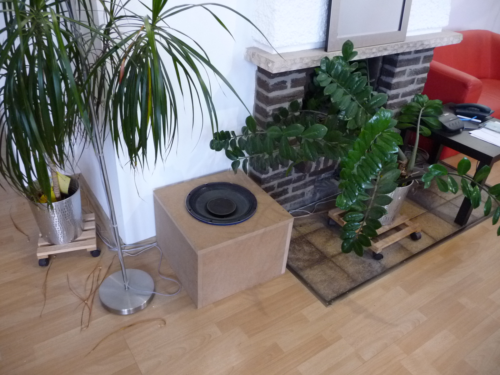

2 x fane 12" (stacked over under).
Box will be 50" tall, 24" wide, and 15" deep.
Basically it's a box 15" x 24" x 39", but raised up 11" so between 2 drivers at ear seated level.
Top driver 1" from top and 1" between drivers.
I've spent time lately with single fane run wide open with 80hz @6db ppsl sub.
![](https://i959.photobucket.com/albums/ae76/fullrangebates/fane%20next%20to%20sub_zpsdxauibei.jpg)
The bump at 125hz smooths out nice now that the box isn't on the floor.
Strange that voices localized to the floor when box was under tv.
Maybe tweeter basically touching screen is needed for Mcgurk effect.
Before with the 150hz 24db LR crossover, 20 seconds into ELO "Evil woman" it sounded completely wrong on the drum hits (going lower and lower).
https://www.youtube.com/watch?v=R20f-TPKjzc
Single fane run wide open does well overall but breaks up on newer dance music.
The droning bass notes cause the fane to distort badly.
Tracks 1-8 hung in there fine.
but track 9 "Turn down for what" was a mess.
Pharrell Williams, Katy Perry, Aloe Blacc, Avicii, Bastille, Lorde, Bruno Mars, Miley Cyrus, John Legend, Various Artists - NOW That's What I Call Music Vol. 50 - Amazon.com Music
Otherwise, lately great for Jefferson airplane/starship, ELO, L.L Cool J greatest hits, and "Home" movie.
I can't believe my wife agreed to this beast of a box, luckily she enjoys music also.
I am blessed.
