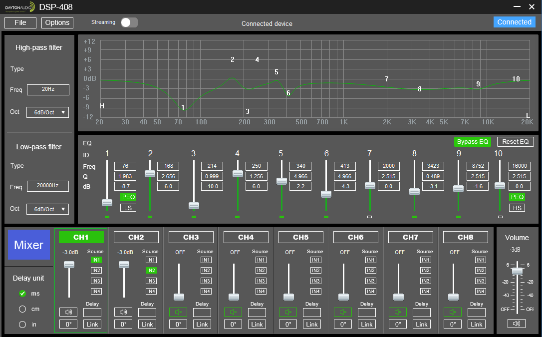

Dayton DSP 408 received, nice little box, seems to be well made, silent and good preamps (with EQ flat, I don't hear any difference with or without the DSP).
First, the beginner mistake: not a good idea to "flat" the whole 20-20K band 😱
It sounds dull, muffled.

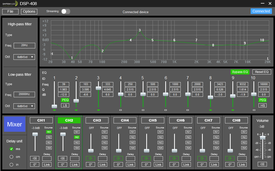

Second try, which immediately led me to the following conclusion: why didn't I buy a DSP before 😕

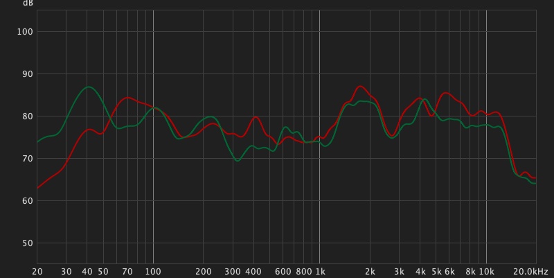

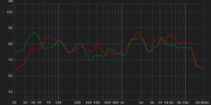

REW screenshot of left channel (red) and right (green), umik-1 at listening position (about 3 meters) before EQ.
Speaker enclosure was a mistake, I wanted to try a small one (95L, 60cm x 60cm x 30cm), a lot of damping inside helped.
And screnshots of Dayton DSP 408 software.
I am a beginner so EQ is probably not optimal from 1K-10K range.

Been there too, equalize for on axis doesn't cut it. The off axis behavior of the Fane is very complex.
What I'd do, if I ha a DSP: certainly notch out the 1.7kHz peak, also cut a bit at 4 and 6.5 kHz. These are resonances in the most delicate area of hearing, thus need attention. Equalizing the balance in the 400Hz and 5...13kHz ranges seems appropriate. Otherwise, add some broad EQ to taste...
I enjoy my stuff currently just using tone controls. Being aware of the limitations of that approach, I actually did not clearly notice the 1.7k bump until a few days ago I listened to Jennifer Warnes' "Famous Blue Raincoat" album, in which she hit that area well...
