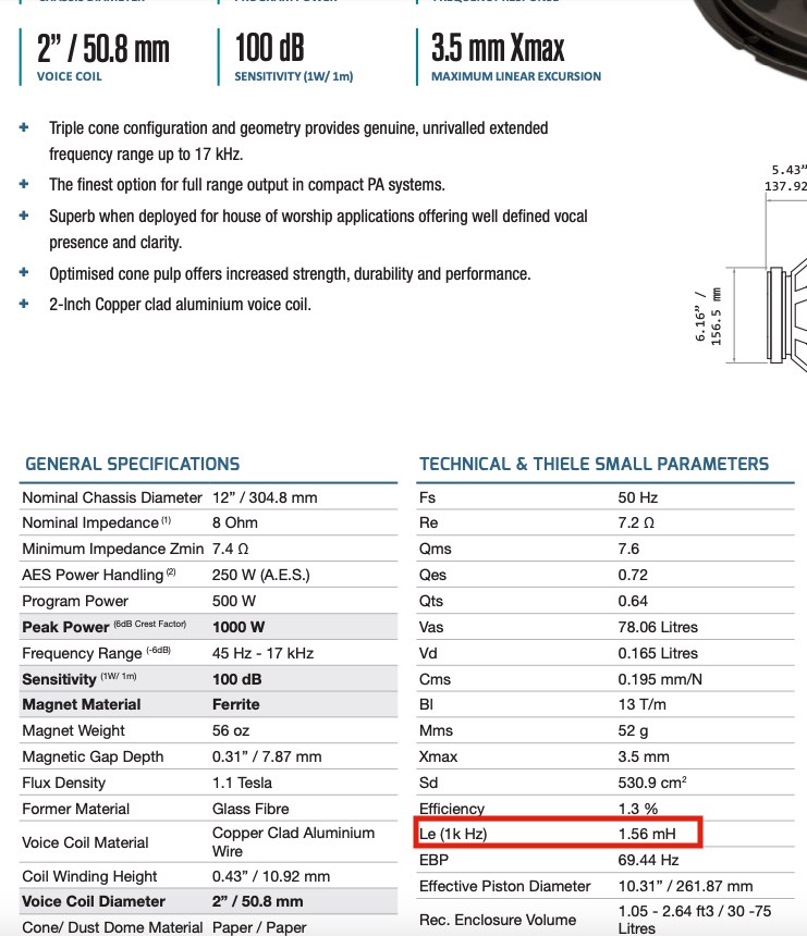

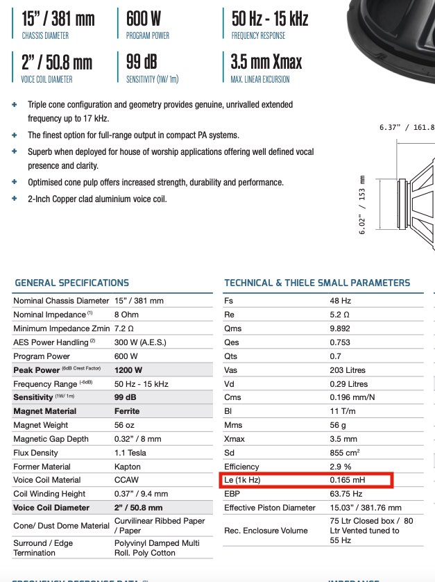

Can anyone explain to me how - 12 inch driver has Le - 1.56mH and 15 inch driver Le - 0.165mH?
Is this a typo?
Decimal point shifted by the look of it.....
Probable. I once set up an equivalent network for the 12-250TC in VituixCAD and the main inductor came came out at 0.16mH for the best curve fit with the catalog curve.

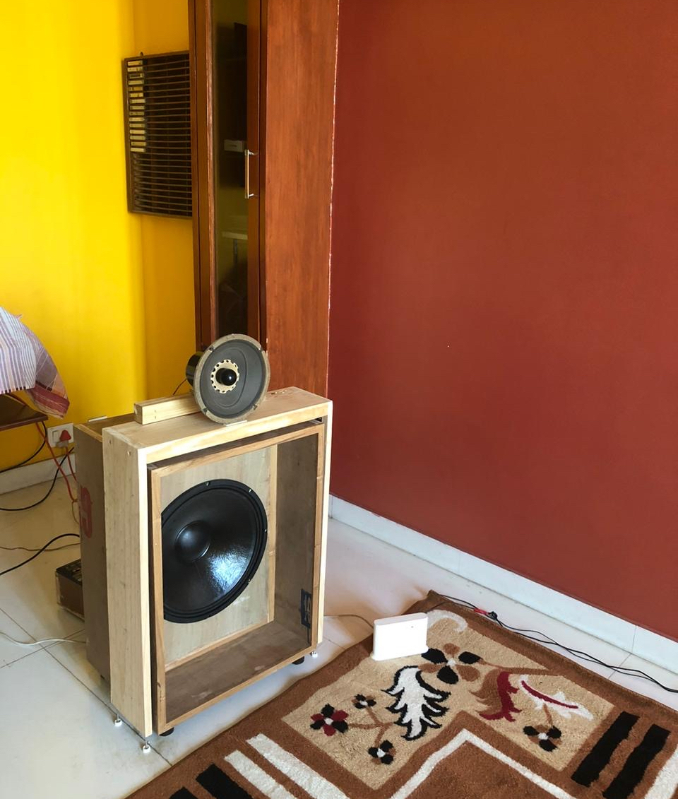

Out of curiosity, my current iterations are also FR without any baffle at all. The bridge over the H frame isolates the FRs from bass vibrations.
To my surprise the FR sounds full bodied and NOT thin. The FR pictured is not Fane but another FR as I am enjoying FR rolling too. FR runs from tube amp and woofer from solid state. Sounds very musical and extends under 40Hz. Woofer crossed at 125 Hz but still the whole setup sounds very nice and coherent.
All my FRs are high dB rating and high Qts.
