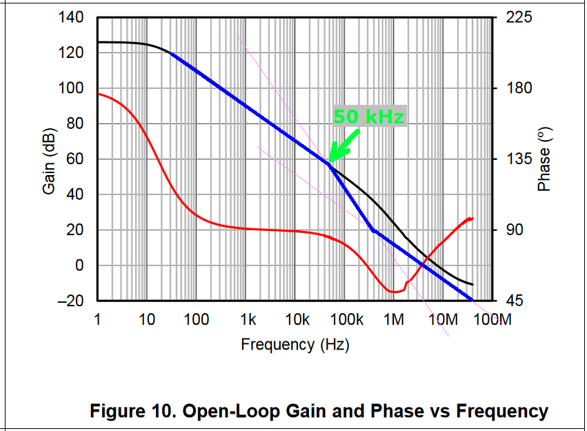

The OPA1622 is an op amp, and like all op amps, a stability analysis is part of doing a proper circuit design, especially in applications where a capacitive load may be encountered. Does it have higher capacitive load capability than many other op amps? Yes. Will it be stable under all circuit configurations and load conditions? No.
There's dozens of ways to stabilize op amps for large capacitive loads, pick your poison. I prefer to keep the circuit output impedance as low as possible so I usually default to increasing the circuit noise gain (effectively decreasing loop gain) well outside of the audio bandwidth. But there are plenty of methods.
The Precision Labs series of videos on stability is an excellent resource if you would like to know more: TI Precision Labs | Precision Amplifier | Amplifiers and Linear | TI.com

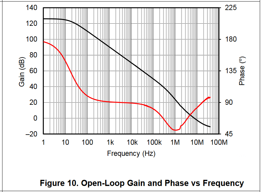

Could you draw that please? I've provided a blank drawing canvas as Figure 1.
When I try to draw it (see Fig 2) and I select "well outside of the audio bandwidth" to be 50 kHz, the result -- plotted in blue -- doesn't look significantly different from the original. What am I doing wrong?
The -20dB/decade and -40dB/decade slope reminder lines are shown as faint pink

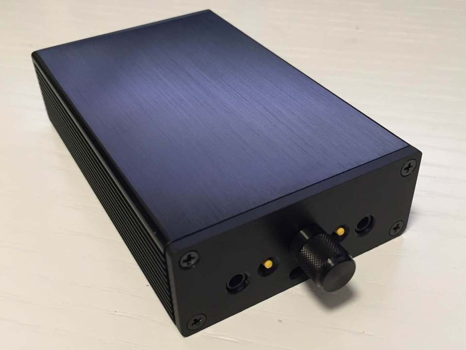

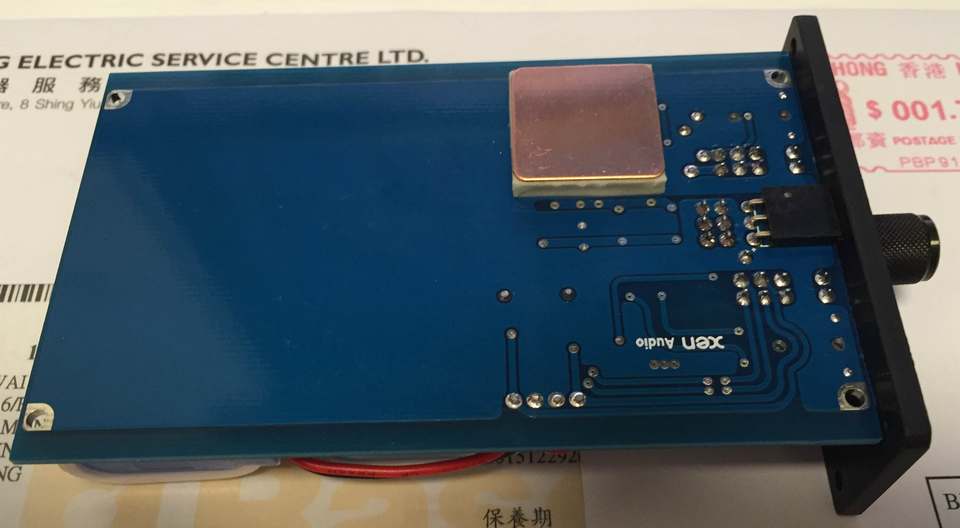

The mechanical parts completed our OPA1622 build.
You can see the thermal flex-pad at the bottom of the PCB directly below the OPA.
This allows a very direct thermal path to the aluminium case extrusion.
Patrick

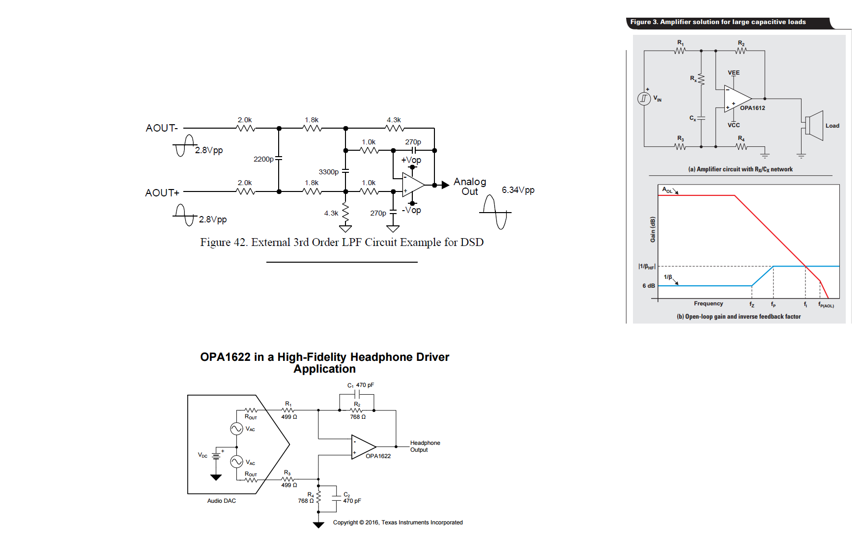

What kind of output filter do you suggest for OPA1622 opamp and AK4490 DAC.
What voltage do you suggest to supply opa1622... output load will be 15kohm shunt attenuator.- What is the best output isolation resistor value?...or no resistor?
Below are 3 choices for output filter... if anybody has better to suggest i will be very grateful and thanks for your help.
In that application I think a 100 Ohm constant impedance attenuator would be the best. The opamp will drive it nicely, a bridged T with a 100 Ohm load at the destination for the cable will match the cable impedance (if it has any remote importance) and the noise contribution will be very low.
I'm attaching a circuit I have used successfully for Vout dacs that addresses the out of band issues of opamps successfully. The circuit would need revision for a more normal opamp not driving a balanced load.
