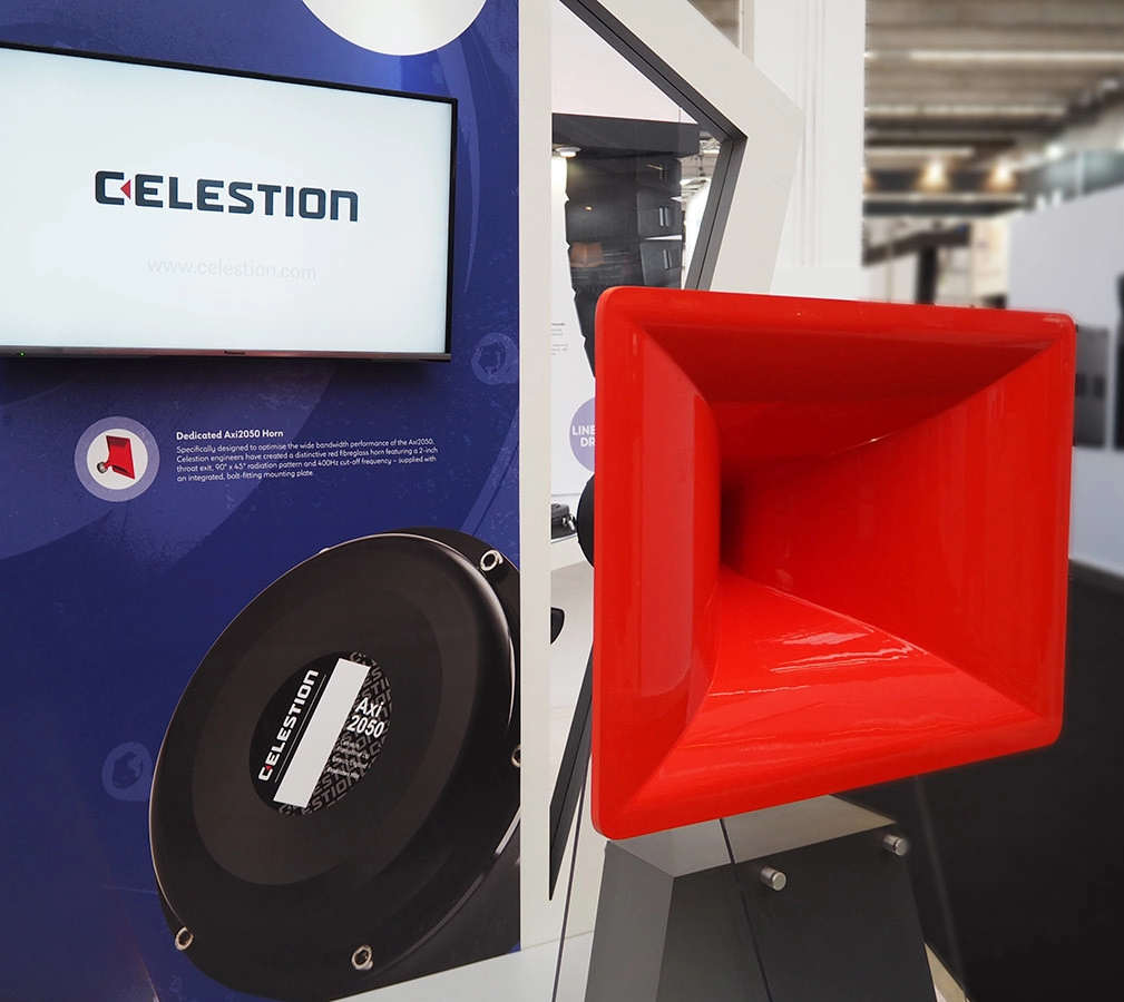

FWIW (taken from audioXpress):
As Celestion engineers explain, the company created a bespoke horn specifically designed to work with and optimize the wide bandwidth performance of the Axi2050. The uniquely designed “Big Red Horn” that appears at Prolight+Sound 2019 has been constructed using a distinctive fibreglass compound in Celestion red (other colors are available!) — features a 2-inch throat exit with a 90x45 degree radiation pattern and 400Hz cut-off frequency.
“Celestion are displaying our “Big Red Horn” with the Axi2050 at our stand at Prolight+Sound, as testament to our horn design capabilities,” explains Managing Director Nigel Wood. “Having personnel experienced in horn design on our team, and developing software to augment this capability still further; we have the know-how to offer in-depth technical support for horn and waveguide design to our OEM partners.”

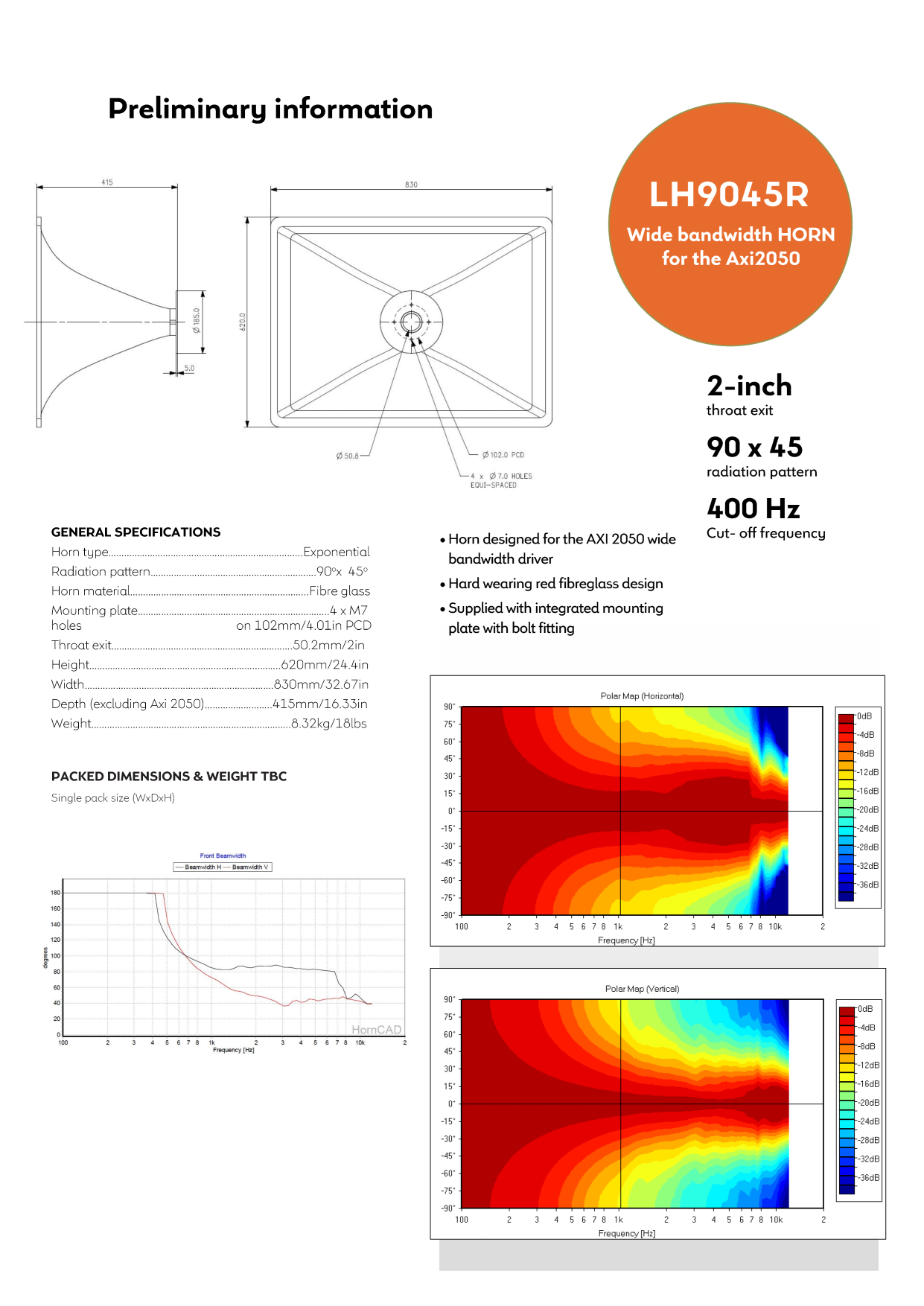

Very surprising to see such a large new design. But it seems that as usual directivity is the major design goal. The pictures look like a very pronounced diffration zone. This reminds me very much to the Selenium 90x40 horn which has a similar zone and cut-off.

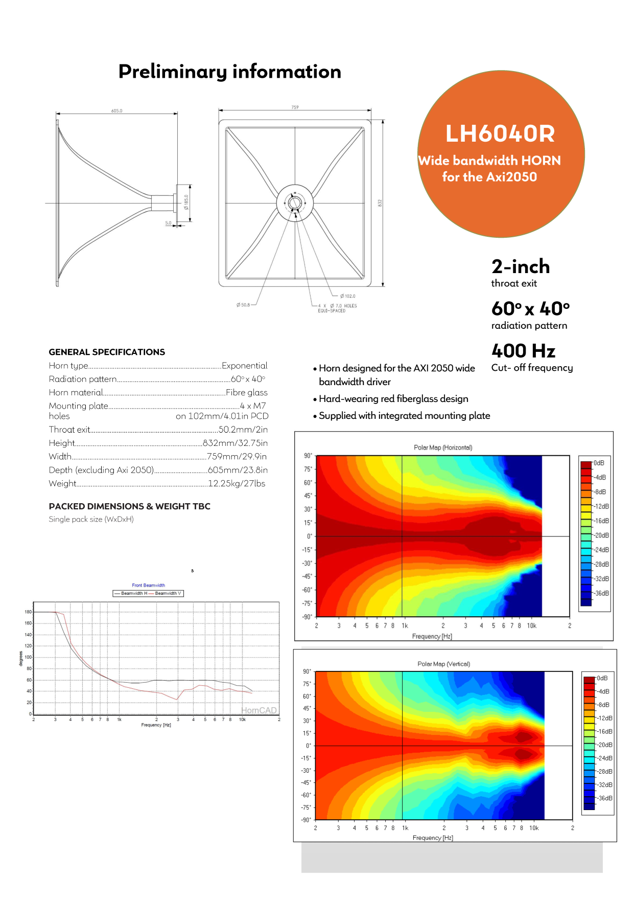

We Do not know what horn was used during the measurements and what kind of smoothing was applied. A datasheet should contain such Infos.
Most datasheets do not contain these infos (smoothing, measurement enviroment, even if they should). The used horn should be mandatory though.
But you can tell by the remaining 'squigglyness' between 900-5kHz of the plot there wasn't heavy smoothing involved.

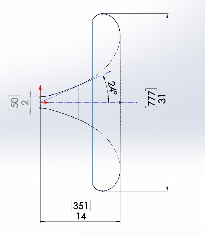

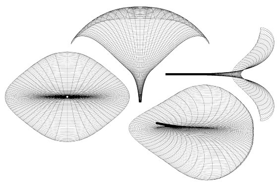

Maybe we could make something new refreshing, transparent horn or waveguide like Ferguson Hill? I'm limited to 900x1900mm.

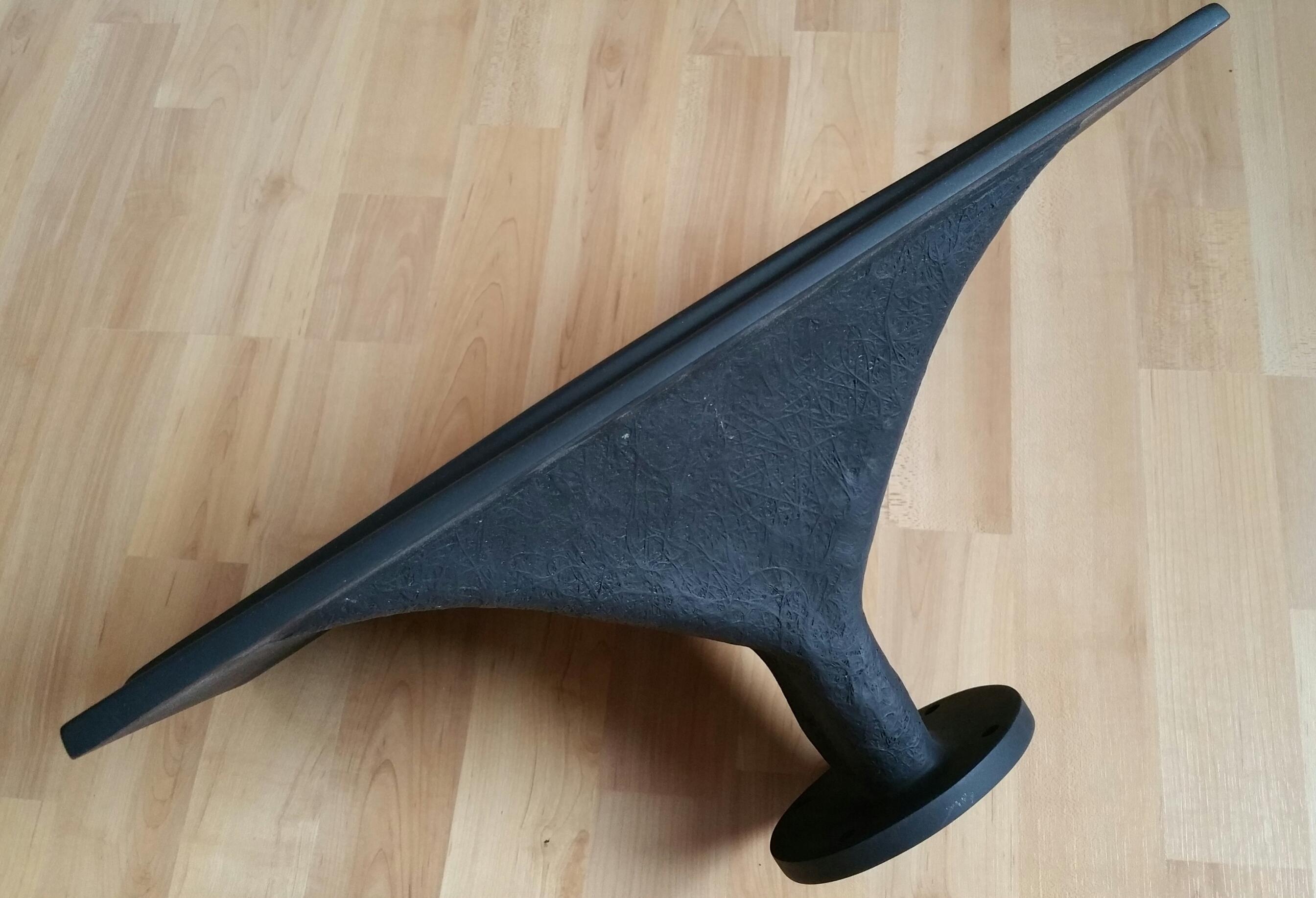

Some real oraganic looking shapes...
Just about anything you make will probably work(and look) better than their horns.

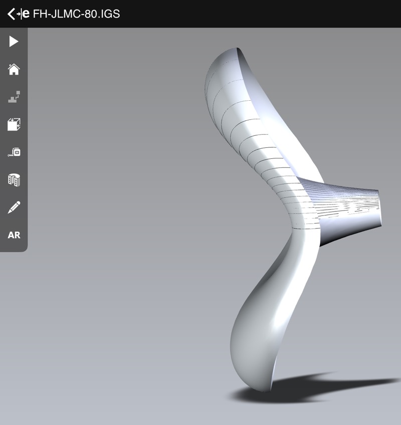

First is FH-JMLC 80Hz corner horn calculated by JMLC for 160mm throat.
Second is Dr. Keele style CD-JMLC 400Hz horn (rather for CNC wood or 3D print only).
Third is 2" OS-JMLC hybrid.
I'm thinking about MLTL Eminence 3012CX or unity variant. Hoping folks from ABEC thread could help. Could be also something like dual OB horn or Bipole (rear tweeter delayed) - like Manger Diskus but waveguided.

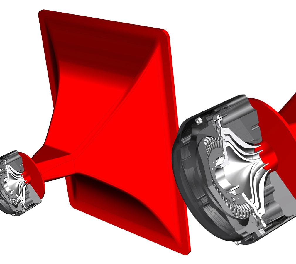

Also the 90x45 has some issues after 7Khz.
well, yeah its a 2" horn. 7khz = 1,93" wave, then it collapses. you just dont see it as much with a shallower despersion horn.
