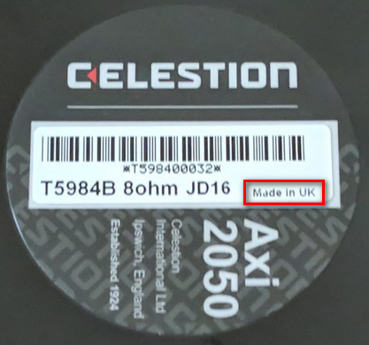

Time to awaken this thread, I got myself a pair of these drivers first horn on the list is a TAD TD4001 clone

Thanks Rob. I wonder what happens past 12 kHz?
That is pretty much beyond 'the vocal range' for which the Axi2050 was intended, so maybe Celestion didn't consider it relevant

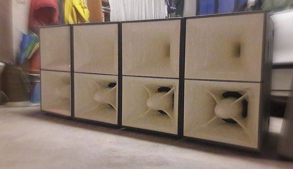

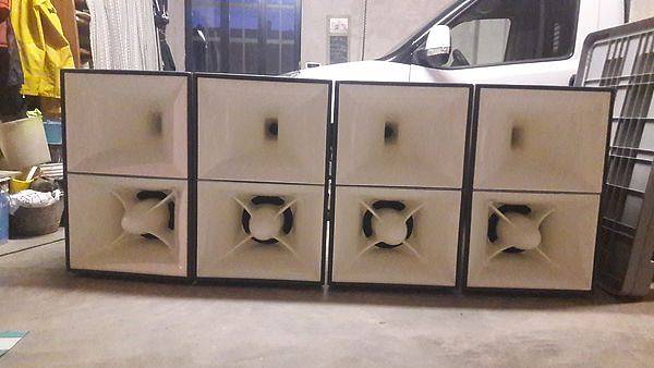

While I was searching for the origin of some good ol' fiberglass diffraction horns that I've bought, I stumbled upon some Outline horns that look quite similar to the Celestion LH9045R.
The Outline horns are a bit smaller though and 60x40.
