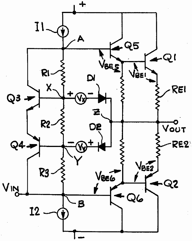

Steph_tsF: I also had the same thought many times.
This was the simplified version of Pass' circuit from his patent.
At first glance, looks very similar to mine. But Pass' load isn't
forced to use only the diode path, so not sure how he keeps
a reactive load from sometimes depleting the emitter reserve?
Whatever else: even in simplest form, its more parts than I'd
ever throw at it. Still want to work up a sim of this one to see
if it might actually perform better in some subtle way I did not
expect???
I think crossing here is still shaped by the log law of emitters?
I'm not entirely sure yet if his quasi-complimetary diodes are
the primary shapers? I do see he sticks yet another diode into
parallel with some of his emitter resistance in Fig 5. Maybe to
do some shaping? Would have been redundant in my scheme...

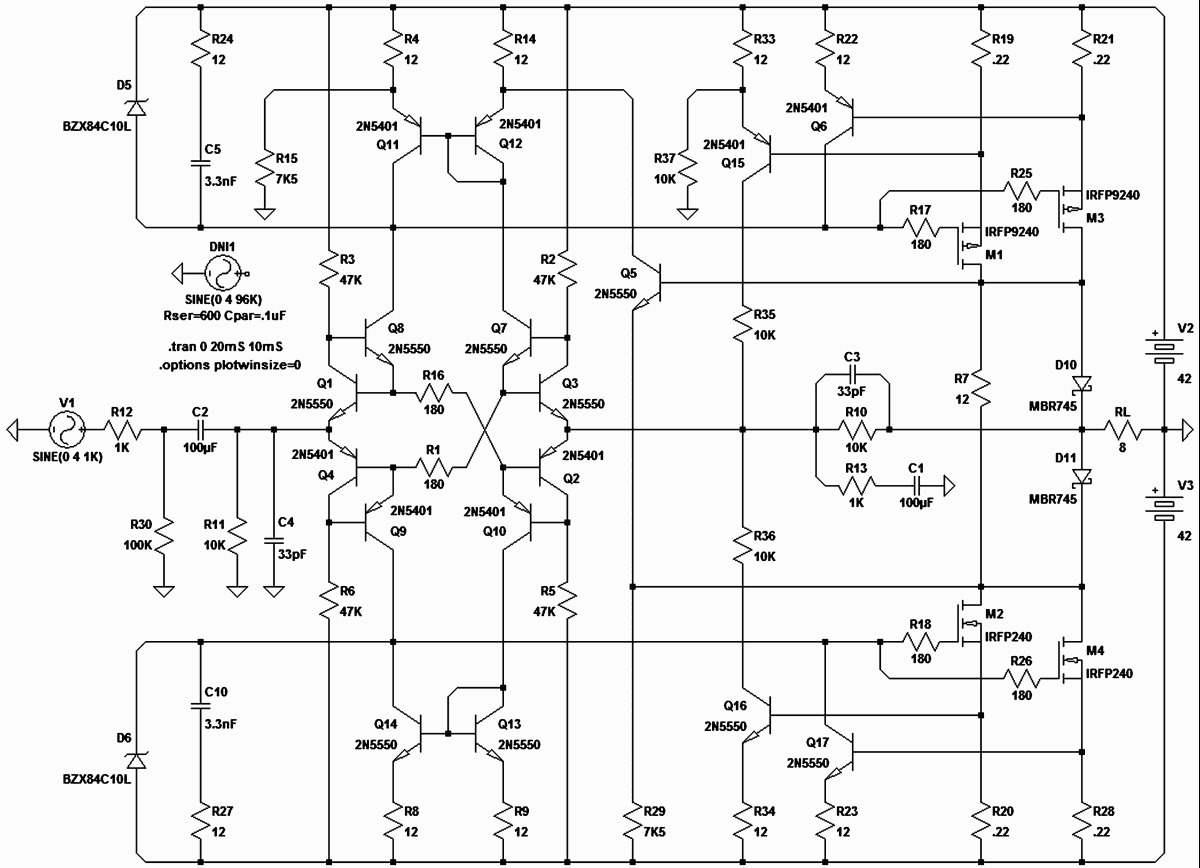

I don't have AES access, but I've reviewed the patent numbers
given so far, and don't yet see an overlap with the circuit I am
proposing.
The Thornton Patent 4160216 uses diodes for commutation, and
all output currents must flow through those diodes, thus output
can't source or steal away the reserve current set by either CCS.
Only this much prior art seems at all similar to what I'm thinking..
From here, we see that I simplify to a single resistor as a current
source. But more importantly, we see that Diode curves control
the crossing shape, and power device curve is almost irrelevant.
Thorton's emitters participate in series with his diodes to shape
his crossing. My emitters (IF BJT are used here) don't.
Underbias voltage across the diode stack is held to a constant.
And bias voltage across power devices is not held to a constant,
but slave to whatever satisfies the diode stack rule. Nothing in
Thorton's patent goes quite this far.
Thats weird, and unique, and not prior art. And IF it turns out that
nobody else holds patent before I published to this public domain,
then its gonna be real hard for them to pull the rug out from under
our right to use it. And I am giving right now my written permission
to everyone: use this any way you want, commercial or whatever.
Thats a big "IF", cause there may be patents I don't know about.
Until we know, I may not have any rights to give that permission.
My input stage is weird enough, I highly doubt its covered either.
but someone ought to check to be sure, before you build for profit.
The soft current limiter is Keantoken's idea. I don't know if he's in
the loop on this thread yet or not?
How sensitive is it to device - device variations ?
Like I said: let cold Schottkys do the thinking, not hot power devices.
Exactly the reason I don't think any of the patents above could apply.
They still depend on "complimentary" power devices, I don't.

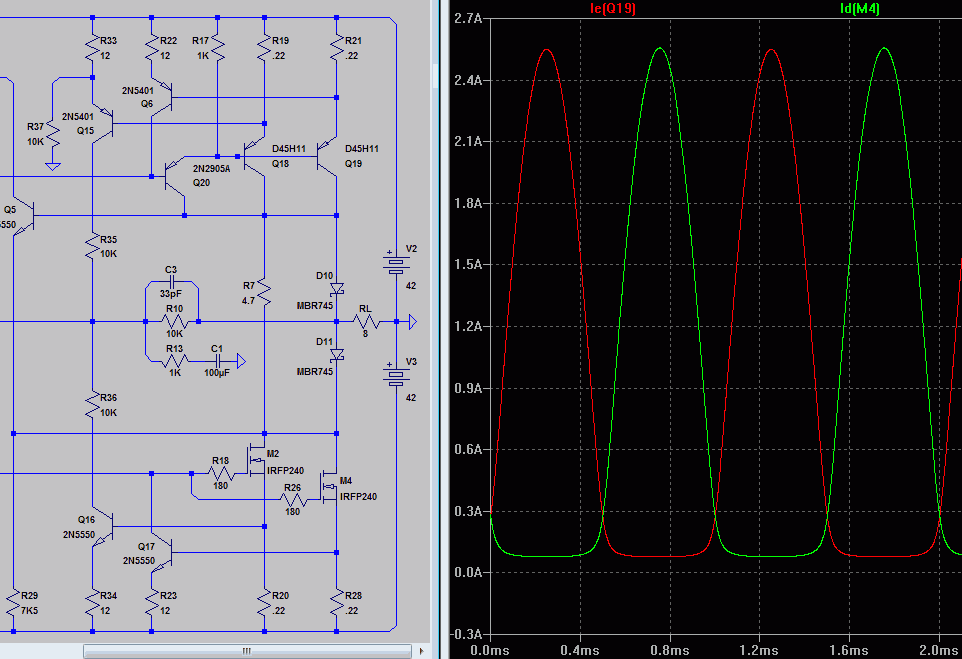

Exactly the same sim as before, except: BiPolar PNP sub'd for P-CH...
Only the two Schottkys really have to match...

I the idle current on the input transistors so low that high input impedance is asured ?
What? No.. Impedance is actually kinda low. About 7.5K looking into the input.
I was only shooting for an extreme low offset, and no patent infringements...
You are driving through emitters, you will see both 47Ks on the collector ends.
The first tansistor is transparent. Its the next transistor the real one you are
driving. But this trick makes it look like a depletion mode device of very very
predictable threshold. Though input impedance surely not its strongest merit.
Sure, you can sub conventional complimentary LTPs, might work even better.
But then you right back in the land of ordinary, and maybe even infringing???
Input stages are a quagmire of inspiration stifling old patents too... You really
want to open that can of worms?
I could Muntz this down till it looks like Zen + Aleph and a pair of diodes...
But what fun would that be? And then would Nelson let you sell it?

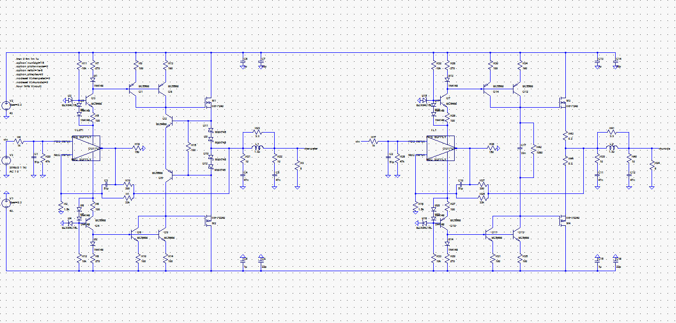

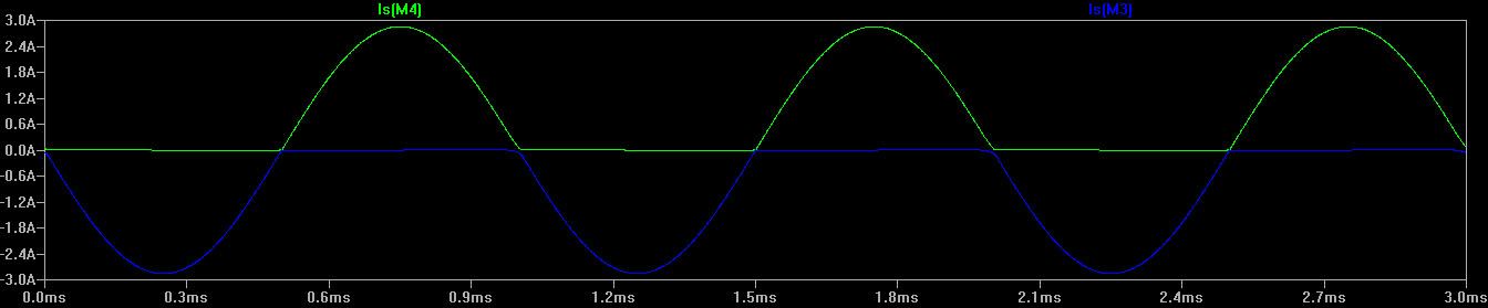

here is a test bench under LTspiceIV about kenpeter class AB Soft Non-Switching showing excellent results. See the .zip file. The idle current is about 300mA. How to reduce it ?
