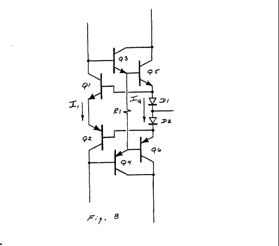

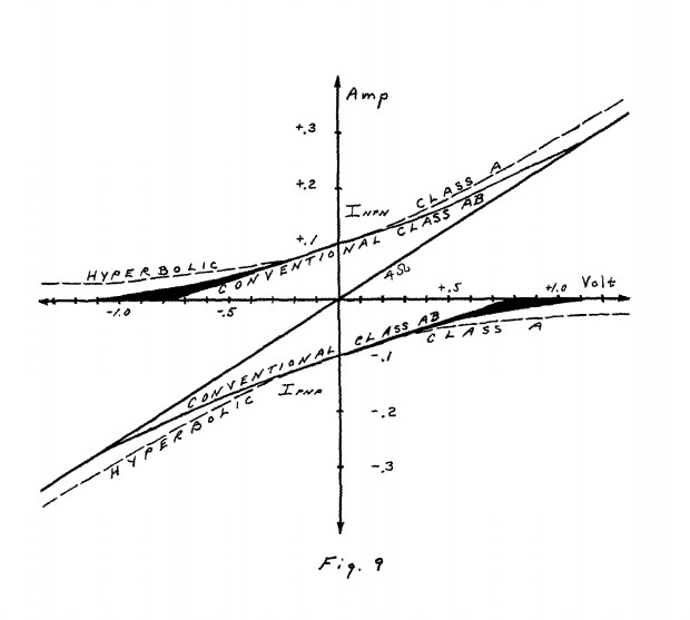

Could it be that kenpeter arrangement is in the same league as Dodson "Quasi-Class A / Improved Class A Bias Loop" presented at the AES 67th Convention in New-York ?
See AES E-Library: Quasi-Class A/Improved Class AB Bias Loop
See attached pictures.

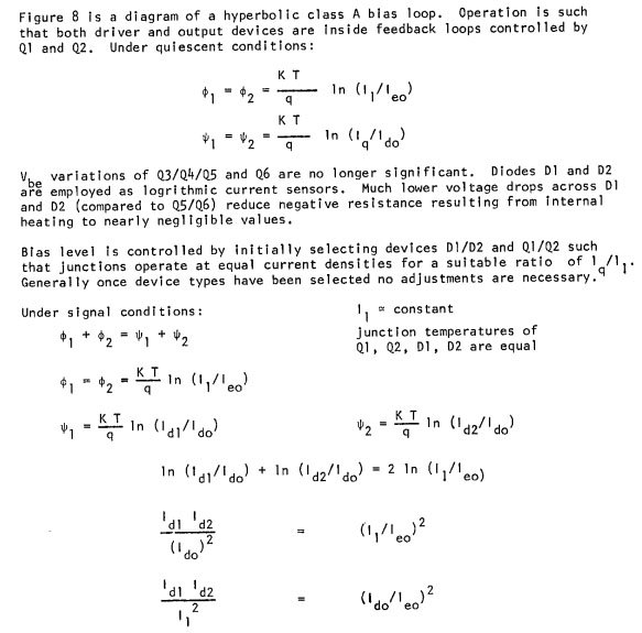

"Figure 8 is a diagram of a hyperbolic class A bias loop. Operation is such that both drivers and output devices (Dodson is talking about a Darlington output) are inside feedback loops controlled by Q1 and Q2".

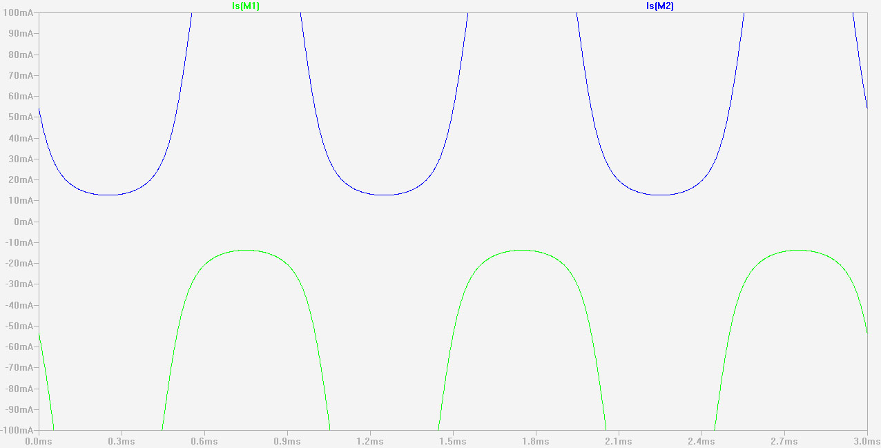

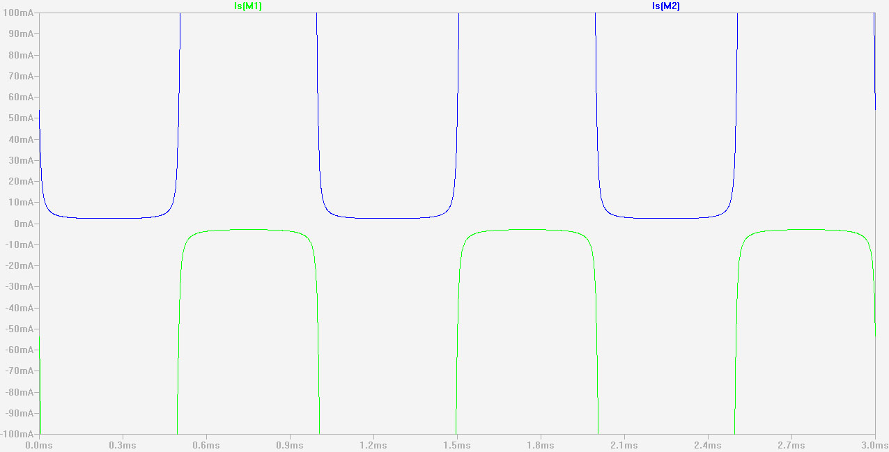

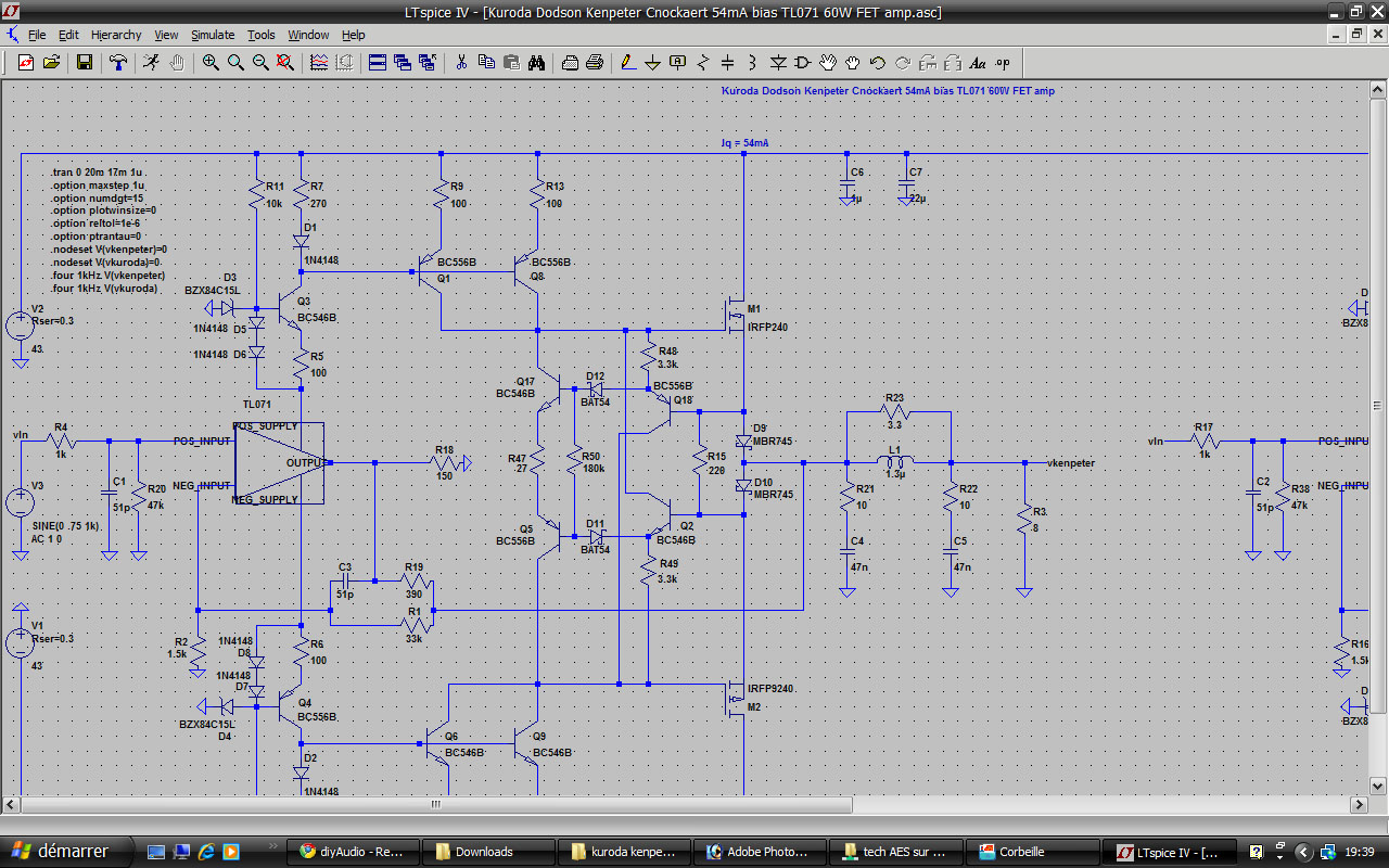

Here is a Kuroda-Dodson-Kenpeter-Cnockaert (KDKC) soft non-switching audio power amplifier with vertical MOSFETs biased at 54mA, and still Soft Non-Switching when delivering 60Vpp on a 8 ohm load. See attached pictures.
I made all base-emitter and Schottky junctions compensated. This allows setting the vertical MOSFETs bias current anywhere between 25mA and 999mA. All junctions being now compensated, one may expect a decent thermal stability. The servo-bias loop gain is now adjustable using the emitter-emitter resistor. The bigger the resistor, the softer you get the Non-Switching crossings.
Such circuit behaves gently on simulation.
The Kuroda used as reference is tricky regarding the Vbe multiplier. Of course it is not a Non-Switching circuit. The size of the decoupling cap (4.7 µF here) is critical. A smaller value like 220nF enables a fake Soft Switching, and you will see the fake by walking the current probe in the circuit, comparing the NMOS and the PMOS source currents. If you put a 47µF cap (and allow enough settling time for the .TRAN simulatoion), the fake will vanish, you will get a crude hard-switching, and you will see that the VAS current is enduring serious spikes at crossing. That's precisely and typically the illness of any "improved" Kuroda using a Vbe multiplier instead of a dumb resistor. The original Kuroda is using a dumb resistor, generates less spikes, is not a Non-Switching, and fakes (to a less extend) some smoothness when crossing.
The KDKC arrangement combines the following advantages :
0- No unobtainable nor expensive nor soon obsolete parts,
1- It eradicates all kind of crossing spikes without relying on timing capacitors,
2- It can be configured anywhere between a pseudo class-A (say 999mA Iq) and a pseudo class AB (say 25 mA Iq),
3- It is a true and guaranteed Soft Non-Switching amp, provided one properly defines the max current he is supposed to deliver, but the issue of a complex load needs to be assessed - see Benjamin AES paper about the V-I locus issue,
4- The adjustable servo-bias loop gain can be adjusted for setting the class profile anywhere between a super-soft pseudo class A (low servo loop gain, high Iq), to a mild-soft non-switching class AB (high servo loop gain, low Iq).
5- The adjustable servo-bias loop gain can be adjusted for tailoring the frequency spectrum of the individual MOSFEts source currents, a low loop gain enabling a monotonic decreasing profile of harmonics.
6- Current feedback topology (known for delivering adequate slew-rate)
7- Use the opamp of your choice, as front-end
A KDKC amp printed circuit, routed using the findings of Ed. Cherry "A New Distorsion Mechanism in Class B Amplifiers", AES 1981, would be interesting. Especially when setting it up for different class profiles, and using different audio opamp as front-end. That's bulletproof for the future.
Anyone interested ?
Steph

Dodson Hyperbolic class A & Improved class AB - AES cover.jpg78.2 KB · Views: 1,395
Dodson Hyperbolic class A & Improved class AB - fig 8.jpg33.1 KB · Views: 1,440
Dodson Hyperbolic class A & Improved class AB - maths.jpg84.8 KB · Views: 1,391
Kuroda Dodson Kenpeter Cnockaert 50mA bias TL071 60W FET amp - schematic.jpg346.7 KB · Views: 1,455
Kuroda Dodson Kenpeter Cnockaert 50mA bias TL071 60W FET amp - soft non-switching 3Vpp 8 ohm loa.jpg87.2 KB · Views: 889
Kuroda Dodson Kenpeter Cnockaert 50mA bias TL071 60W FET amp - soft non-switching 30Vpp 8 ohm lo.jpg77.4 KB · Views: 414
Kuroda Dodson Kenpeter Cnockaert 54mA bias TL071 60W FET amp.zip507.7 KB · Views: 309
Dodson curves on his diode. But what makes reserve current for the power device?
R1-Fig8 only seems to grant reserve current to the front transitor of the Darlington.
Is Dodson using Schottky or junction diodes here? The curve shapes are different.
If junction, might need careful regulation over the quiescent current at crossing.
OK, in the text snippet, he sais his diodes are using the Log law, so not Schottky..
If Dodson holds a Patent, I might not be able to squeak around that one. Mine is
slightly different, but is it enough different???
Nobody's mentioned "Erik Margan".
Regards Max Albin
Browsed the table of contents of his book "Wideband Amplifiers" on Google.
I did not see anything regarding push-pull. Just a whole lot of single ended.
am I looking to the wrong reference? Or is it buried in the text without any
specific mention in the table of contents?
Steph, what kind of voltage swing do you get out of that arrangement?
I had mine turned inside out for reason of not needing any bootstraps
nor high rails to drive the full swing. Well, 40V of 42, almost full swing...
You get less and less Voltage into 4 and 2 ohms, but that just the soft
current limiter's knee bending over at around 6A. You asked for 5A, I
don't see that happening into 8ohm unless you can swing at least 40V.
I like your expanded diamond in the center. But you gotta watch that
doesn't freak out, should it reach either rail. A pair of voltage dividers
to GND could prevent that ever happening. Even my inside-out driven
probably needs that modification too, gets wiggy when you approach
the current mirror emitter voltage, significantly less than full rail.
Maybe then I could squeeze 41 out of it? Need a volume knob to 11.

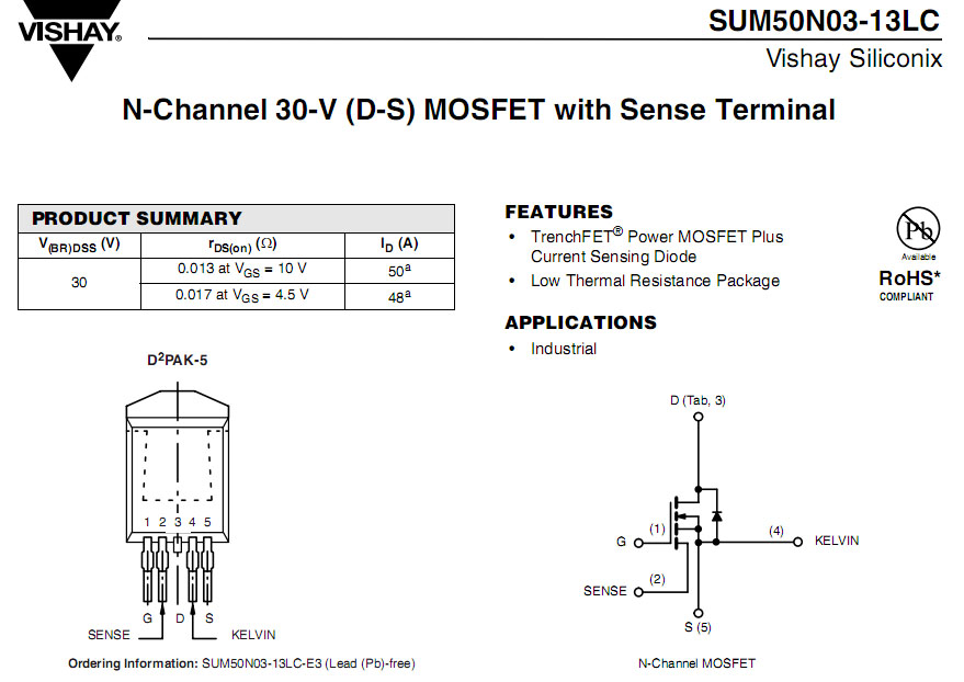

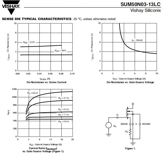

Hello, there are MOSFETs having a 4th pin called "Sense" and a 5th pin called "Kelvin".
See attached pictures. What if we put a small signal (cold) Schottky diode in series with the Kelvin terminal ? The Sense terminal voltage would then become the input of the Dodson-Kenpeter bias feedback arrangement. And no power lost.
Is the Sense output current temperature-dependent when connected to the Kelvin terminal ? Does it degrades if there is one cold small signal Schottky inbetween ?
I would like to simulate this. Is there a model available for I-sense MOSFETs ? Can somebody help me build one, if not available ?
Steph
Steph

My schematic above, for those too lazy to open LTSpice...
1st proposal: Up for comments, suggestions, dirty jokes...
I'm rather proud to see it swings 40V with only 42V rails.
Beat it or join it...
Miller effect in the CS output stage will kill you, especially since the gate-drain capacitance is highly nonlinear in the MOSFETs, and gets to the range of 500-1000 pF at Vgd around 1V. If you "forward bias" the gate-drain electrodes (gate voltage more positive than drain voltage on an N channel device) the capacitance skyrockes further. Take a look at the IRFP240 datasheet.

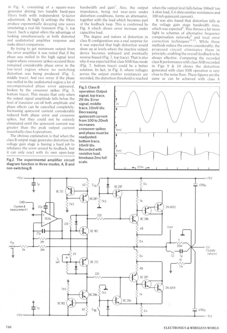

At fisrt glance, the Ben Duncan books looks quite general. Digging into the individual chapters, the big and positive surprise is to realize how precise and accurate Ben Duncan is. The appendixes are unvaluable, plenty of references, plenty of historical info. Many many thanks for pointing this great source of info !
Page 133, about the non-switching amplifiers, it reads :
"This involved a kind of positive feedback, and carrying the risk of blowing-up the output stage ! It also relies on the switching of small diodes, which ameliorated and displaced, rather than overcoming the switching problem".
I guess Ben Duncan didn't wanted to write explicitely that the Technics SynchroBias, marketed as "New Class A", was displacing the problem instead of solving it. The Technics "New Class A" is thus a little bit apart. It should be clear and remembered that JVC "Super-A", Pioneer "Non Switching" and Sansui "Tanaka Non-Switching" are not relying on diodes to be switched.
Bob
I hoped by same mechanism that provides reserve current, I've kept gate
charge from plummeting uselessly after cutoff. I'm aware any drive too far
into conduction or cutoff takes an ever increasing charge to make change
in channel current. Is this the same hazard you warn of? You seem to go
further than this, to warn specifically about when Drain is less than Gate???
It plots a pretty decent almost rail to rail sine wave at 96KHz in the sim.
You suggesting a capacitive challenge LTSpice has not accounted for?
This effect is not represented in the model?
Its no big deal to make a change to bipolar, if that would work better.

I don't see anything bout what happens to gate charge
below VDS<40? Maybe you got a more complete version
of the spec sheet than the one I'm looking at??? The
trend in Fig 6 almost seems to suggest Qg goes down
slightly as drain voltage decreases from 160 to 40, but
that makes no sense, or does it??

Your datasheet says 1300pF for VDS 25V and Vgs 0V..
I suppose that Bob did made some real world measurements..
