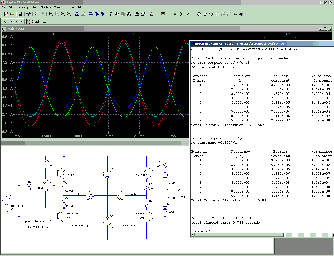

I was thinking of building something similar to the attached schematic.
D382 to D385 would all be the same diode type, see attached FYPF1545DN diode datasheet (they are available from mouser).
Since they are in a plastic package, D383 can be bolted directly to D384, and D382 can be bolted directly to D385. This should provide good thermal bias stability, with no need for mounting any of the diodes on a heatsink or messing about with thermal washers.
Also, since all the diodes are the same type, and because the 4 diamond transistors are of the same type, a reasonably dependable, thermally stable automatic bias current is hopefully guaranteed.
Any comments?
Have a look at my diagram, I think you will need capacitor c4 100nf as shown. Without it I get oscillations. I tried running it with c4 set to 10nf and got oscillation that traveled along the sin wave. The amp ran and never broke out into wild oscillations, but, didn't measure well with c4 at 10nf. The oscillation were subtle, had to zoom in quite a bit to see them. I posted other results in a thread called "a different CAS typology".
Ken
Thanks Ken,
Did you experiment with the value of C4 in your schematic above (100nF)? If so, what changes did you observe? Is it present for local loop stability purposes (preventing oscillation) or does it have some other esoteric function?
Also, how does this output stage perform when clipped? Spice suggests it behaves ok with only slight 'sticking' at 20kHz, but how did it fare in the real world.
Thanks for any answers.
Ian
Ian,
Got it to work in real life with 100nf and left it alone after that. It's for local loop stability, I'm not knowledgable enough to be esoteric.
Output stage sticks ever so slightly at 20kHz, nothing dramatic at all.
Ken

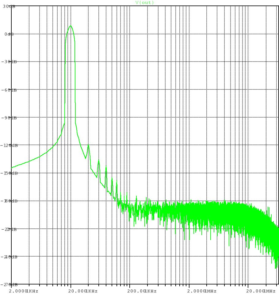

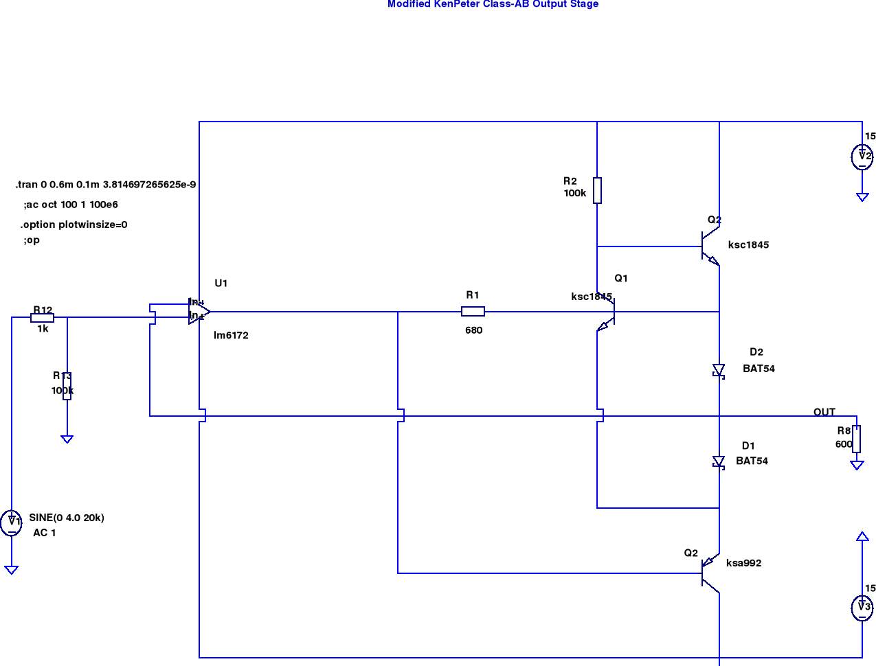

Time to wake this thread up again - I somehow missed seeing it when it was active.
I was looking for a Class-AB push-pull output stage that could be used either in a fully-discrete opamp, or a hybrid-discrete opamp that uses an existing monolithic opamp, driving a discrete output stage. Here's what I've come up with:
1) I started with Ken Peter's single-ended stage - the one on the right side in the attachment to this post:
http://www.diyaudio.com/forums/soli...r-non-switching-need-revival.html#post2147462
No particular reason for picking on this, except that it was the simplest and therefore the most fundamental.
2) Since there's already voltage swing at the output of the opamp, I eliminated Q1 in Ken Peter's single-ended stage, and fed the opamp output directly to the cathode of the lower schottky. It works, but lacks symmetry and was unsatisfying.
3) Added a PNP (at the previous location of Q1) and drove the base of the PNP from the opamp. Works much better, and is symmetric.
4) Added a resistor from the base to the emitter of the PNP, which biases the opamp's output stage to Class-A.
5) (The key improvement here) Combined this resistor with Ken Peter's R2 into a single resistor, which serves to bias the opamp into Class-A, as well as mop up the residual current from the Schottkys. It simulates with lower distortion, but I don't exactly know why - maybe a feed-forward element is at play.
6) Experimentally replaced the current source I1 with a resistor R1 (probably could bootstrap this for better swings). Distortion is higher, but it's mostly H2, so it's actually better.
Here's a sample LTSpice schematic with the LM6172 and my favourite small-signal transistors - it could certainly be optimized further, but it already looks exceptional. With this output stage, a humble TL071 looks a bit like an OPA627. A high-performance LM6172 looks better than any monolithic available now.
Edit: Thanks, Ken! This one obsoletes my existing discrete opamp (LF01..LF03) output stages, and I'm going to be stuck with an inventory of a few hundred bare PCBs. Serves me right for not spending more time at these forums...
  • kp_se_mod.asc.txt

I think assessing the circuit on its own, and associated with a high perf opamp can be misleading.
Here is a fairer comparison with a conventional class A PP, and without the help of external loop gain:
Fair enough, it looks to be Apples vs. Apples with ~4.8 mA quiescent current for both. I'll take another look, but where mine seems to do better is at lower quiescent currents of the order of 0.5 to 1 mA in the output stage, with higher beta output devices. It also needs to be compared closer to Class B operation, with both transistors coming close to cut off.
Also, 1000uF to bypass the Vbe diode chain in the conventional stage is impractical in most cases. 10uF is a typical value.
R2 is neither a CCS nor a bootstrap,
therefore current in Q1 is variable.
VBE of Q1 not held constant.
Does it matter? I dunno...
You have eliminated Q1 VBE resistor,
that was responsible for bleeding a
constant reserve current that serves
to assure output transistors stay on.
A misbehaving load could turn off a
fast recovering Schottky, but would
be unable to shut off either of the
slow recovering output transistors.
OK I see it now.
The top Q2 (why do you have 2 Q2's?)
conducts R1 to U1 as a reserve current.
The bottom Q2 conducts R2 as a reserve.
I probably should go with a bootstrap or JFET instead of R1. The simulated harmonics became nicer with just a plain R1 - from memory, H2 increased.
I merged that resistor with another that was intended to bias the driving opamp into Class-A. It works, but maybe the value needs experimenting with.
Sorry, the lower one should be Q3.
I goofed while relabeling the Qs before exporting the schematic (they tend to start with numbers like Q11, Q13, etc. because I sometimes cut them down from some larger circuit like a discrete opamp, and I relabel them left-to-right, top-to-bottom for convenience. LTSpice catches these duplicates, but only if a simulation run is attempted.)
