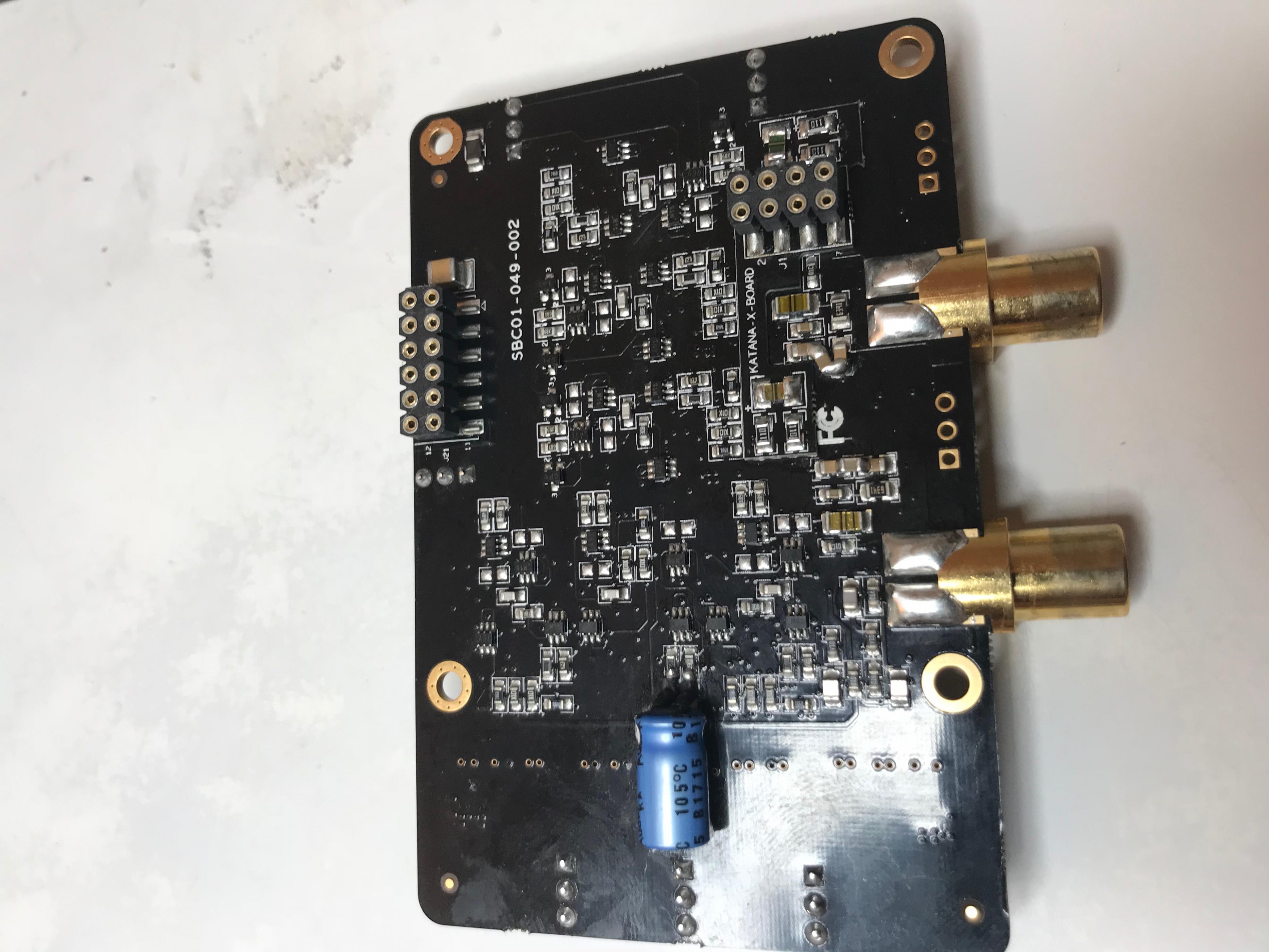

Hi cdsgames,
I just received my SQ output stage...
But I think this is one with the faulty connector...
My order is 4458
Thank you for your help.
