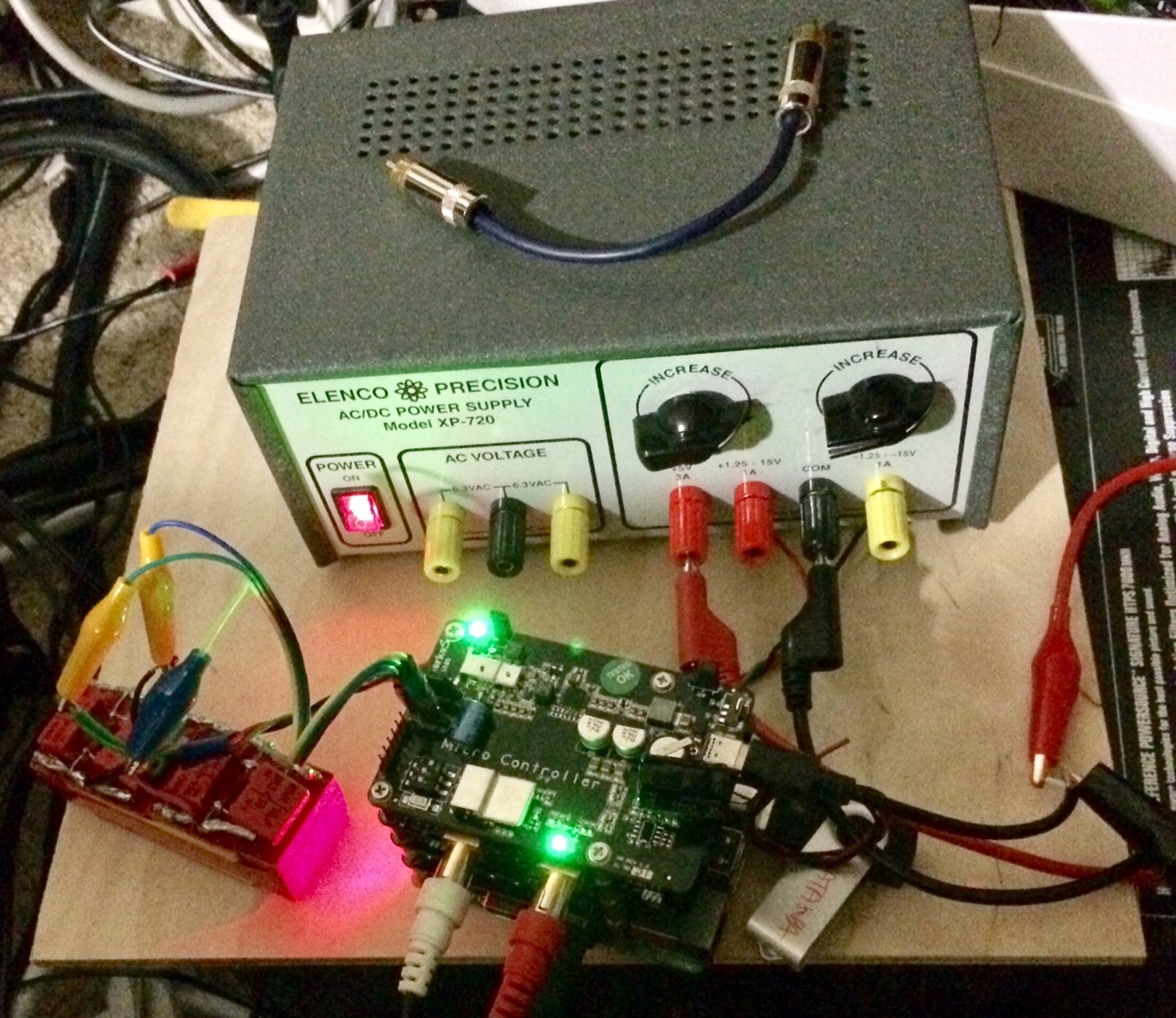

My Katana DAC stack, (with Isolator 1.2) and the SQ board is breaking is nicely. I have it hooked up to powered speakers that I use with my HDTV. Music has been playing since Saturday evening . I do power down the unit down for 30-45 minutes to allow to caps to change down and form , giving them proper break in. I have done that once, I am do so shortly again. I use Internet radio stations at low volume and when i want to listen, I use my awesome library. Every with the little powered speakers the SQ is very good.
I have a military grade regulated LPS plugged it to the USB-C port of the MC board. I have the Allo psi plugged into the Isolator board's USB-C connector.
I plan on using a total of 4 LPS (3 units), one has a DYI board with dual halves and a dual winding toroidal transformer.
From what I can tell it this time, the Dual output LT3042 LPs will power the MC board and the karma dac. I plan to use the external connector to power the Katana Dac I have another Military +/- 15Volt LPs for the SQ board and hoping to use pin headers on top of the MC board. For the RPI< I am using my 5 Volt 4 amp Military LPS. I know I can use the USB-C on the isolator board yet I believe connected the LPS to the bottom of the RPI with solder is superior.
What do you all think I my plan?

Military power supplies are not necessarily better for home use than normal good quality supplies. Of course, if you plan to operate the supplies at extremes of temperature (think outdoors in Antarctica, or Gobi Desert) and or under extremes of vibration then there may be some good benefit to using military grade. There is no basic reason to think they will sound better. They are probably unspecified in that regard.

The Military PSU's are use are so good at improving the SQ. They have so little ripple, highly regulated and linear. The 5 Volt 4 amp one was powering my Allo Boss 1.2 dac and the improvement was huge. Now it is lowering several parts connected to the MC boards USB-C port. When I am ready to optimize the 4 LPS, I will use it to power the RPI. The +/- 15 volt one wil power the SQ board.

Have you compared them to film caps? If not, how would you know if they are as good for sound quality? Just wondering how that might be figured out.

1.) Exactly what "military grade" power supplies do you speaking of - what make and model?
I think Markw4 has a point..."military grade" in industry generally means high reliability, often in adverse or at least a wide range of conditions. I've known many Audiophiles to take "military grade" to mean "high quality," or as you seem to be implying in this case "little ripple, highly regulated and linear."
"Military grade" and "high quality," well, they really just different in my experience, at least for audio, and one doesn't necessarily follow the other.
Once we have the make and model, maybe we can locate some specifications. Or, do you know the specifications for the supplies that you have? Or, have you measured?
Many of the supplies that have been mentioned or pointed out in this thread are state of the art or the latest manufacturer offerings in terms of low noise. Others are specific implementations from industry professionals that go to addressing the issue of low noise, etc. in audio.
I'm curious to compare specifications, to assess whether your supplies might be worth of a comparison on my or someone else's part. I have to admit, I'm a bit dubious.
2.) If you're going to put this forth, and I'm glad that you did, I think it is important for us to know the forgoing as the thread is about "getting the best out of the Katana DAC," and further, you have extrapolated from the Boss to the Katana. I don't know that that one necessarily follows the other in my experience.
So, some facts.
What you have selected still might be better, but the purpose of this thread is to try and help narrow down what is a "pretty wide playing field," and just guessing or throwing around supplies based on what was better in some other instance may not always translate.
Have you tried any of the supplies and/or regulators that have been mentioned or suggested in this thread for the Katana as a means of comparison with your "military grade" supplies?
