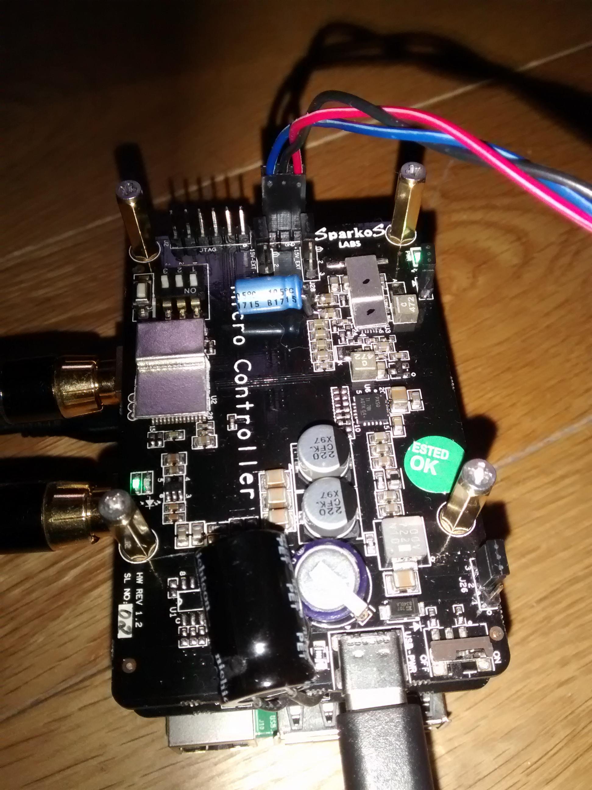

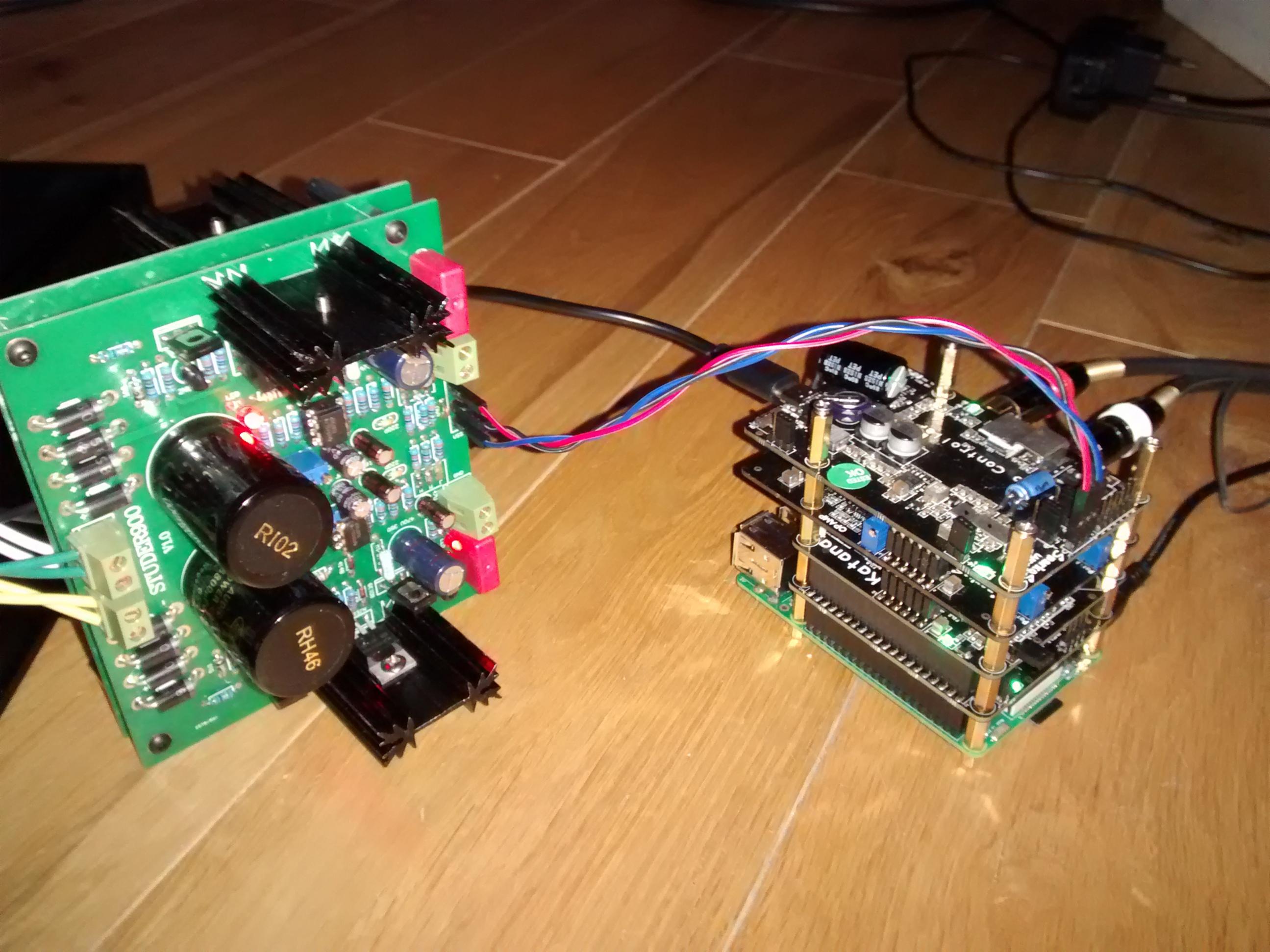

Hello,
I am assembling the power supply for my Katana, but I am having an issue with the +-15V.
At first, I used only two supply: 5V for RPI + 5V for MC
Katana works as expected, I hear the music.
Then I tried to add the external +-15V with the following steps:
- turned off the Sw3 switch
- moved the jumpers J28 and J29 to close 1&2 pins
- connected power wires, +15V to pin1(close to sparkos label) GND to pin2 and -15V to pin3
When I try to play music, sometimes there is no sound at all, sometimes I get like a whistle, a medium/high frequency sound. I do not know exactly how to describe it, also because I turn the power off quickly in order to avoid damaging the boards.
Then, when I go back to the standard 2 power supply, everything works normally.
Did anyone have the same issue? Or am I doing something wrong?
Any advice/help?
PS the stack is composed of MC+THDopamp+Katana+Isolator+Raspberry Pi 3B. The OS is Volumio 2.513
What power supply are you using? Can you attach a picture?
Can you measure the +-15v power supply outputs right after you turn on power? You could try measuring DC volts first, then if you have time try measuring AC volts to see if any ripple or other AC there.
Do you have an oscilloscope to look at the power rails?

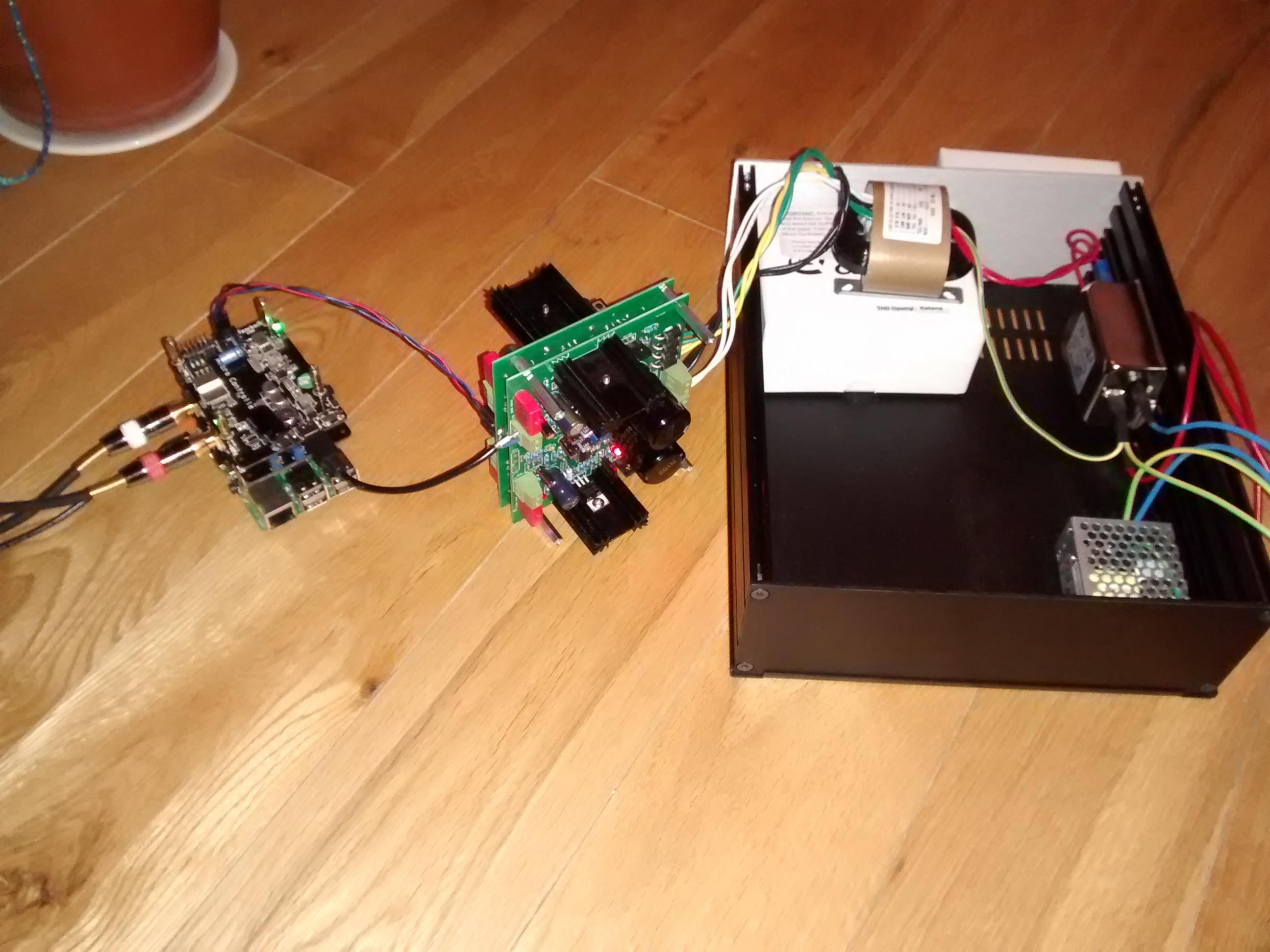

I think I found out what is happening, even though I do not know why.
I measured with a multimeter (sorry no oscilloscope
) DC and AC voltage relative to GND at J27 pins and at the wires of the big black capacitor on MC.
Measure with only the katana stack powered on, raspberry not powered.
RCA cables connected to speaker ampli, to hear any sound/whistle.
For the first 8 minutes from power on, I get:
J27: DC -15.00 V
DC +15.06 V
AC 40mV on both rails
Cap: DC -14.06 V
DC -0.8 V
The MC board is not powering the positive rail of OPAMP board. That is why I cannot hear anything.
Then, after more or less 8 minute (much less if the stack is already warm), I get a sudden whistle from the speakers that last about 10 seconds.
When the whistle stops, I measure:
J27: DC -14.98 V
DC +15.00 V
AC 40 mV
Cap: DC -14.06
DC +14.14
AC 40 mV
the OPAMP board is now powered correctly, and if I turn the raspberry on, I can play music normally.
The voltage regulators used for both the 5V on MC and +-15V are:
Module d'alimentation lineaire regulee OP TL072 MJE15034 28V - Audiophonics
All regulators are powered by a single transformer with multiple secondaries. For that reason the 5V and +-15V are powered at the same time.
Is just the power sequence creating this malfunctioning? It looks weird to me.
Maybe somebody else is able to replicate this issue? Or is my MC board that is faulty?
Here some pictures of my setup

@fabio1068
I am using a similar regulator board with my Katana, but I haven't enabled the separate 15V supplies yet.
You may already be aware of this, but these boards have a current limiting resistor. Mine (from eBay) had 2.2R fitted, which limited the current to about 300mA. That's fine for the 15V supplies, but for a 5V supply that requires more current a lower value resistor is needed. Are you certain that your 5V supplies are not dropping below 5V?
I got some help with this from this thread: low noise Pre-Amp / DAC power supply MJE15034 TL072 Regulator based on STUDER 900
Edit: From the Audiophonics pics, it looks as if those resistors might be 0.22R. If that's the case, they won't limit until 3A!

What are the secondary voltages of the r-core transformer you are using with these regulator boards?
The issue is there only at startup especially cold start
Okay, let's try this again, if you don't mind. On the underside of the MCU board, there are a couple of LDO regulators. They appear to be fed from J28, J29, then the LDO outputs go to the pin header where the big black cap is soldered on. From the symptoms you describe, it sounds like there is a delay in one of the LDO outputs coming up to voltage. Since you say it takes about 8 minutes for it to start working, that might suggest there is a thermal intermittent inside one of the LDOs, in the MCU board traces, or an intermittent solder joint affecting one of the connections between the late starting LDO and the associated input or output pins where you can measure. Seems like a plausible theory might be that when the 1st LDO starts working, it starts heating the MCU board in the vicinity of the LDOs. After enough time has passed the heat causes the thermal intermittent connection to close and other LDO output comes up as you can measure at the big black cap.
No matter what else, if I have correctly described the situation then it would appear most likely there is some warranty problem with a thermal intermittent of some kind on the MCU board.

the secondaries are rated at 9V and 16V, in reality slightly higher.
@Markw4
I checked, and I think the LDOs are fine, since they are also used by the internal DC-DC converter when the stack is powered with only one 5V supply, and in that configuration everything works normally.
I also checked the voltage of the DC-DC at pins J28 and J29 (+14.8V -15.10V) and they are almost the same as my external supply.
I do not see what could be the difference between internal or external +-15V supply.
I only have a doubt. The GND of the power supply is floating, it is not connected to the Earth. If I measure the voltage between GND and Earth I get tens of AC volt. Could it create some kind of issue? do you usually ground the GNDs?
@Markw4
