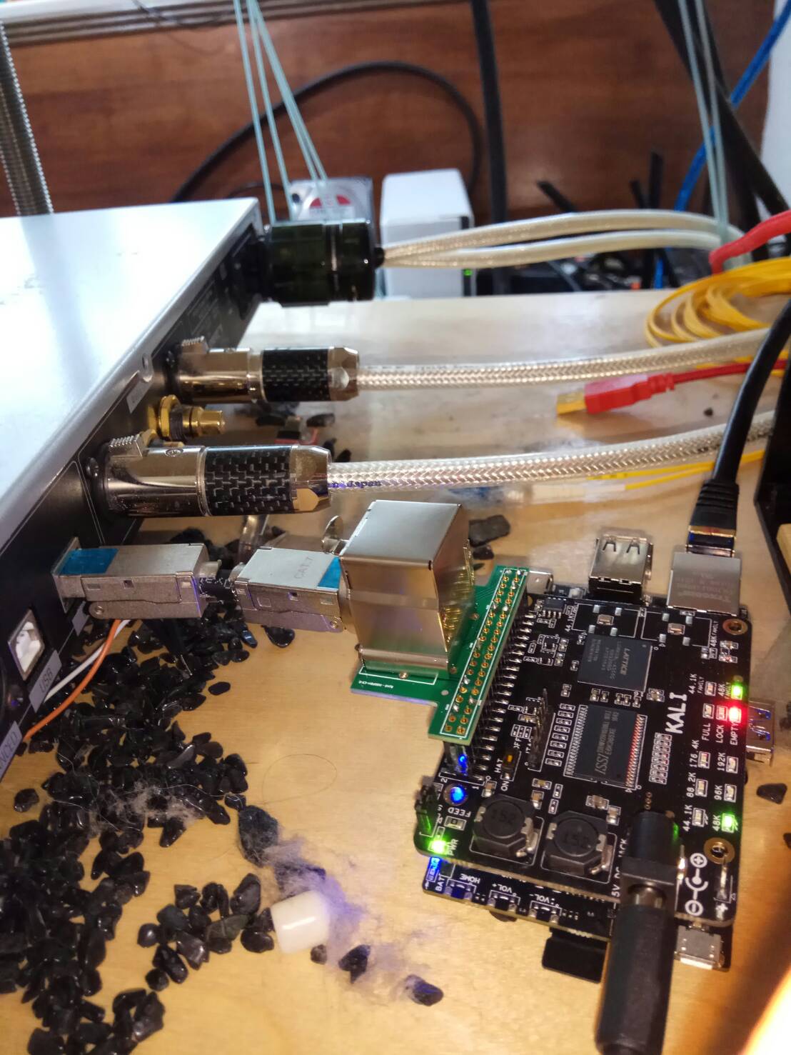

MCK of KALI and I2StoPCM is 3.3V LVTTL logic level so it should be no problem. KALI has to be in a MASTER mode so you should make sure that TDA1543 is in a SLAVE mode.
I2S output of KALI can be transmit to my DAC. The sound is very good so I2S output of KALI is OK for DAC.

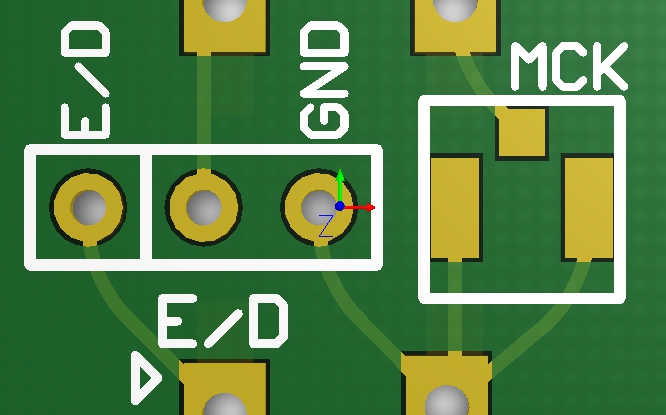

A layout of a external clock board for KALI is completed. I will find a PCB factory to make a sample board, and then I can solder the required components to finish the external clock board for connecting to the Sparky.
