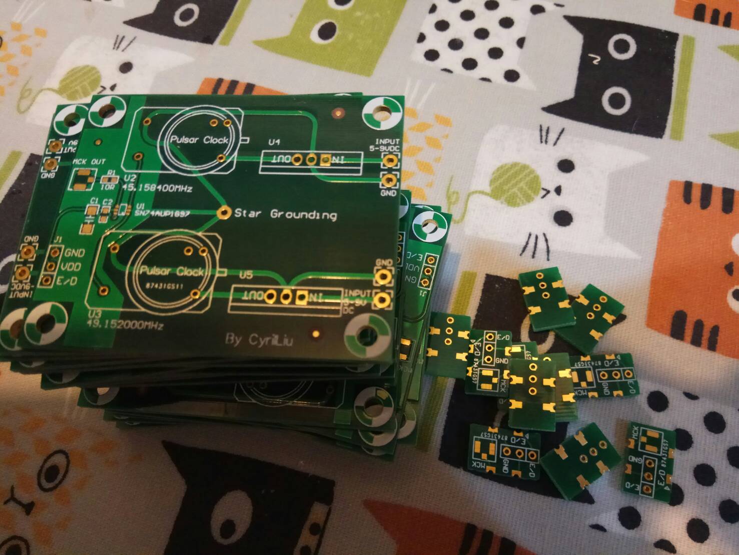

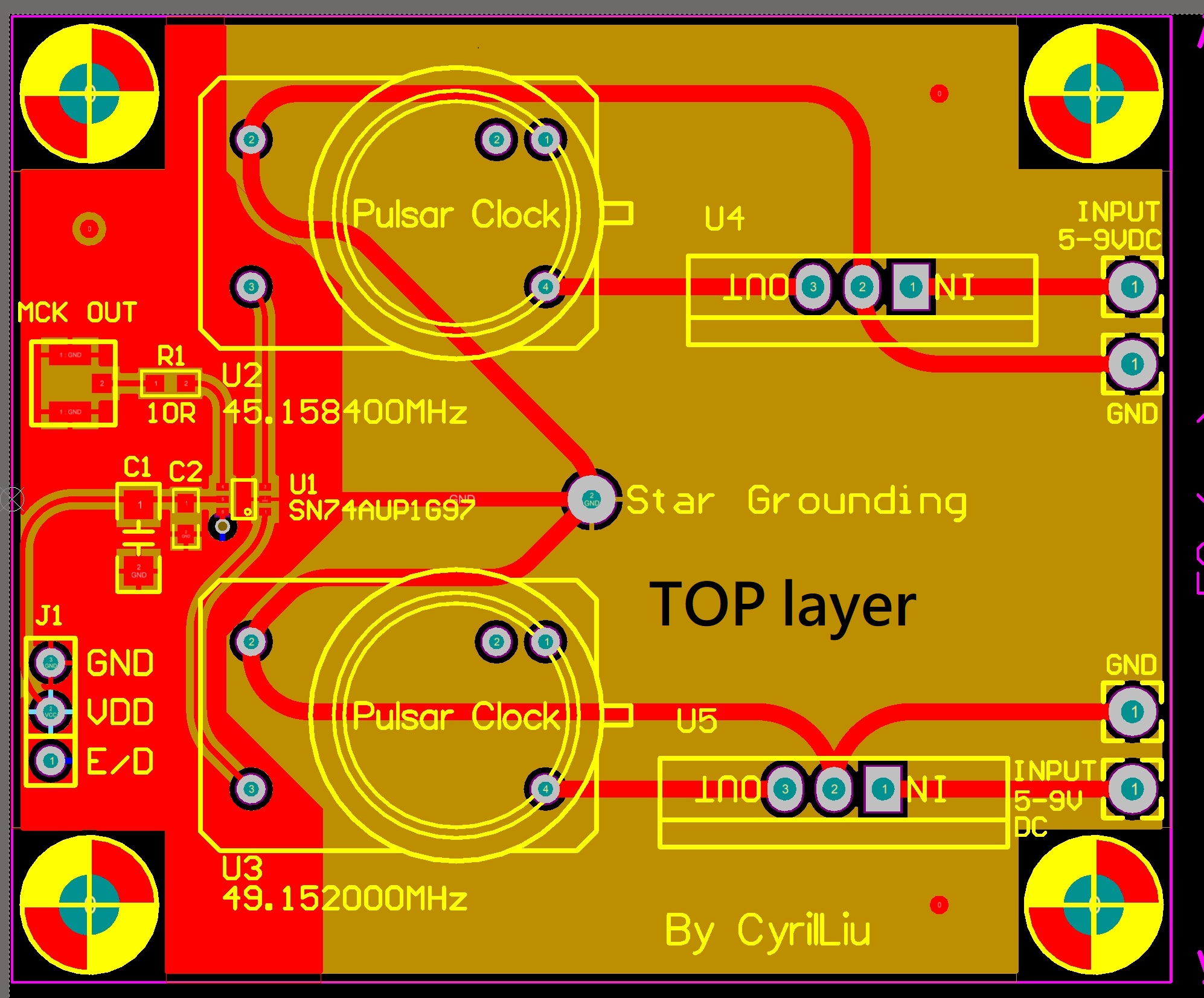

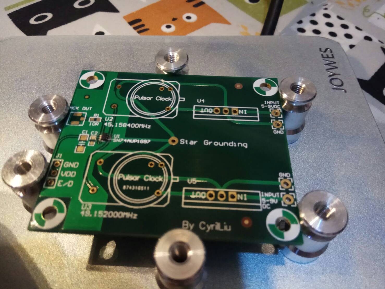

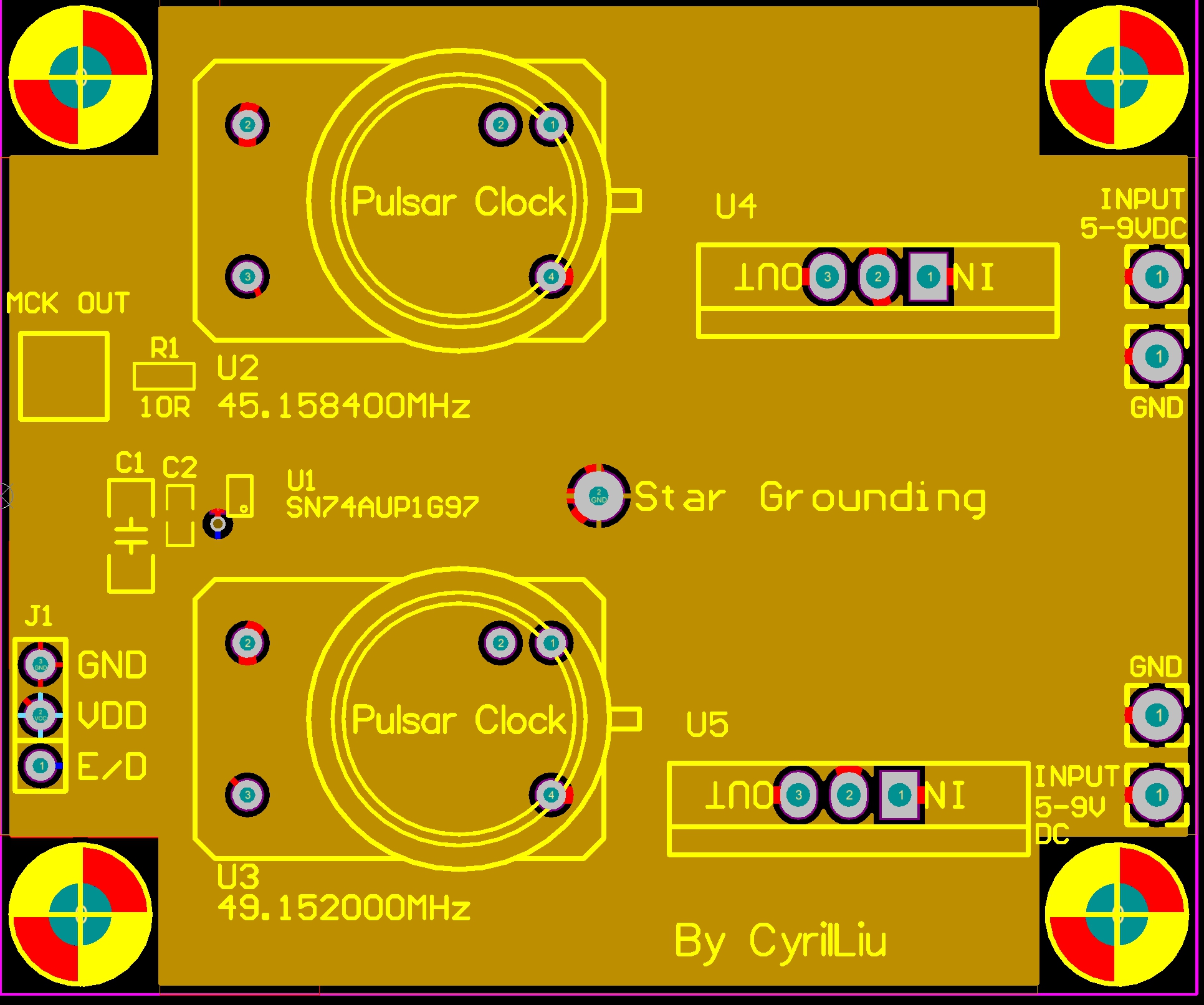

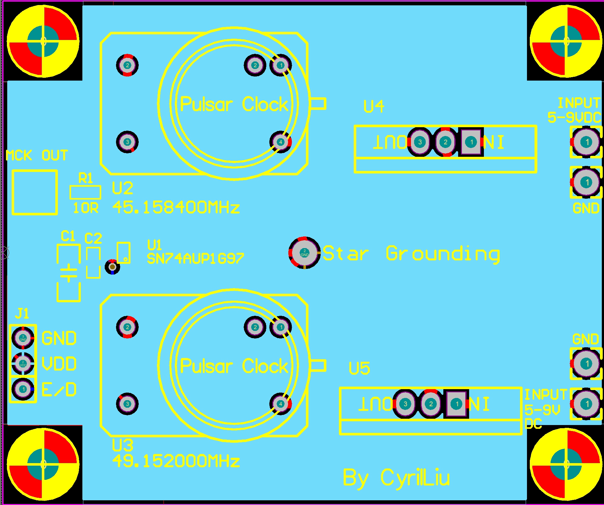

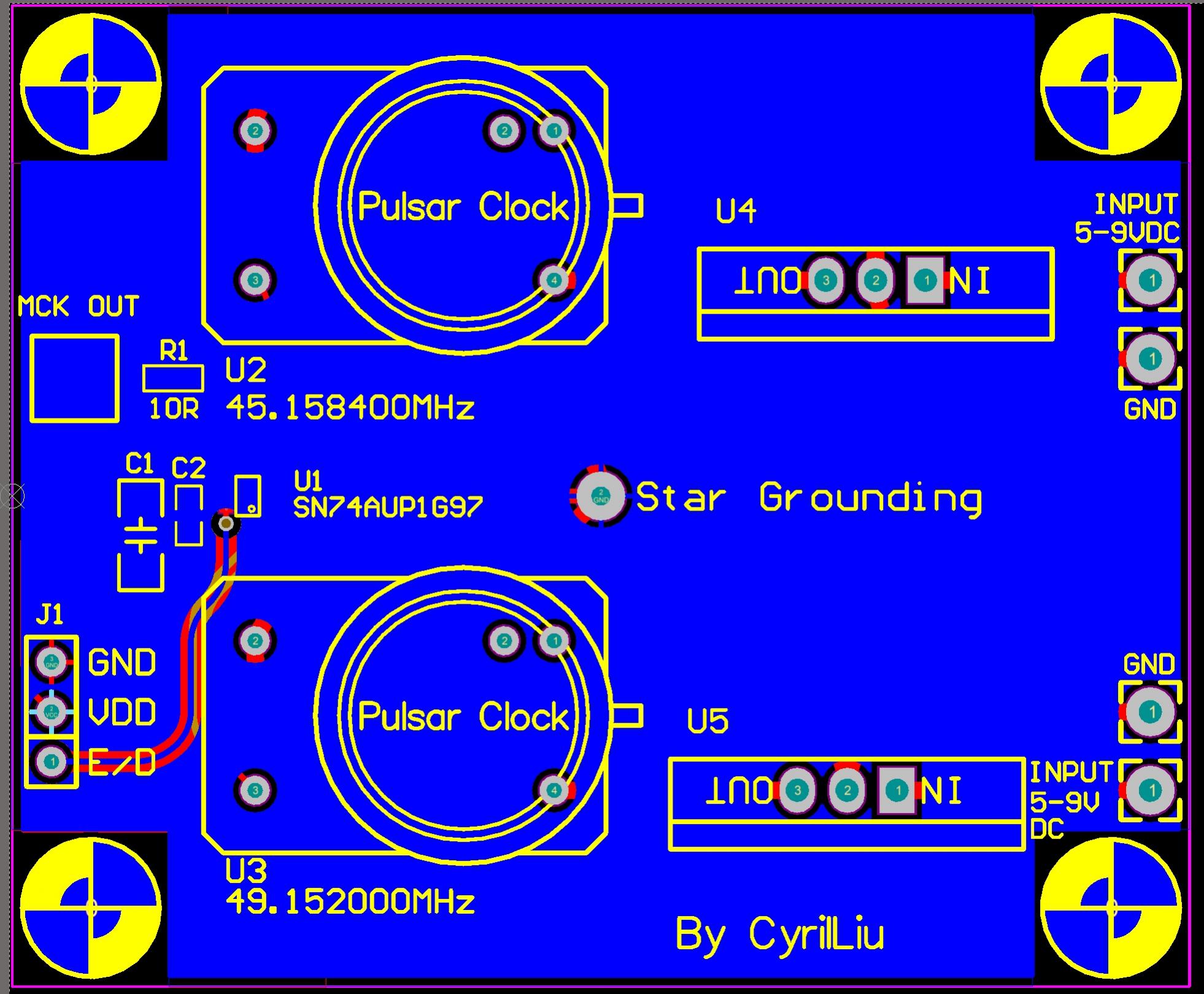

A external clock board for KALI is finally done. You can see the attached pictures that are Top, GND, Power and Bottom. The board has a internal layered capacitor. consists of GND, Power and Bottom, to block more than 500MHz of interference.

In my selector board for Sparky, SN74AUP1G97DCKT is very very small so that it's hard to solder. But I did. I can sleep with a smile tonight. I hope I will never need to solder SN74AUP1G97DCKT again.
