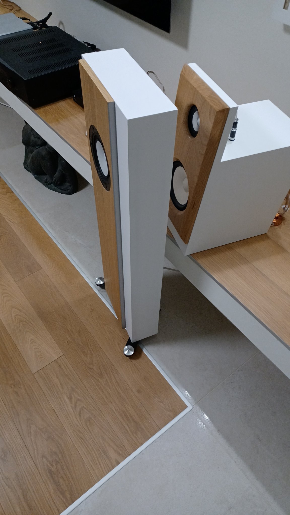

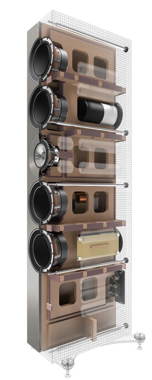

@navin I noticed you posted on the Vituixcad thread showing the Blade clone. It seems KEF have a good product that combines performance, looks and convenience. I thought I'd add that a DIYer might be inclined to give up the low profile frontage to lower their baffle step frequency...
Thanks, I did consider this idea based on an MAOP 10 based idea I saw on this elsewhere forum (see pic below)...

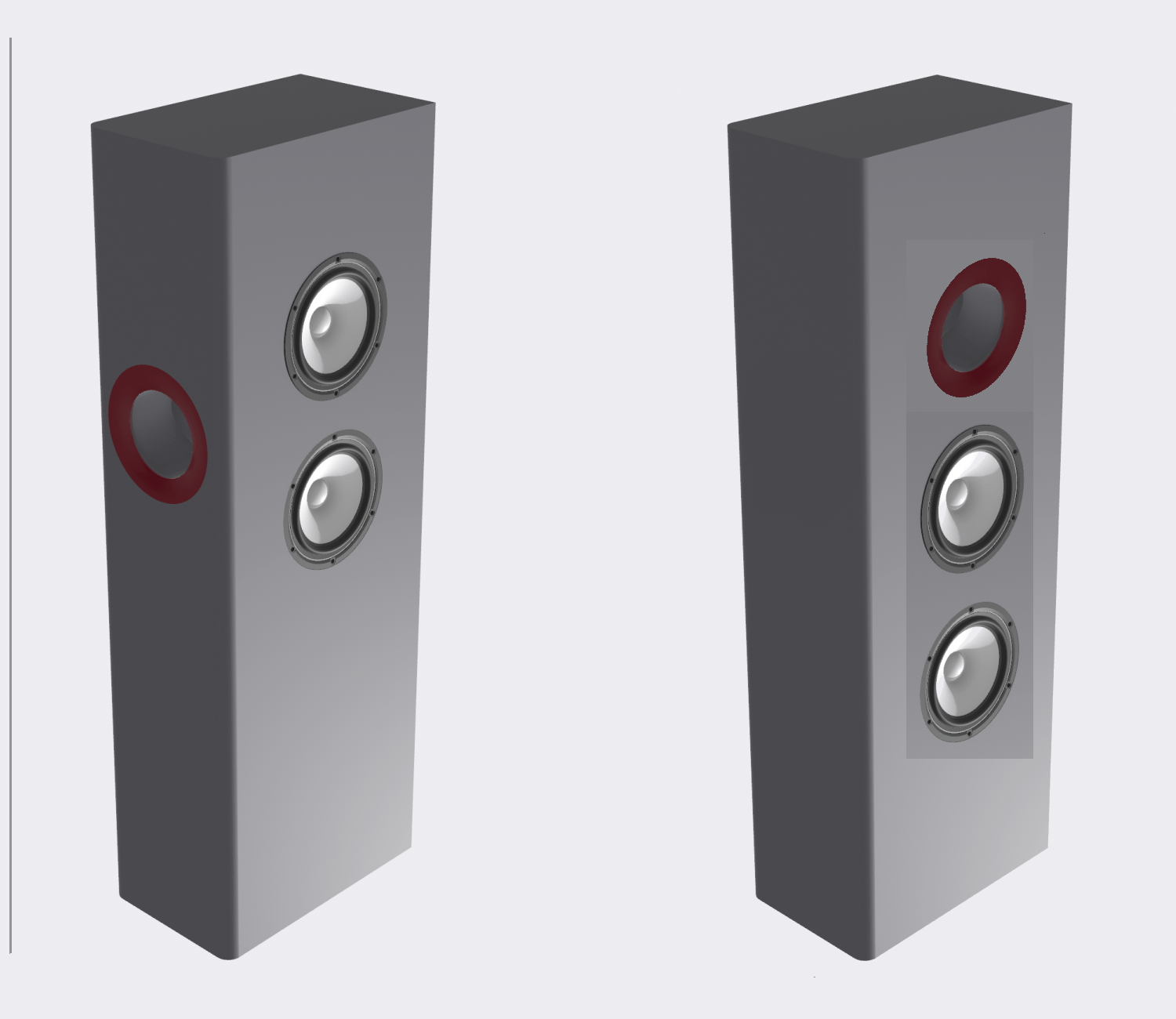

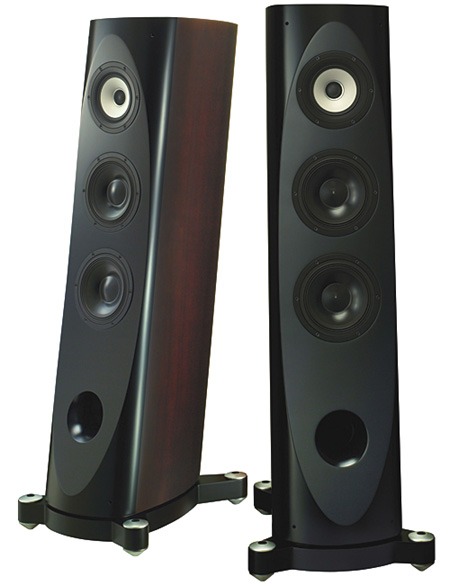

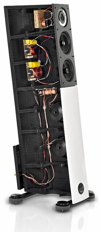

...but I am designing with WAF in mind. Having a visually wide loudspeaker (wider baffle) might not work in my instance hence I considered side-firing woofers (see pic) in push-push to reduce vibrations. When I was in Germany I had heard the Audio Physic systems and they produced good bass for their size especially considering they were passive (not active like Def Tech or any of the others who use an active subwoofer integrated below a 2-way speaker). The bass was tighter than the bass of the NHT1259 woofer based on the NHT 3.3 (or even the smaller NHT 2.5).
![audio physics avantera (350x800).jpg audio physics avantera (350x800).jpg](https://www.diyaudio.com/community/data/attachments/964/964642-8392f9b8ae63f9b7a3a853f28df80238.jpg)
The other option (keeping a narrow baffle) would be to use 4 woofers on the same baffle as the full range (see pics) but that does not change my baffle step frequency much.

![KEF Ref 5 Cutaway-300.jpg KEF Ref 5 Cutaway-300.jpg](https://www.diyaudio.com/community/data/attachments/964/964645-60a1c2557ffd4b15bf8fddd4481b0ddd.jpg)

There is bafflestep for both the wofers and the coax. In the blade-style, the BS of the woofers is higher than the XO (likely) and that of the coax above.
The woofers should be essentially be omnidirectional (already in full 4π mode).
