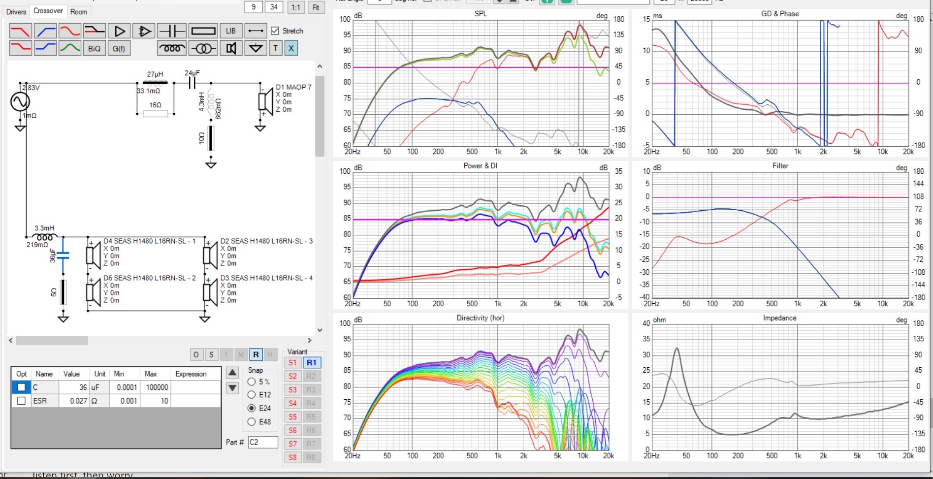

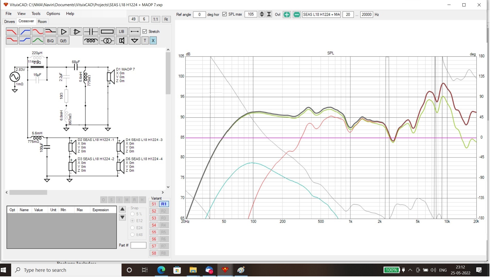

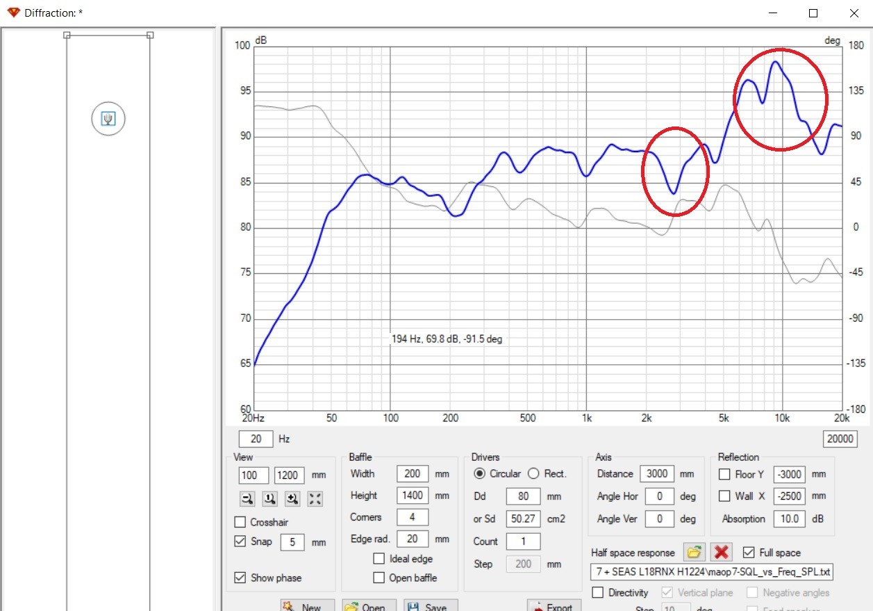

So I went through the instructions given by Member DciBeL in the link below.
https://www.diyaudio.com/community/threads/vituixcad.307910/post-7027808
MAOP 7 experts, How does one treat the dip around 3k and the peak around 10k? Especially that peak.
I tried everything including some very radical values for the crossover but was unable to tame those 2 aberrations.

![MAOP7 on 200m baffle.jpg MAOP7 on 200m baffle.jpg](https://www.diyaudio.com/community/data/attachments/965/965826-37d4e7c95d373be0f677631f8ac3f333.jpg)
![MAOP + SEAS L18RNX H1224.jpg MAOP + SEAS L18RNX H1224.jpg](https://www.diyaudio.com/community/data/attachments/965/965831-215270ab40267929779ea6a4d1acce60.jpg)

Navin, that is on-axis, rarely do you listen to them on-axis.
![MAOP 7 + SEAS L16RN-SL H1480.jpg MAOP 7 + SEAS L16RN-SL H1480.jpg](https://www.diyaudio.com/community/data/attachments/966/966385-76415500a7ac8650bc4a32b5fbbef433.jpg)
True. I haven't heard the MAOP7 and am less worried about the dip around 3k than the huge broad peak centred around 10k even off axis. I tried the MAOP 7 with another woofer (SEAS Prestige L16RN-SL H1480) just to make sure I wasn't making some error.
FWIW, I owned a pair of MAOP7 for a couple years, I think it was, and in a couple of different enclosures never perceived anything approaching those graphs. To echo Allen’s query, when you say “tried”, does mean real world auditions, measurements, or simulations?
