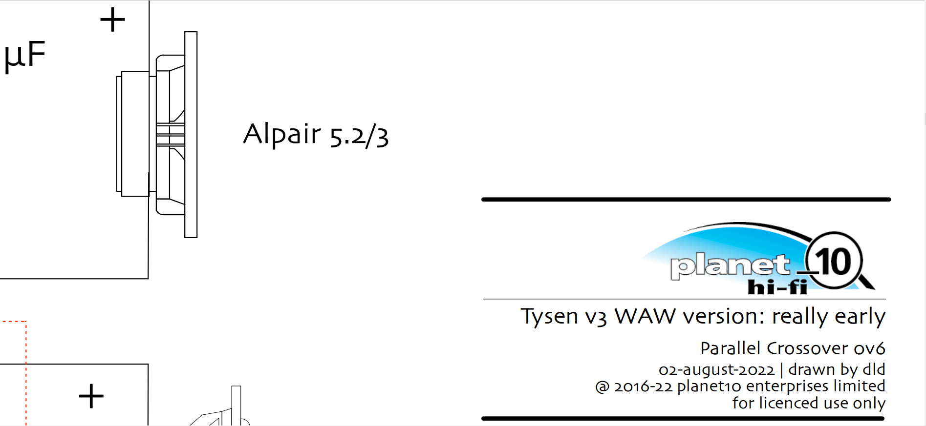

Is there a Tysen V3? I have only heard of a V2. Thanks.I just bought plans for Tysen V3 from Planet 10,

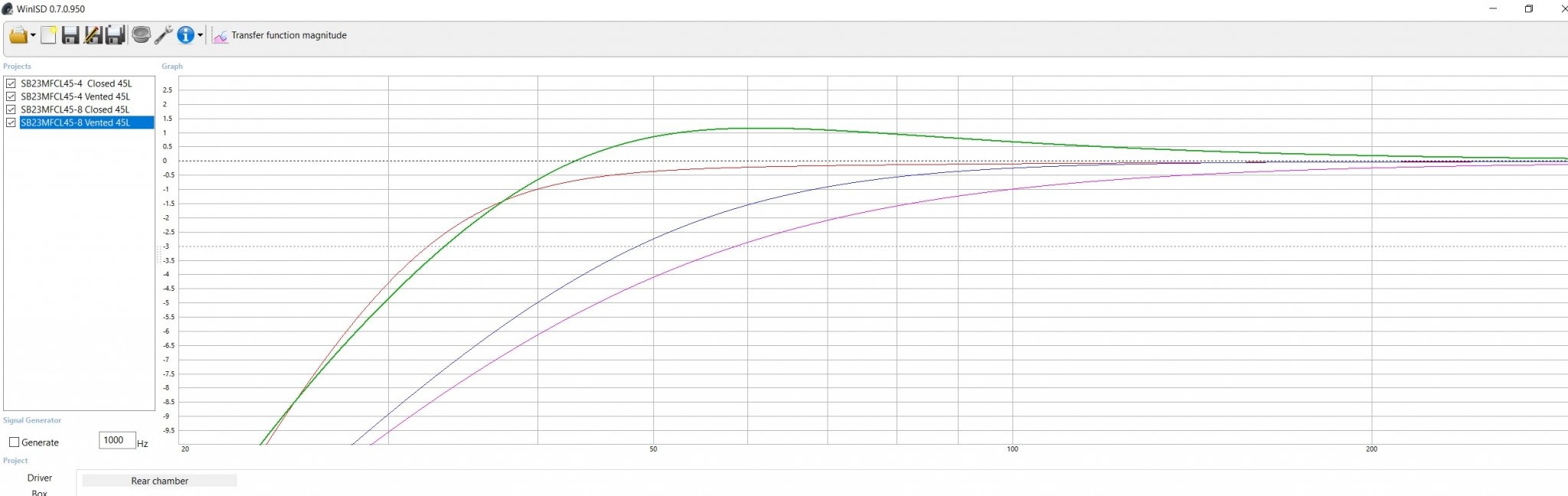

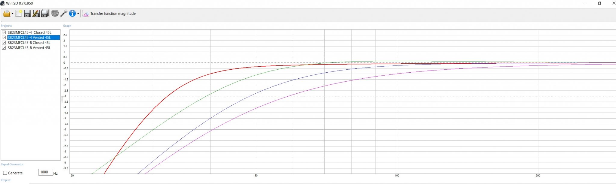

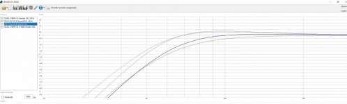

After Dave's and Allen's responses (Post 2130 and 2131), I am reverting back to using 2 SB23MFCL woofers instead of 4 smaller woofers.
I agree, the blue curve does look best.
Since I would be using only two woofers, I thought about using the 4-ohm version (in series) of the SB23MFCL drivers. The T/S specifications are quite different from the 8-ohm version. In 45 litres (which is my target box size), the 4-ohm version (red - vented 30Hz and pink - sealed) model is quite different from the 8-ohm version (green - vented 20Hz and blue - sealed). Which version (4-ohm or 8-ohm is preferred).The blue curve looks best.
dave
![SB23MFCL45 4 and 8 ohms.jpg SB23MFCL45 4 and 8 ohms.jpg](https://www.diyaudio.com/community/data/attachments/987/987188-586b3546185c6be720cf596ac36890e2.jpg)
I also tried both woofers tuned to 30Hz, which results in a bit of peak for the 8-ohm version.
![SB23MFCL45 4 and 8 ohms 30Hz.jpg SB23MFCL45 4 and 8 ohms 30Hz.jpg](https://www.diyaudio.com/community/data/attachments/987/987189-d8434b7d859d471a530eb0b3bfb6d89e.jpg)
Also, is there any place I can get the FRD and ZMA files for the SB23 woofers? Thanks.
It's the V2 but for Mark Audio Alpair 5.3, it just add the passive XO, that makes it V3.Is there a Tysen V3? I have only heard of a V2. Thanks
That's nice. I didn't know Dave did custom work.It's the V2 but for Mark Audio Alpair 5.3, it just add the passive XO, that makes it V3.

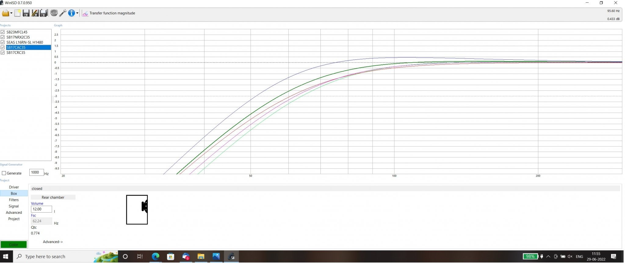

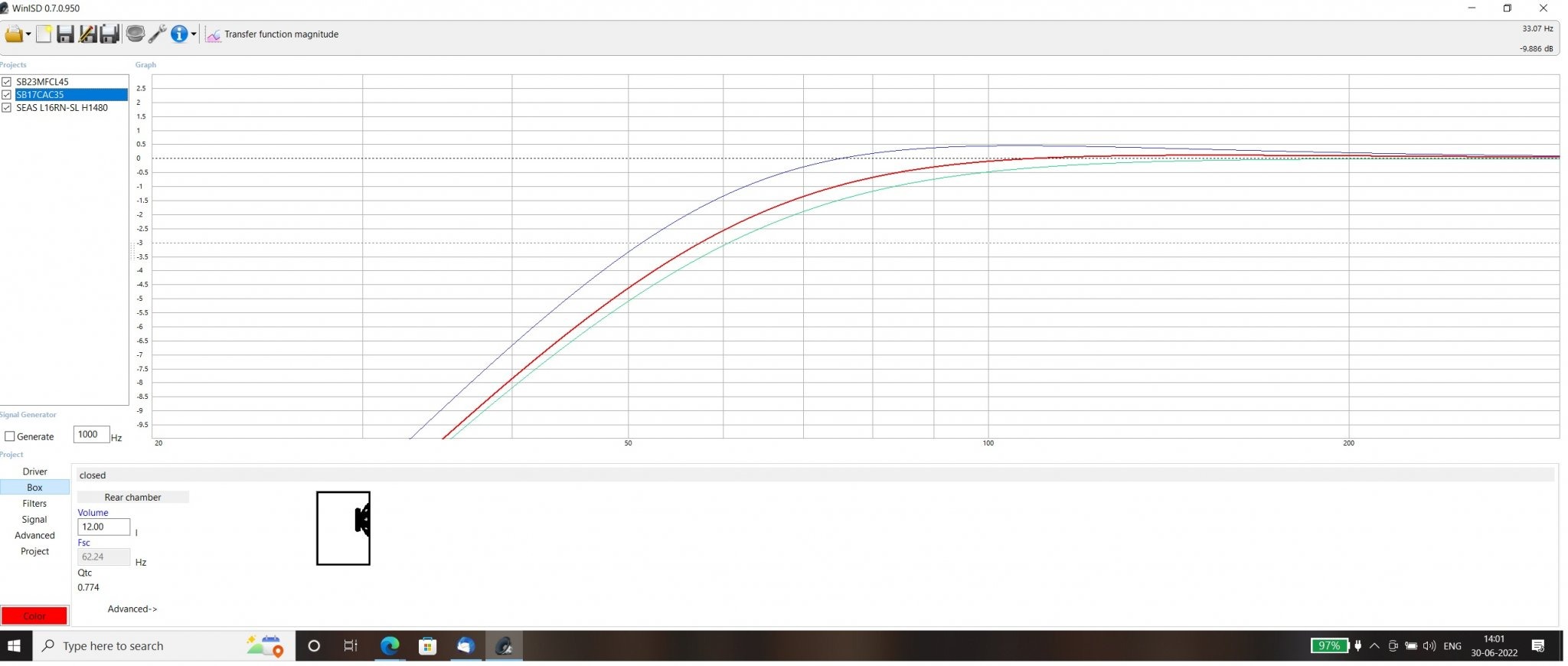

I simulated that subwoofer against a few other woofers (all of them in a 12-litre sealed box).
Blue line - SB23MFCL45 - the curve of the woofer both Dave you liked above.
Dark Green - SB17CAC35 - the curve I like most now
https://www.madisoundspeakerstore.c...coustics-sb17cac35-8-6-ceramic-woofer-8-ohms/
Light Green - SB17NRX2C35
Red - SEAS L16RN-SL (H1480) - the same woofer which was my earlier preferred option (post #2128)
Pink - SB17CRC35

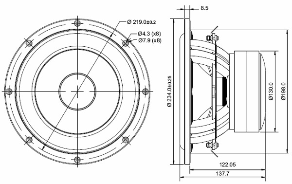

The SB23MFCL45 woofers are 122mm deep. Putting 2 of them back to back would mean that the inside width of the cabinet would have to be 244mm at the least. Given that I am considering a cabinet that is less than 200mm wide outside (150mm inside width) these drivers wouldn't fit.The alternates I have in mind are the SB Acoustics SB17CAC35-8 (red curve) and the SEAS H1480 L16RN-SL (green curve). The former is my "1st runner up" and the latter is almost always available.
![SB23MFCL45-4-mech.jpg SB23MFCL45-4-mech.jpg](https://www.diyaudio.com/community/data/attachments/987/987527-0c1f80e40bb2f97f70be8240a512d76c.jpg)

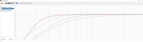

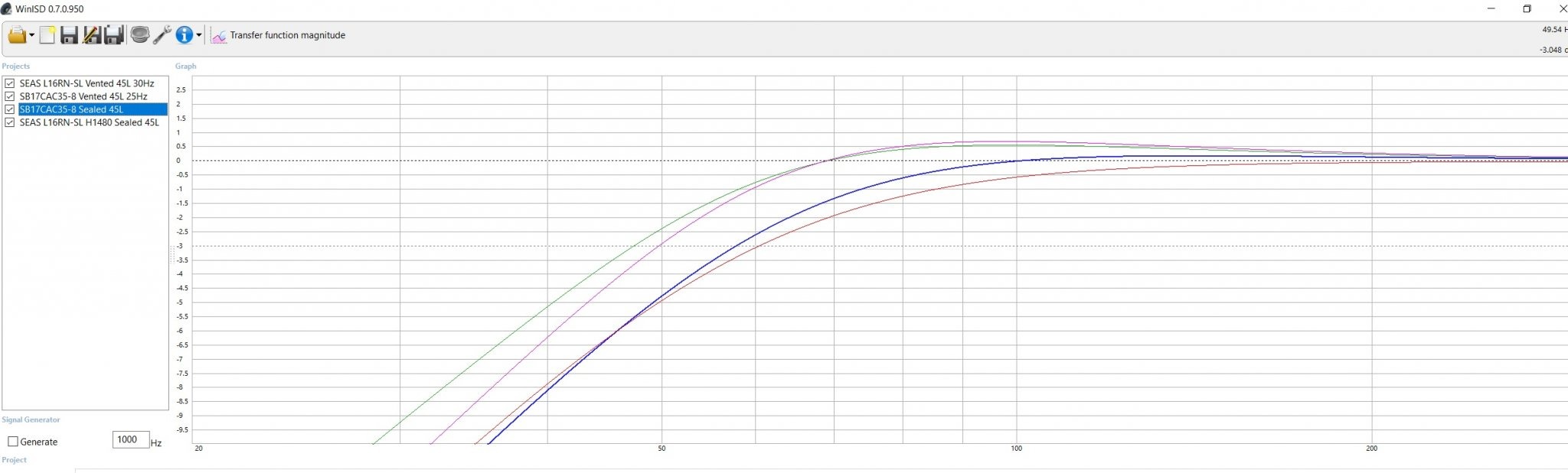

The SB17CAC5-8 and SEAS L16RN-SL, however, would both work. Which one is preferred? Both are available in quantities of 8 (I need 4 per speaker). I compared their response using WINISD in sealed and vented (45L for four drivers) below. The SEAS was tuned to 30Hz, and the SB was tuned to 25Hz.
![SEAS L16RN-SL vs SB17CAC35-8.jpg SEAS L16RN-SL vs SB17CAC35-8.jpg](https://www.diyaudio.com/community/data/attachments/987/987532-b5a3f423898bb28a61d1da18a4994694.jpg)
V3 is only replacing FF85wk with Alpair 5.2/3. I have added a really early suggestion for an XO.Is there a Tysen V3? I have only heard of a V2. Thanks.

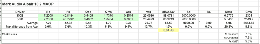

Yeah. Definitely not a matching pair. Hopefully I’ll get a response from the supplier tonight (my time). Thanks!When i match a driver pair, all the percentage metrics need to be 3% or less, and sensitivity within 0.25dB.
I plugges your numbers (no BL) into my matching table.

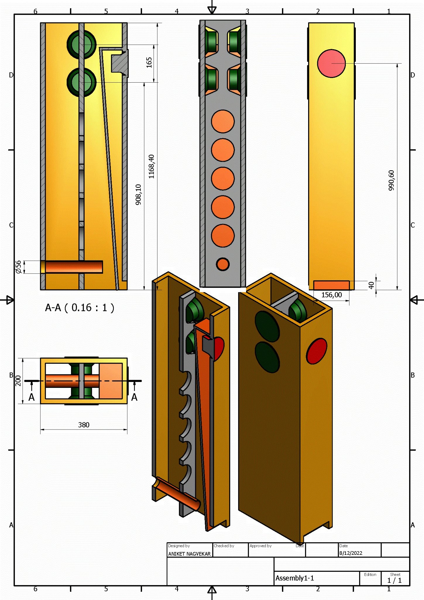

I drew this up over the weekend. How do we take it from here? You can email me at navin@elektromag.com. The listening height can be lowered by moving all five drivers lower. I just used the maximum height as a starting point.Quite a bit.

The top and bottom have been consciously left out. They will be added once the rest of the design is finalised. Since most 8" woofers (such as the SB23MFCL45) would be too deep to fit in push-push, I am toying between using either the SEAS L16RN-SL or SB17CAC35-8. I would have preferred the SB driver, but Erin's unflattering review of the 4-ohm version of SB17CAC35 has confused me.
https://www.erinsaudiocorner.com/driveunits/sbacoustics_sb17cac35-4/
![Driver system R1.jpg Driver system R1.jpg](https://www.diyaudio.com/community/data/attachments/991/991487-3d272ac9f20c8f612b06f4799b80f292.jpg)
That looks good. I have no comments on the woofers. Some SBs are superb some are not.
Given that you are taking away the part of the range where midbasse sound most different, if the bass drivers you choose satisfy depth, box size and budget you will still be good. Don’t get to buried in analysis paralysis.
I did similar midTL in the Facets. But i did run it all the way to the top instead of terminating just above the driver.

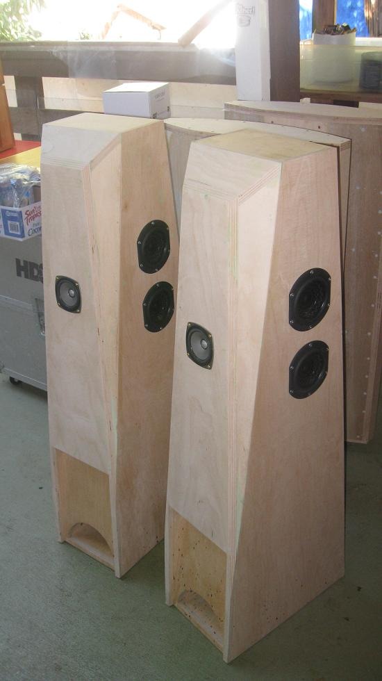

This is our attempt at the Blade-style driver arrangement. It developed from the dual woofer uFonken+woofT below. We had to really jump thru hoops. Likely to never be built again (i am still working on them [the pic shows the new rebate for A5.3. The bas sloading is a crooked ML-Voigt], gotta work out a passive.

This looks like a very complicated build. And with the woofers so far from the full range did you have any trouble sonically integrating the woofers?This is our attempt at the Blade-style driver arrangement.
