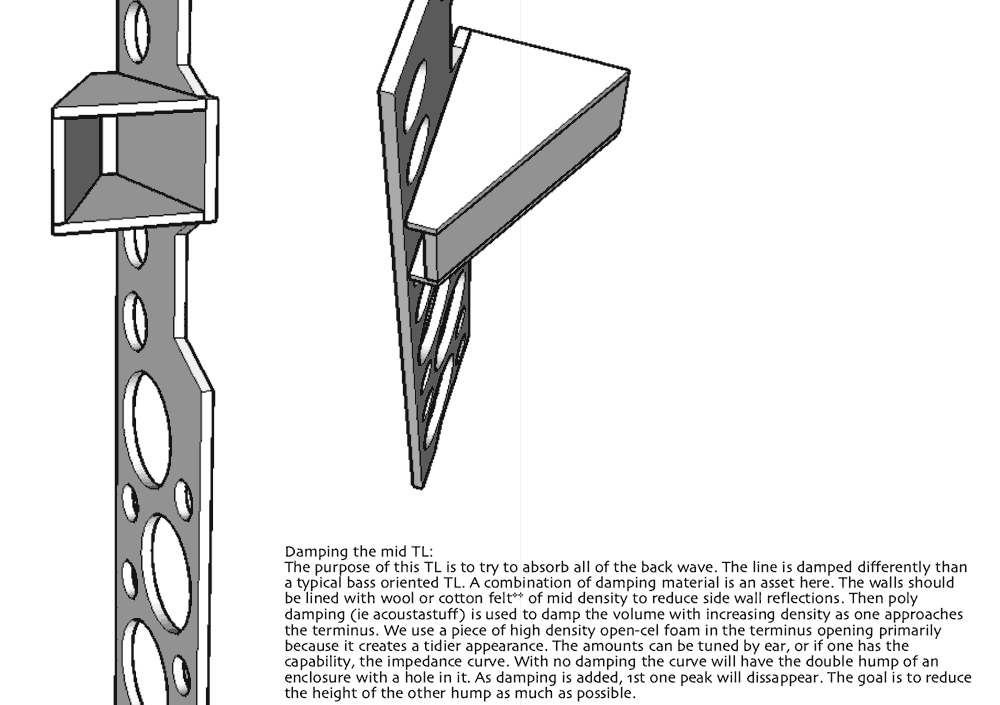

Yes, a plug of foam recovered from computer repair parts packaging, IIRC approx 1" (?) thick. This is a technique that has incorporated in several of Dave's designs for fine tuning - perhaps even in the A12PW/A7.3 MTMs? Hard to remember, there were so many builds with several iterations along the way.
Do you have any links or project names that I could see further regarding the foam vent plug (and how it is implemented)?
I saw some PMC speakers also having theis feature in their vents

The PMCs foam is quite less dense, and the damping does not serve the same purpose.
Implentation description probably requires seeing if one can find one of my posts on the subject. The idea is to push the midTL to aperiodic. The foam you see at the terminus is only a part of the scheme.
The KEF LS50 has a foam plug in it's vent. The plug does two things:
1) it reduces the amplitude of peaks in the output of the vent. For instance, a conventional vent that's tuned to 50hz will have high frequency peaks that can be louder than the fundamental! These peaks can muddy the mid-range.
2) there's no free lunch, and the foam will also reduce the *overall* output of the vent.
