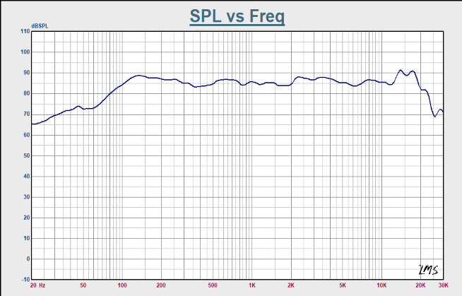

Btw, Pluvia 7 paper measurement graph does not look like that of the CHN-70... the page also says the driver has the rectangular wire for VC - IIRC first introduced with the Alpair 10.2 and was one of the tweaks/tricks to coax out bass performance from a modestly sized driver.

Re 5.3 was thinking a large v shallow 3d print or cnc guide cd work well to tilt and level the frequency response, seeing as it drops off slightly under 1khz or so. Then cross to a suitable driver below 450hz perhaps
It does?
That said, a 450Hz crossover could work nicely if you're using it for mid-tweet duties.
