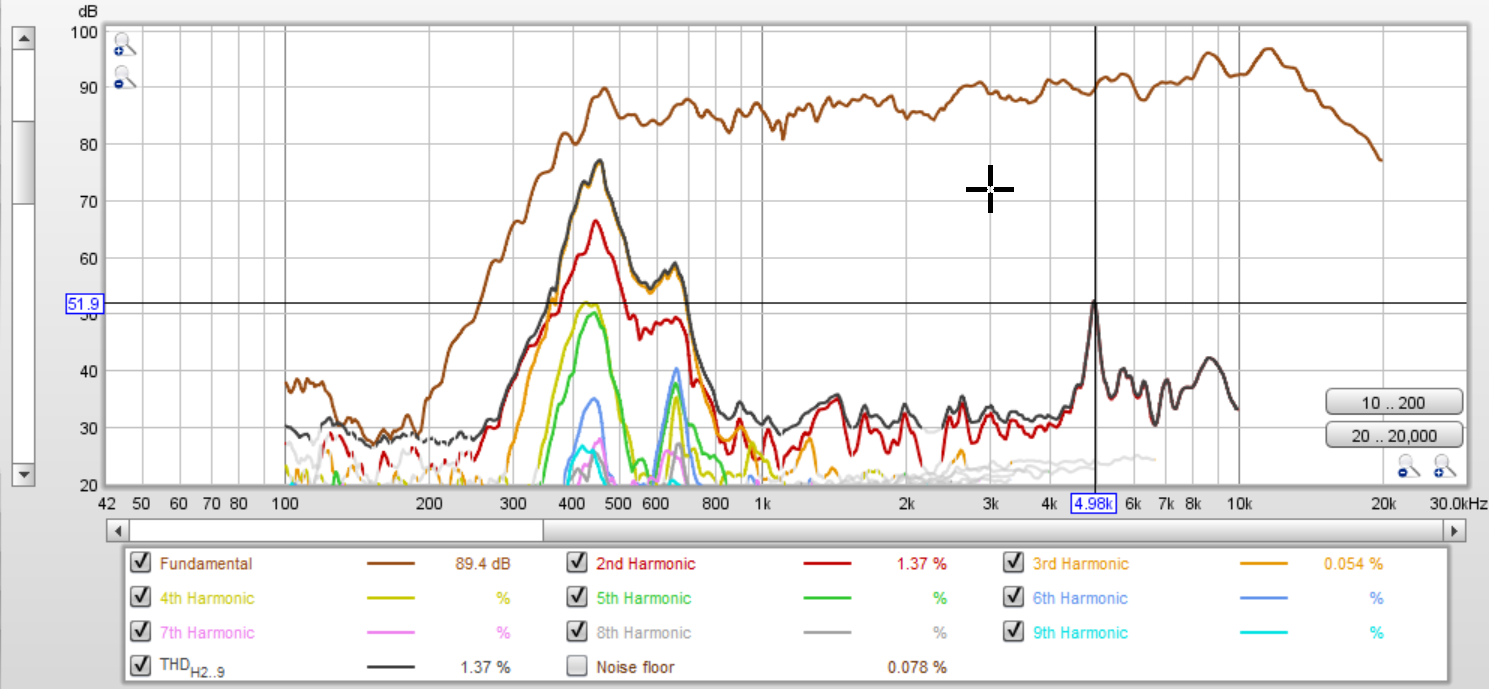

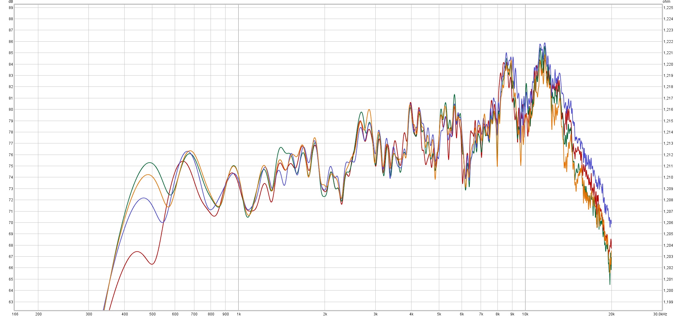

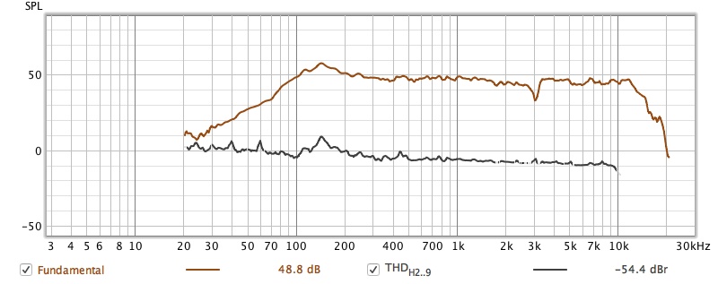

Yesterday I received 4 SLIM8 units, and I made some rough initial measurements with a (calibrated) UMIK and REW.
Drivers were suspended by wire, no baffle was used. Mic a 1m distance, only did on-axis measurements (for the moment). Signal ran through a MiniDSP 2x4 which was used to put a low shelving filter with 10dB gain at 400Hz, as well as a 48dB LR also at 400Hz. Furthermore I put 80uF of capacitance in series with the drivers (protection). Same volume settings for all units (but I did not measure actual voltage applied to drivers). Gating set in REW with 7ms in left window, 0 ms window ref time and 9ms right window.
The first picture shows the response and distortion for a single unit. The second and third picture are the overlay of respecitvely the FR and distortion of all 4 units.
I was hoping to be able to make a line array to be used from 400Hz onwards, but I do not think this is a wise idea...

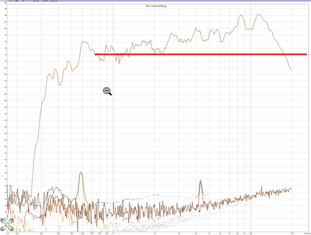

If I am reading your plot correctly, the frequency response is dropping like a rock above 12kHz. This makes it a tweeter only for the hearing impaired... Off axis will likely be worse than that (more attenuation, and starting lower in frequency) because of beaming.
Hi Charlie,
I see your point and I do agree that it may not be good as tweeter based on these curves. A pity that another driver would have to be added for about half an octave.
To obtain the above curves I did the shelving low pass with MiniDSP. Looking at these curves I would say this driver could be used from about 800Hz upwards. Currently I have a gain of about 10dB at 800Hz due to dipole cancelation, so instead of positive gain at the low end I thought about attenuating the HF up to about 12k. Ie, cut off everything above the red line.

Although it depends on the input sensitivity of your amps and the output voltage drive capability of the miniDSP, from what I recall it is better to EQ using attenuation than to boost so that you do not overdrive the DAC stage. That might happen with a 10dB boost, for example. You can add back a bit of gain using flat gain later to balance out the gain between channels.

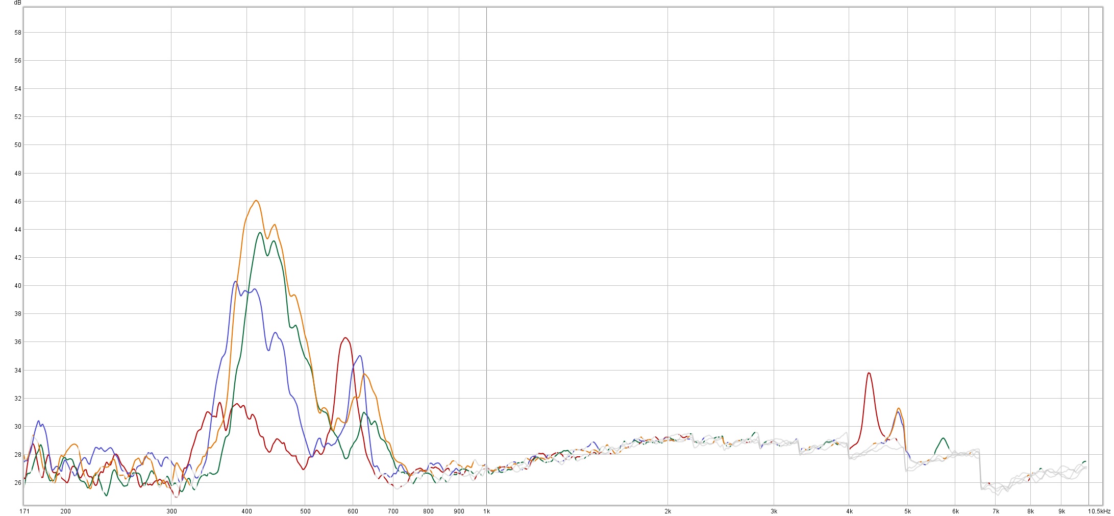

There seems to be a problem at about 4.3 kHz, a peak in the distorsion.
Which harmonic is the red trace? Problem may be higher in frequency.
Yes, at the low SPL levels shown here only my unit 1 has this. Unit 4 was tested at higher SPL levels, and it looks like in the attachment. Again, the distortion peak at almost 5k.
As written in the previous post, I will probably attenuate the HF anyway, so this distortion will be lowered.
There is quite some tinkering regarding this
In post 62 the curves are the THD for each of the 4 drivers. IIRC the peaks at around 4k are 2nd order, as shown in post 70 for driver 4.
Yes, that looks like rather big membrane tension differences
But considering the price one could have feared bigger individual deviations than this. Depending on the actual input level, distortion is not horrific nor great.
For the projects I have going on, the two peaks and relatively early drop off, as well as the tension and general slope makes it suboptimal.
Which does not mean that it's not a useful or manageable design in general

And that 5 khz distortion peak is pure second harmonic so I wouldn't worry that much. Especially since it is in the single digit %.
It looks like running the slim ones nude and covering 400 hz and upwards is probably asking too much. The wide should be able to do just that as measured over at audiocircle GRS-3 vs Neo 3. The wide variant seems to perform @ 500 hz how the slim performs @ 800 hz. Should be a worse tweeter though.

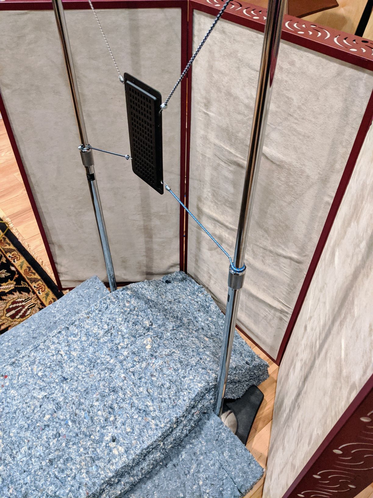

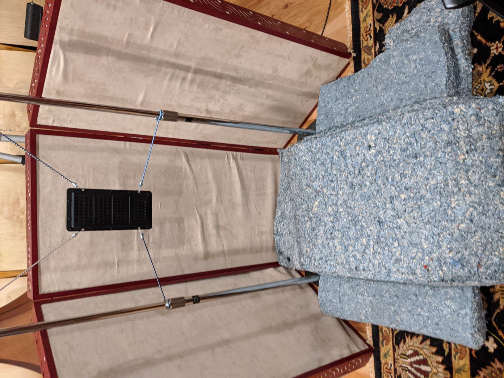

Still pouring over the data, but here are few photos of the testing rig. I'll try to get some curves up tomorrow night.
The background noise level in the studio was measured at about 40dB. Testing occurred at 1ft and I set the first driver, an original BG Neo-10, at 95dB at 1KHz and didn't touch mic gain or playback level after that.
