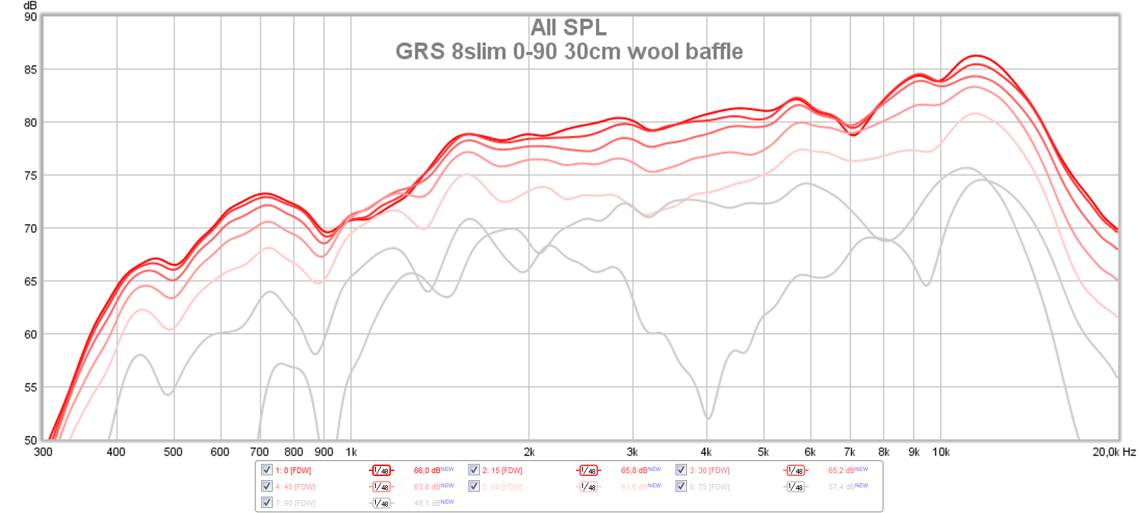

Thanks Greg! Very similar looking responses. The GRS PT5010-8 has a bigger peak to deal with but overall not bad in comparison.
And crazy overall sensitivity. Active DSP systems could really sing with this driver I think. I'm toying with the idea of 6-8 per side in a line array.

Is passive crossover design/expense going to be unreasonably taxing to tame those peaks? Even the Neo versions seem to have a 10-12 dB peak compared to say 1kHz baseline, but the GRS versions seem to have extra 5-6 dB peak on top of that to tame

I'm really hooked on the hypex fusion series of plate amps. The price is very good considering the power output and DSP functionality you get. I'd honestly do a bunch of subtractive eq to the slim 8 and try it as a tweeter first. Running a line array comb filters the hell out of the top octave in most designs anyway. Run it from about 850 all the way up. Maybe lower in a line array. Solid output to 15khz might work for you.
I was thinking a line source of GRS PT5010-8 10" running down to say 250 Hz or whatever they can go down to, with the Slim 8 line beside it doing 1-3k above that. The minidsp would allow me to play with crossover and room interaction.

Tried to upload the REW .mdat file for you all to use at your leisure, but file uploader says it's too large.
Any ideas?
Thanks for posting your measurements.
Have you tried breaking the single aggregate .mdat into multiple .mdat files containing fewer overall measurements per file ?

Why the love of the Slim-8 over the Regular-8 (other than $9)? The Regular-8 has better THD plots.
At least for me it is because wide doesn't have as good dispersion on the top end and needs a separate tweeter, the slim doesn't*.
*As long as enough drivers in a line are used such that the limited vertical dispersion isn't an issue.
The only off-axis SLIM-8 results (that I have seen) appear to be from covering up the outside slots on a wool/felt baffle. Wouldn't this have the same effect on the normal 8's ???
SLIM-8 has better frequency response. The regular one has a strange dip just below 1khz. I would use the regular one from 1khz and SLIM-8 from 800hz up. But I don't regret my Radian Audio LM8K purchase. It has a very usable frequency response from 350hz up. I am using 8 per side without tweeter. https://www.diyaudio.com/forums/multi-way/337631-radian-audio-lm8k-3.html#post6366395
