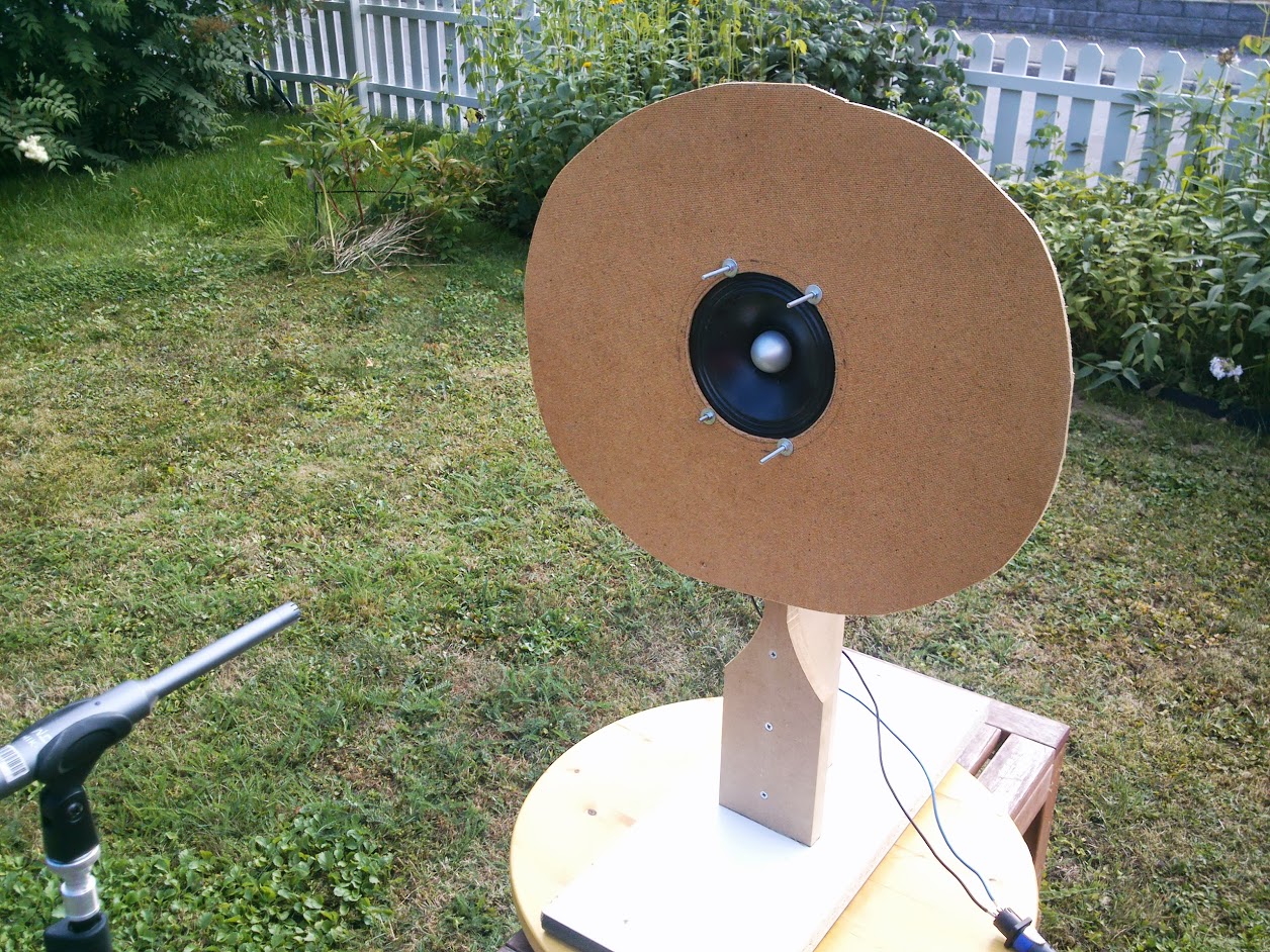

The first one Frequency Consistency. As shown in the third image of the measuring setup I've placed a measurement microphone fairly close and then placed the planar in a vice in while pushing it against the rivets. This is such that I can swap the drivers and still get a pretty consistent measurement.
And consistency is the key. While I have measured the frequency response of the driver I don't really care about the actual response. If I did I would measure from a greater distance which would yield a more flat curve. What I care about is how different is every driver to each other driver.
All drivers are different, the best drivers are not good just because of fancy motors and such. They are good because the drivers have excellent consistency. With such you can take any driver and swap it with any other and you wouldn't have to change the crossover, it would perform pretty much the same.

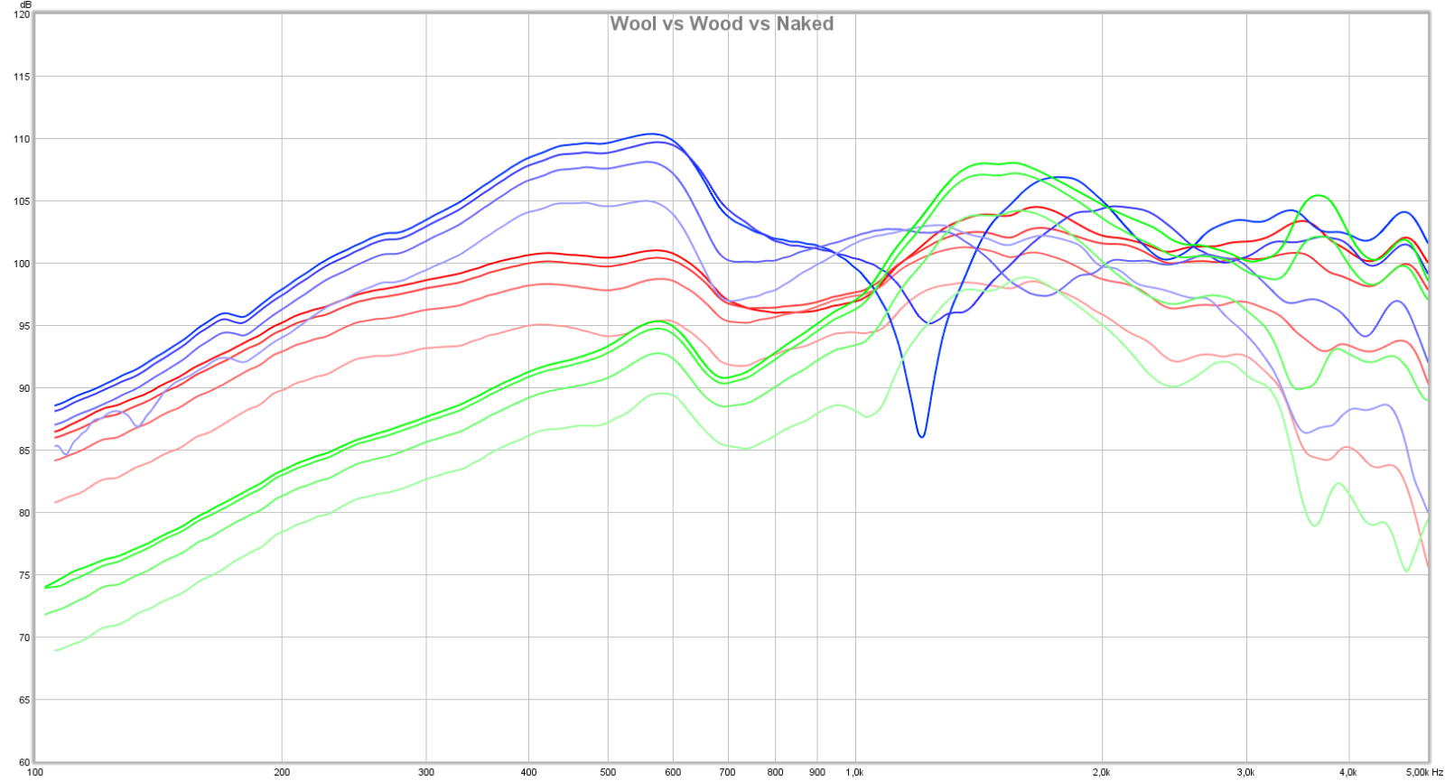

With a hard circular baffle that is wide relative to the driver it creates a sharp null in the 0 degree direction to the front and the rear:

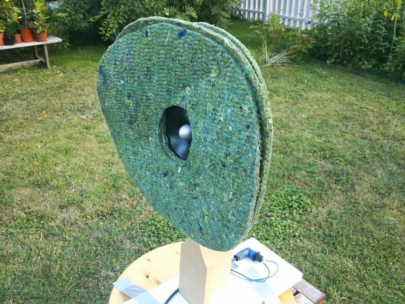

Here are [0, 15, 30, 45] measurements of a 6.5" midrange (AE TD6M) on a 50 cm wide circular wool baffle (Red), 50 cm wide circular wood baffle (Blue) and naked with no baffle at all (Green).
With a solid baffle there is a sharp dip at 1200 hz -ish @ 0 degrees. That null with a solid baffle is basically the reason why so many dipole builders go for no baffles or very small baffles. Usually 4-way since then you can't have both the low frequency extension of a small baffle and the high frequency smoothness of no baffle.
The wool baffle smushes this around and just reduces the 0 degree by 1 dB or so in the 700 - 1200 hz range. The tradeoff is that we get almost the same low frequency as with a solid baffle which is huge and in my opinion well worth it considering how minor the impact is in the 700 - 1200 hz range.
Addition: This is the extreme case since the rear of the cone driver stops impacting the front since it is not symmetrical over the whole range. When using planars then you can't just go super wide baffle without any tradeoffs at all, I've gotten the most smooth results with moderate wool baffles of around 2x the width of the driver. New planar drivers at Parts Express has a fairly wide baffle and a bit more impact even with a wool baffle. Since I'm building a line of them with a CBT I expect the line to smooth things out somewhat so I'll probably go a wide baffle anyway. Plus it lets me cross lower =)
Addition #2: In the picture I have 3 sheets of 10mm wool carpet. In my later measurements I have found that a single sheet of 10mm wool carpet yields pretty much identical measurements.
Graphs taken from my earlier experiment thread Dipole wool carpet baffle experiment
The dip in the 700 - 1000 hz region is because of the driver, I suspect the culprit is the extremely large magnet which blocks the rear quite a bit.
