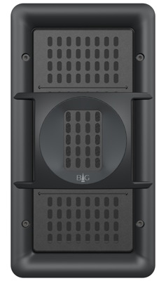

Chris is now with PS Audio and working on revisions of their forthcoming (any century now) speaker line. Current versions are using a modified version of the Neo10/Neo3 coaxial design like in the BG Z62 center channel.

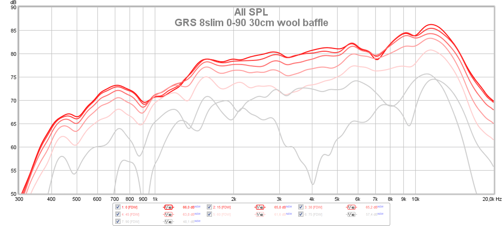

originally I wanted to use slim8 from 900Hz to 10kHz, then foster planar on top
however, distortion of slim8 was higher than I expected, not that it would sound bad or anything.
so I started raising the crossover frequency, to 1kHz, then to 1.2kHz, and it got better

Yes, the mid and tweeter are close cousins to the NEO3 and NEO10 made at a different facility. They are using different diaphragms, stronger magnets (went from N38 to N52), corrugation, damping and some phase plug/waveguide work.
We had originally looked at using Radian Audio, who is still retaining Igor Levitsky, my former colleague from BG (and who did the HiVi, SLS, Oppo and other planar drivers) but we're able to make that relationship work.
A little inside baseball - the BG diaphragms for the NEO drivers were interesting story. David Graebener tracked down many years ago. They were made by a company that made microwave inductive heaters/crisping sleeves (think hot pockets) and had a proprietary continuous line printing for simple etched aluminum circuits. They had some unique technology for super low cost. In fact, BG didn't even use their production equipment with orders of 100K diaphragms - they were made in the sample lab.
While there were some good things about that source (besides cost) - the photoresist used coats the aluminum and prevents corrosion and also had some good damping and mechanical properties. However, their printing resolution was rather low and the effective feature size/trace width couldn't be made very small and diaphragms had to be binned and rejected by resistance etc. The testing actually cost a good deal more than the diaphragms themselves. Also, the company didn't use Kapton (as it isn't food safe) and so high power tweeters weren't a possibility with them as the source (though Teonex has superior damping and midrange performance).
In our case, we're using a photo etched diaphragm with the same type of materials but we can print much finer traces and have the ultimate design flexibility to have the "keys to the castle" for future designs. It definitely took some time to get these units developed and dialed in but I have found the QC to be excellent and am excited to being them into a variety of products.

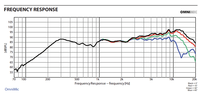

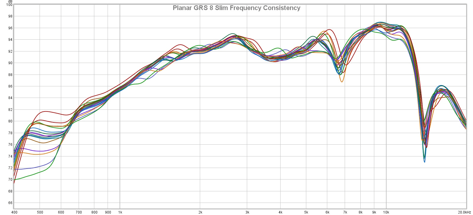

Sorry for the necrobump.................. so are PE's measurements BS? They aren't showing this huge fall off above ~12K. I'm looking at these for an OB project but I really don't want to have the same high frequency issues as my current setup. Here are PE's measurements:While I have not yet build a real speaker with my 17x of GRS Slim 8" I have gotten around to measuring them for consistency:
Distortion measurement is at ~ 2.6V so ~ 1W. I added a 18 dB highpass filter @ 800 hz.
The goal of the measurements is not to see the actual performance but rather to detect if I have any bad drivers in the bunch.

The driver number on the distortion sweep corresponds with the impedance driver number. The color, however, does not because I am lazy =)
All impedance measurements are in free air (same setup as when measuring distortion) except that for driver 1 where "with wool" means in this setup: New planar drivers at Parts Express.
Conclusion:
No truly bad drivers in the bunch, which far better than I expected. Especially considering how cheap they are. The Sounderlink drivers I've tried, which are more expensive too have nowhere close to this good consistency! They are all pretty much the same except below 600 hz where they differ somewhat. I only need 14 for my speakers so I will keep the 3 drivers the furthest from the average as spares and use the others for my speakers.
I was looking at these measurements:
A near ~20dB dip at 15kHz is def not similar. And this was across 17 units
Admittedly I have seen other measurements more in line with the official GRS measurements so maybe it's a non issue.
Depends on the amount of smoothing.
Besides, who cares about 15kHz dip when you are going to use tweeter.
You are going to use tweeter, right?
