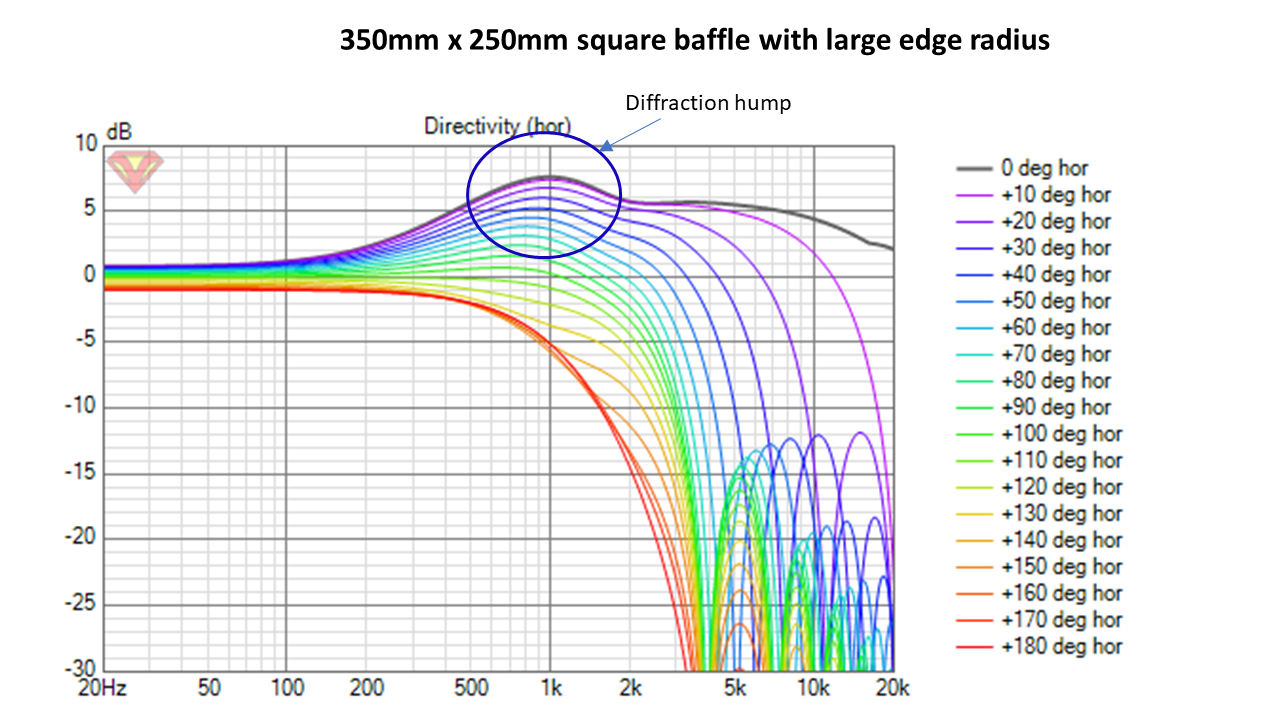

Vineethkumar – I have been following your thread with interest. I considered a waveguide, and if I did go that route, I would have used the Augerpro design. But I am staying with a flat baffle for this project.
As tmuikku said, VituixCad is a very powerful tool to do exploratory simulations, to tinker and try things out. One thing I have found is the importance of the diffraction hump (there may be a more proper name for this). When crossing from a mid to a tweeter, the size and location of this hump is important. If the crossover is within the hump region, it will be very difficult to achieve both a good on-axis and good power response… in other words, a smooth DI. A wider baffle causes the hump to be lower in frequency. In my graphic I show a 350 mm x 250 mm baffle with a 5" driver in the middle, to illustrate the hump.
j.

I strongly recommend using a dedicated midrange instead of a midwoofer like SB15CAC. High excursion is not needed and the enormous surround roll of CAC will excite IMD. Many midranges use inverted roll instead for a good reason. Mids have better efficiency too, and highpass can be adjusted based on distortion tests in the box (easy again with DSP).
3-way design should be addressed to minimize midrange IMD/Doppler and to push MT xo higher than in typical 2-ways - above baffle step and difraction range. Using 2nd order acoustic slopes we also minimize excess group delay (phase rotation) which will as well make eg. piano to sound much better, almost like a very good single fullrange speaker.
To achieve this I think a 4-5" dedicated midrange driver is the most important and critical choice of the design process. Baffle shape might come second and xo third.
