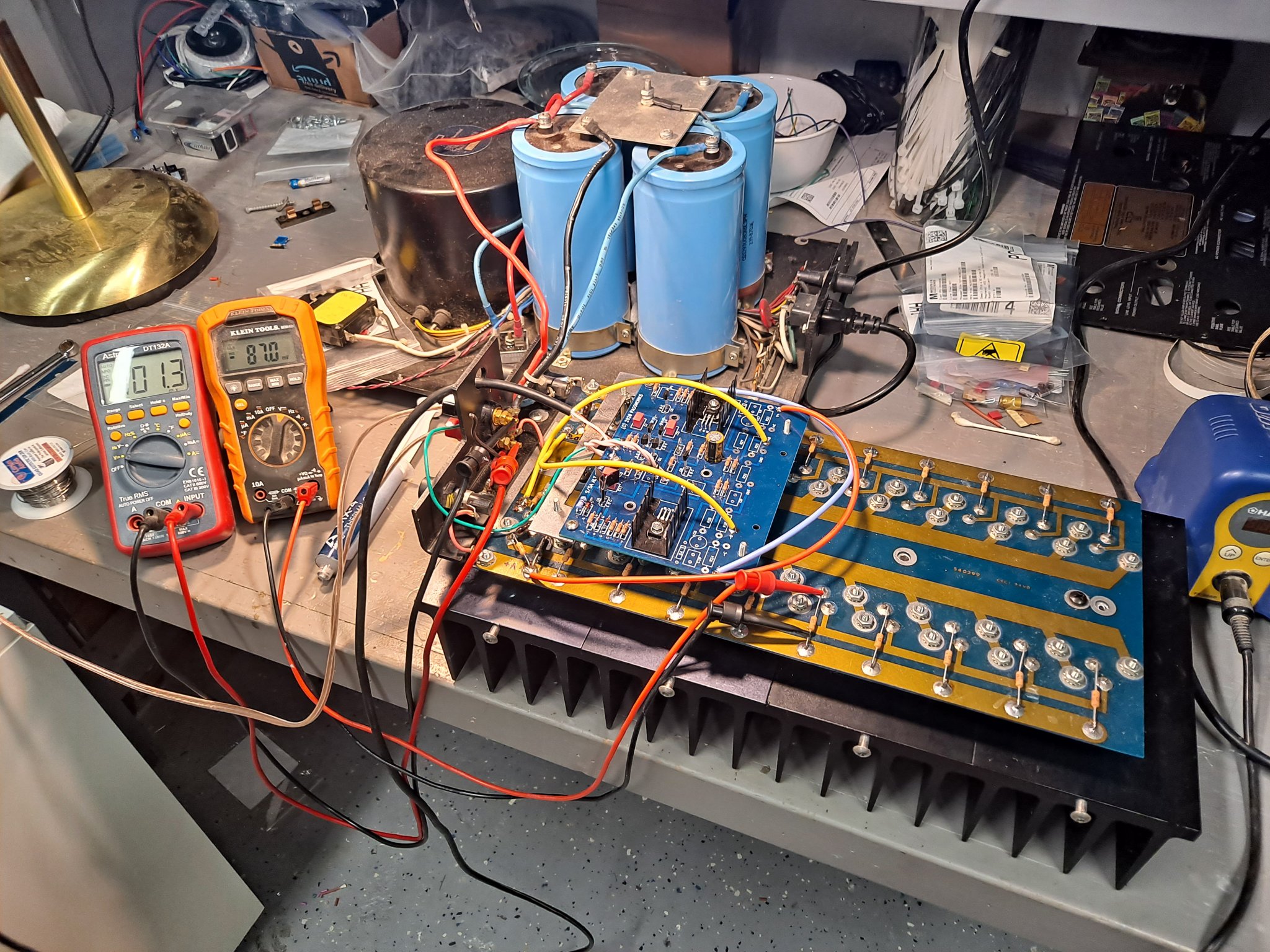

One channel is alive! I Played it for a while then a LaScala. Initial impressions are that it is dead silent sitting on the bench, no hum.

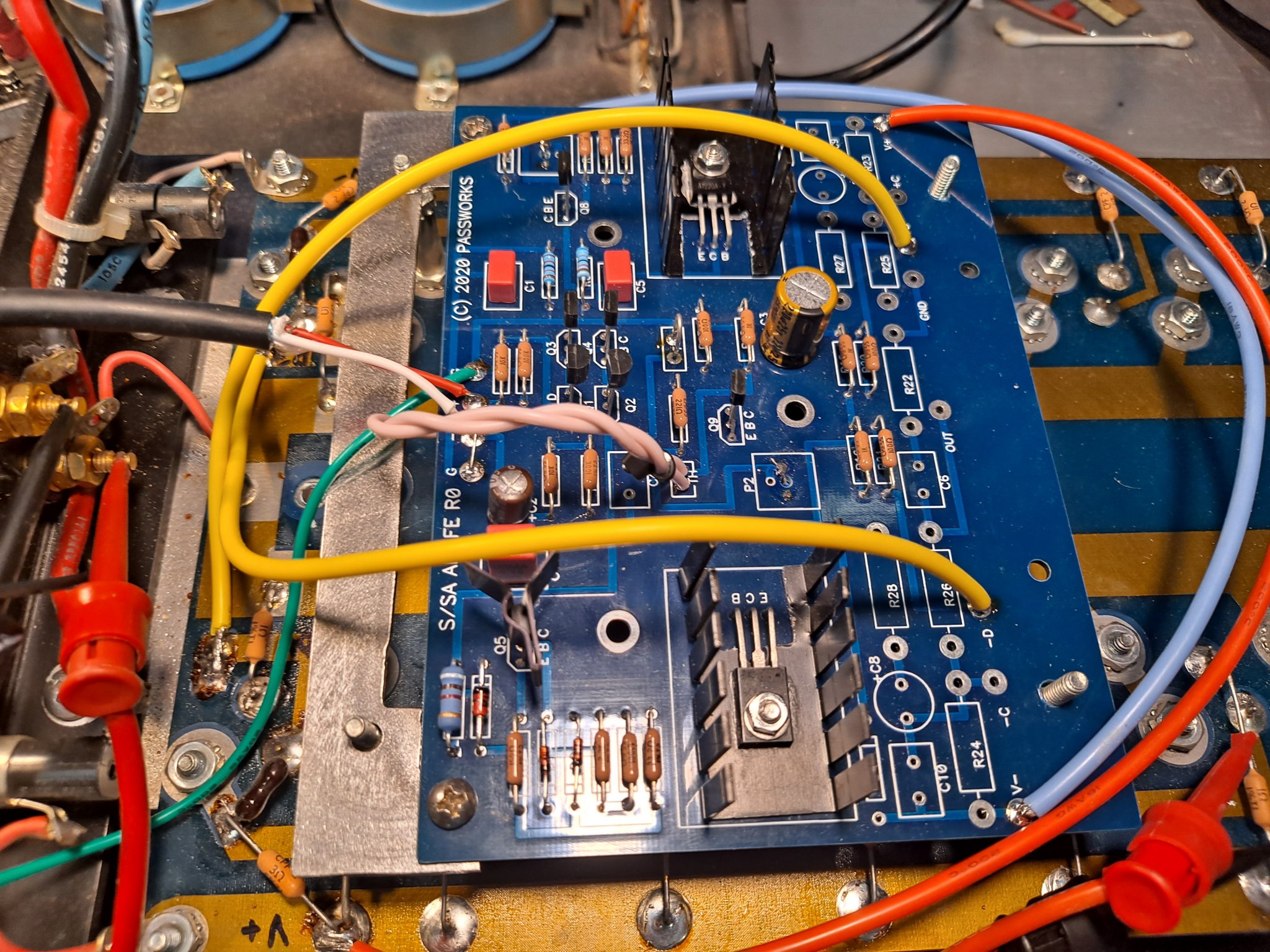

On the S/500, and I assume other Threshold amps, the mounting studs for the front end board is a longer screw that goes through a output transistor case. I moved the long screw over one transistor. The boards that I used are the Nelson Pass boards with extra holes. None of the holes are meant to fit the S/500. I had to manually drill them and also make a bracket to adapt the other side of the board. See the picture. Everything is just mocked up until I get all of the details sorted. The channels was warmed up in the vertical position raised off of the desk about an inch. First pic was just a smoke test.
I mounted the trimmer pots to the back side of the board. I don't have the delicate kungfu trimmer pot turning abilities that Master Pass harnesses... So I used side adjust multi-turn straight pin trimmers. I drilled a hole in the center of the two outer pins and soldered the middle pin to an outer noting the trace. This allows you to flip the pots one direction or the other so you can use a long screw driver to adjust from the top if the amp with the cover off.
I put a heatsink on Q5 as it got hot. Q6 and Q7 got pretty warm but not hot. I would like to source the heatsinks that are in the original post
Initial Issues to resolve:
1) I cannot get the bias low enough. I was wondering if I should raise the value of R19 to maybe ~500 ohms or change out to a 1k pot. The old front end used to start with a higher bias that would lower as the amp came to temp. With the new, the bias raises as the temperature goes up... Bias used to settle around 60-80mv accross a 1 ohm source resistor. With the new front end, with the pot at its highest resistance, I got up to 54 degrees and 125mv and rising. I bypassed the thermostat for now. I will hook it up. Not excited to drill holes in the chassis but it's a good safety measure.
2) Also, the offset isn't bad but the pot only get's it down to 40mv. I am wondering if I need to refine the matching on Q3 and Q4. or change a resistor value. I used a cheapie transistor checker as I couldn't find a way to match like you can a JFET (using Mr. Pass's perscribed method). LSK170's are from the DIYstore and on my little transistor checker, they match perfectly as to be expected. Is there anything else that should be matched on the front end?
3) Square wave isn't very square. However, I don't have a signal generator. Can I expect a topping D90 to create an accurate square wave?
4) what are the heatsinks used in post 1?

I installed a a 500ohm resistor at R19 and a 221ohm at R5. That seems to have solved the offset and Bias adjustability issues quite nicely.
I have the amp sitting in my shop (28 degrees celsius) with the amp running at about 50 degrees and 48mv bias. It sounds pretty good. I am excited to get both channels together and see what it can really do. The drivers on the front end are sitting about 55 degrees so that can come down a little bit. I will find better heatsinks. In the chassis, the temp would be higher.
I will go ahead and put the other channel together.

Okay, so I put the amp together and did some testing.
1) Cold bias starts at around 10mv-15mv and sits there. I had to put a heat gun on the heatsink outside of where the thermistor is to jump start the transistors. The bias is pretty sensitive too. Swings quite a bit when the AC comes on and moves the air around What is the reason for the thermistor? On the old front end with the optical bias, cold bias was somewhere around 90-100 and came down. With this setup, as the temperature rises, the bias goes up. So if for some reason, say the AC fails and the amp is left alone, it can overheat. I suppose the Thermal switch takes care of that. Would it make sense to use solely the pot for bias control and hook up the thermal switch? Or maybe use a PTC device for bias control? These are questions for my own learning.
2) Also, volume knob has to be pretty higher than before. I am wondering if I need to lower the value of R1. Maybe to something around 9k or 8k
3) I need to get or make a good square wave generator so I can test for ringing.
I reattached the schematic for convenience. I also edited it to account for the change on R29 to 9.8k.
I have a couple of functional tweaks that I have to do to it.
-The offset pots hit the power supply caps. On one side I can move the pot to the inside, other I will have to get creative. Maybe silicone it to the board and extend the leads into the pot.
-Maybe reroute or use longer power supply leads to get them away front the front end board. Run them between the caps rather than next to teh front end. Mostly to make it easier to get to the adjustment pots.
I will try to do a bit of a final write up and BOM in case anyone else wants to mod their S/500. So far, the amp sounds incredibly detailed. It is hard to go off of memory but I am noticing things I didn't before. Mostly in the high frequencies.
The last thing that I may want to try is to maybe purchase a lower voltage transformer and bias the amp more into class A, less A/B. I believe this one has two 152 volt secondaries that are center tapped to 76 volts. So it is sort of a dual mono. Two caps for each board, one cap for each rail.
